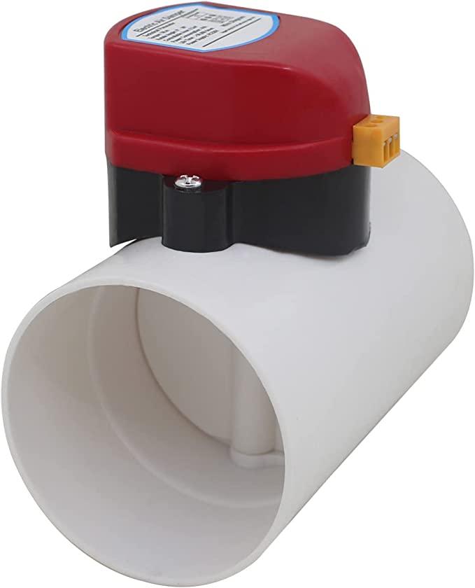

What I feel I need is a motorised damper similar to this kind of thing:
But ideally it'd be integrated into the outdoor vent as there's no access to the ductwork other than by taking down some of the ceiling.
What bothers me is how such an apparently simple thing doesn't seem to be catered for by the manufacturers of ventilation systems. Intermittent ventilation has its place besides DMEV and the like, when general airtightness is already too poor to warrant anything else.

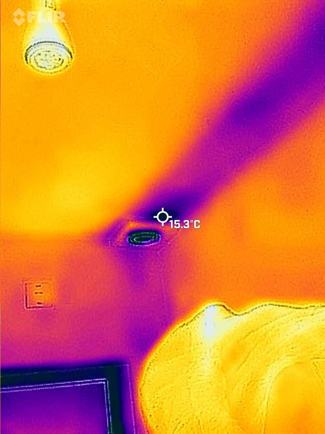

A thermal picture paints a thousand words. This is the Utility room showing the ceiling extractor in the corner and the path of the duct located in the space between joists on its way over to the extractor in the loo:

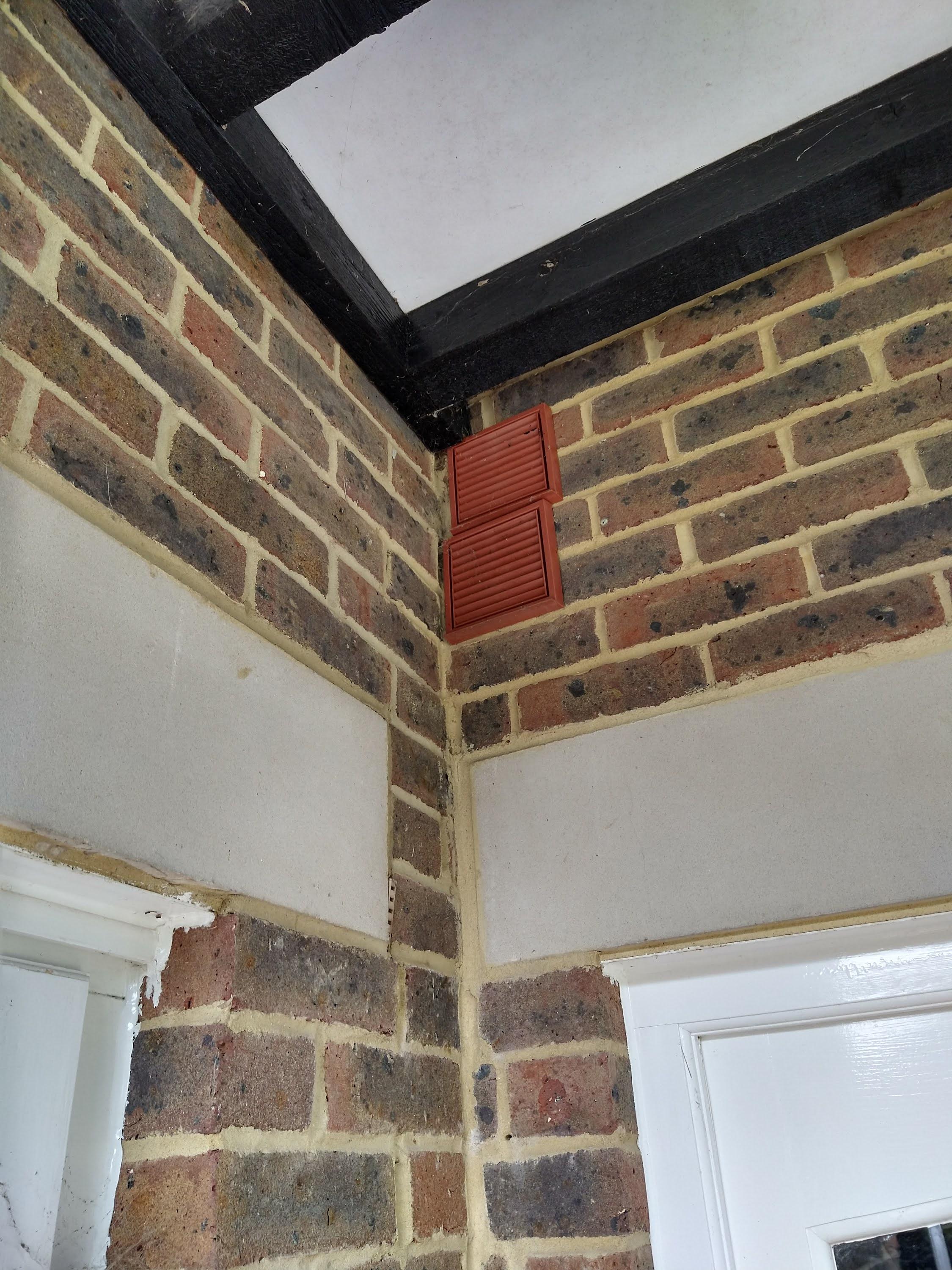

And the stacked outlets in the porch area outside:
I could try replacing them with gravity flaps but I'm not happy about the idea of them.

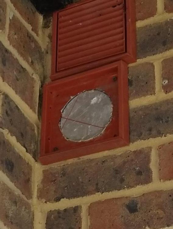

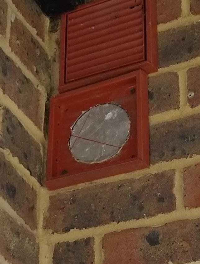

Addressing the extractor in the utility room, discussing the matter with SWMBO has resulted in an alternative solution:
100mm thick plug of rigid PIR. It transpires that the last time the extractor had significant use was probably in the latter part of the 20th century. The tumble dryer is a condensing one and in the Winter there will be a dehumidifier to assist with clothes drying. Anyway, this is an experiment that's easily reversed if it proves problematic.

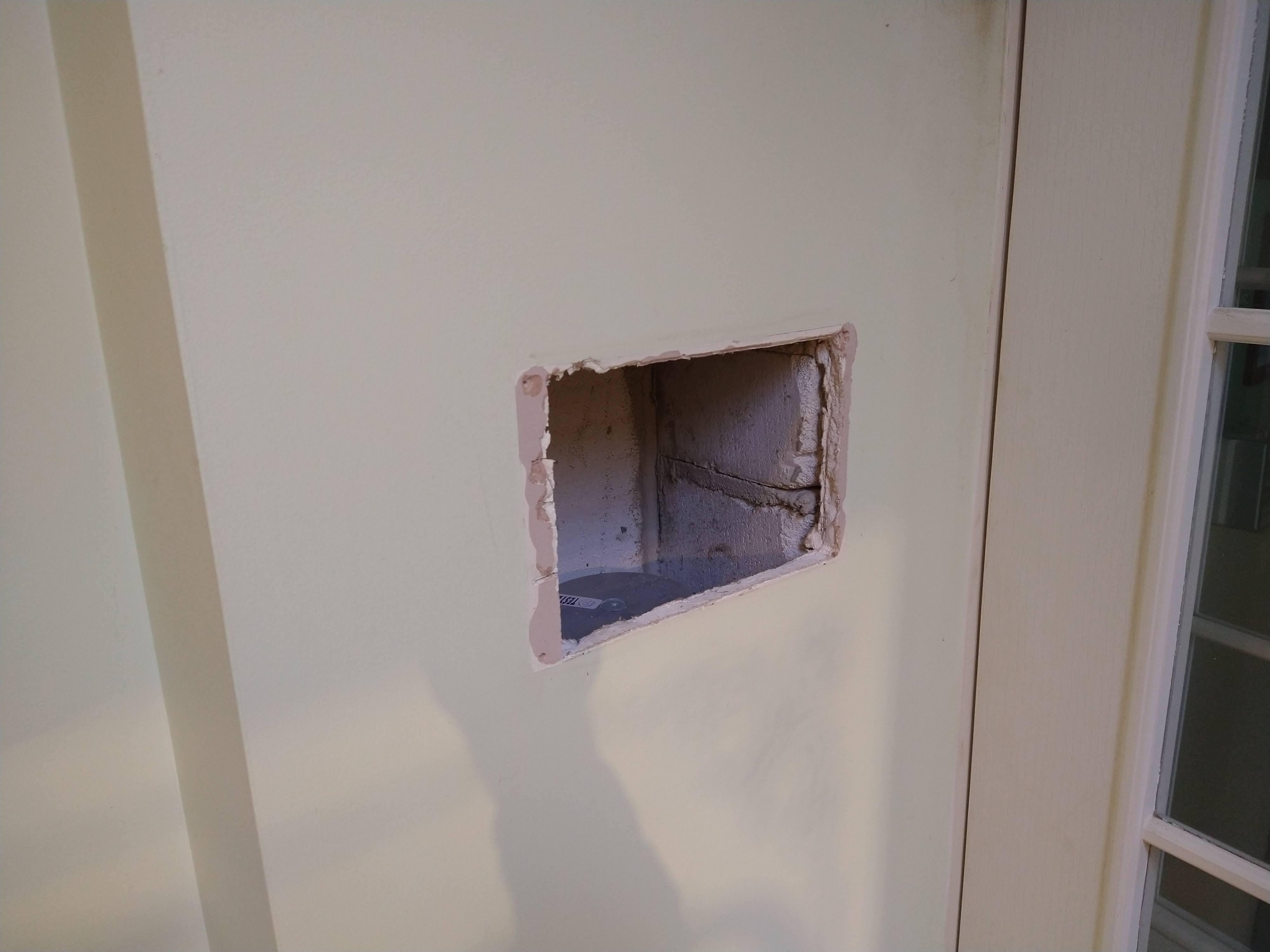

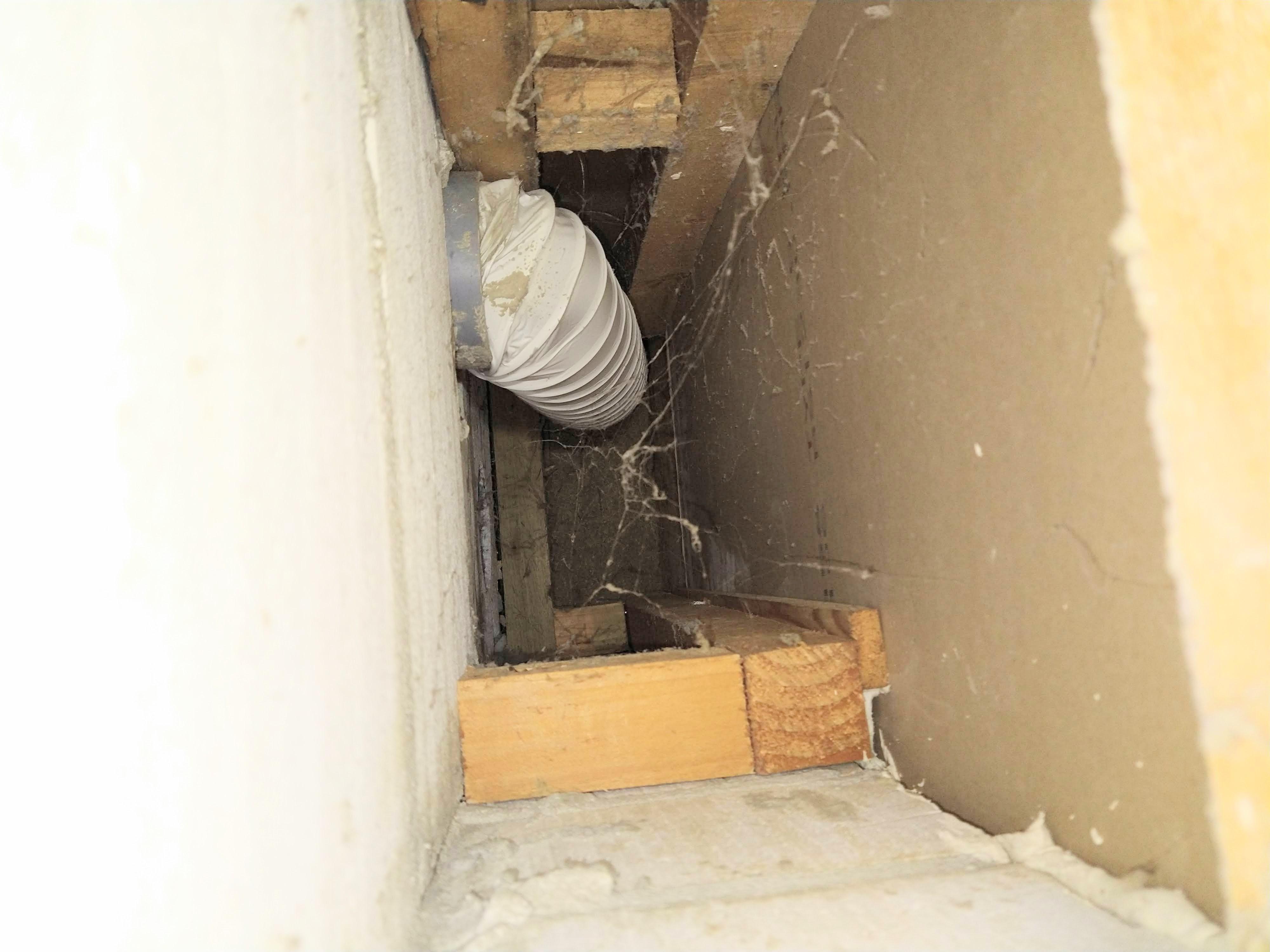

I've still not addressed the upper vent. The first cold snap will probably spur me into action. But the utility room feels much better now, a combination of gap filling around pipes to the outside wall and stuffing rockwool in and around a boxed-in AAV that also connects with the ceiling void where the extraction duct for the loo runs:
The box spans from floor to underside of upstairs floor with the AAV coming half way up to the access hole. I filled some bin liners with rockwool and pushed them in and up through the little letterbox.
Link to comment
Share on other sites
Only got that 200mm wide slot to work through - I'd have to tear down the top of the plasterboard box to get to it properly. It's only got plaster splashes on it. Admittedly it's not laid in particularly neatly but it's not my handywork.
