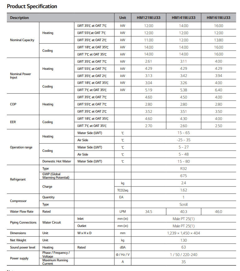

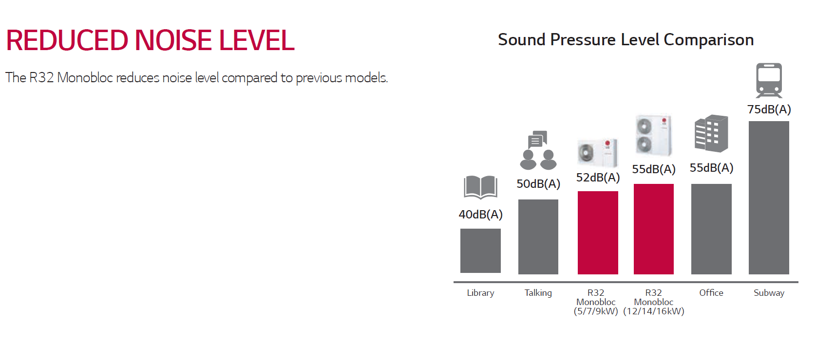

With regards to LG sound power level, see graphic from the latest datasheet from the LG website:
Yes...but the spec says something different

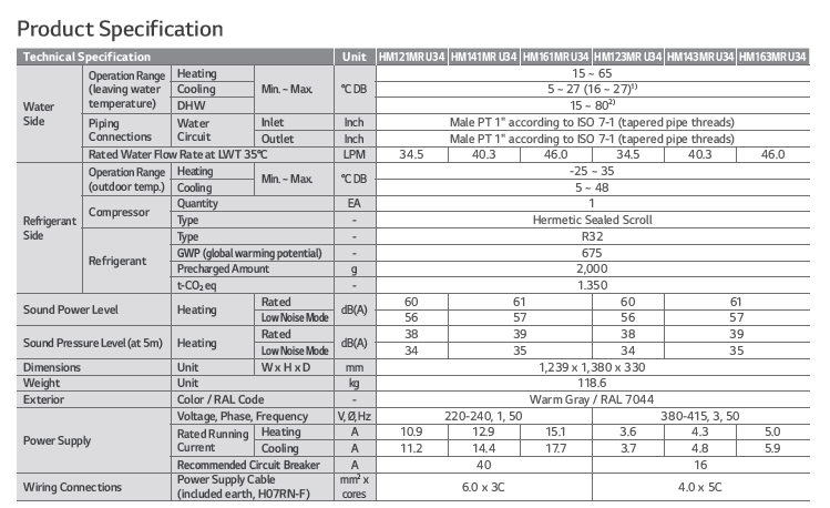

Depending on whether you look at the leaflet (which contains the graphic you posted) https://www.lg.com/gr/download/resources/CT32004443/CT32004443_1641.pdf
or the 'Product Catalogue' (which I downloaded a while ago but now cant find online)
LG speak with forked tongue.
Yes it's somewhat confusing. Sound Power Level, also denoted by PWL, is different from Sound Pressure Level. Sound Power Level is the absolute level of sound power that an object radiates in all directions, i.e. the sound power GENERATED, in watts and decibels, whereas Sound Pressure Level is what is received by either the human ear or a measuring device such as a decibel meter. The LG is quoted at a sound power level of 63dB but I can't see a Sound Pressure Level quoted. The Ecodan is quoted as having a Sound Power Level of 60dB and a Sound Pressure Level of 47dB at one meter. This is for average temps, at which all the latest brands/models run at similar very quiet levels. That changes significantly when temps drop to a few degC and below - the fan and machinery work harder and get louder. I measured mine's Sound Pressure Level last year from an open window just under one meter to the right of the unit and got 53dB at 9degC, rising to 63dB at 4degC and 71dB at 0degC
