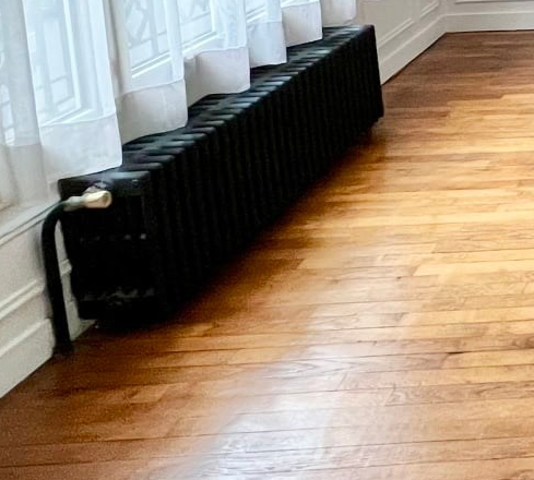

Garald Posted September 14, 2022 Author Posted September 14, 2022 That's really not very much. That's one very tall radiator (a bit over 1000W at low temperature). Maybe I should put two radiators like that, on opposite sides of the long inside wall. Does that make sense?
