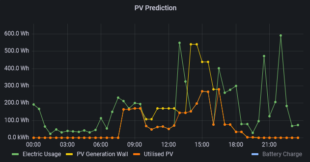

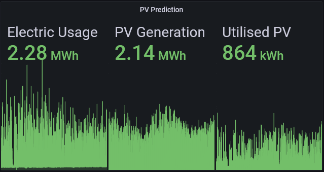

Now I have all the data, there's a few options on what to do with it. Firstly, Grafana was used to support detailed interrogation of the data as well as an in-built method for summing timeseries data. Below pictures are for a 3kW system mounted vertically on a ~SSE facing house wall:
Annual utilised PV is just the min of usage/generation for each hour in the time series. The result is... disappointing, suggesting if I'd had this system installed over the last year I'd only have used 40% of the generated power. As with most houses, the culprit is significant evening usage - computers, TVs, dishwasher etc. I can shift some of the usage to mid day, but not enough to make a significant enough impact. Inspecting a random day (6th September) confirms an increase in PV size would not solve the problem either:
Area on this graph is kWh so it's easy to see a lot of wasted generation mid day (between the blue and orange lines) followed by significant grid usage in the evening (between the green and blue lines). Note that electicity consumption is quite low as my heating and hot water is from mains gas. Ideally this excess could be dumped into a hot water tank but we have a combi boiler and I'm struggling to make the sums add up once you factor in even more initial investment for a tank etc. Therefore I'm ignoring offsetting gas consumption and purely looking at the significantly more expensive unit rate electricity consumption.
Oh, so what happens when you put on the kettle and the oven at the same time? Your PV clips out at 3kW so you're not necessarily seeing full utilisation even though the half-hour averages make it seem like you are.
This is one of a number of limitations of the abstracted model which I'm ignoring completely and crossing fingers that the summed effect isn't significant. The data is simply not available at a high enough fidelity to model such events. Another is averaging PV output data, which not insignificantly undermines the battery simulation accuracy as the battery has a min/max which causes clipping.

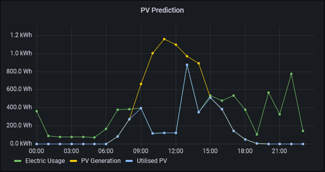

I revisited this as the PV data can be interpolated to 30m values to see what the impact of improved fidelity was. Around 5% reduction in utilised PV by moving from 1h windows to 30m windows. This trend would continue as the fidelity increases, so there's probably at least another 5% reduction in utilised PV missed by this model.
Much more significant is the error introduced by averaging PV data. If I instead take only the 2020 timeseries utilised PV drops by around 23%. It's intuitive as to why, I was smoothing out daily irregularity by taking an average, which has a big impact on utilisation if we look at the same day as my original image:
Poor midday sun causing a large draw from the grid. This helps support a case for batteries; even when shifting load to mid day you might just get unlucky with PV generation, I don't want to have to predict the cloud patterns before setting off the dishwasher.

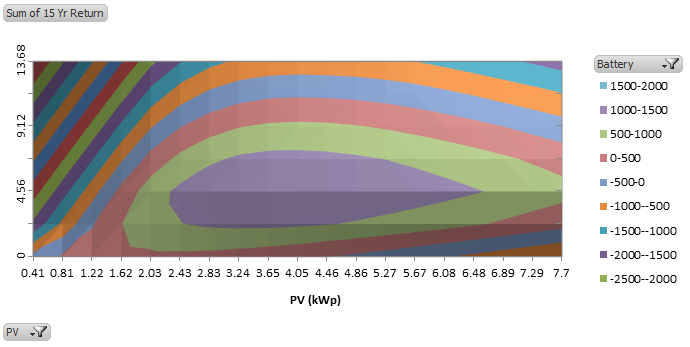

So with batteries having a few advantages, including offsetting the much higher electricity cost over gas, I went down the route of optimising such a system. With higher PV generation a pre-combi tank could be added as well, but I am space limited on the number of panels I can install. Some rough equipment/install cost estimates (Not MCS) and 133 data points later gives me the following optimisation space:
Ignore Excel's bizarre labelling, y-axis is Battery (kWh). The optimal value being around 3.65kWp PV with a 4.56kWh battery. Adding a tank to this system would only save ~£79 a year so fairly hard to justify the extra expense. Does anyone have reference quotes for a similar system to double check my cost functions?
