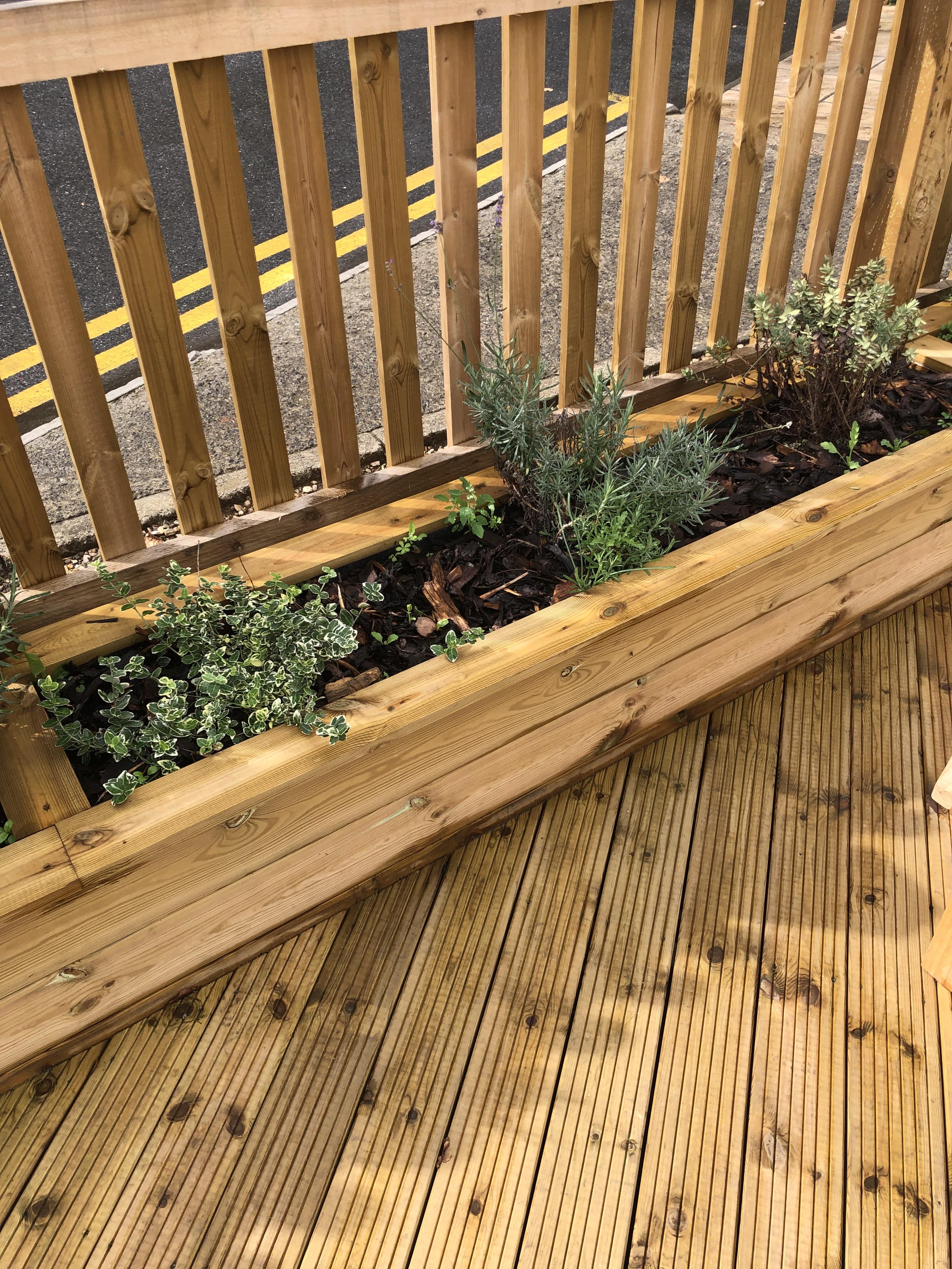

1 minute ago, pocster said:
Base of it just slatted timber ?
What I tend to do is line it with black plastic, drill some 50mm holes in the wood, puncture the plastic lining in the middle of this hole, put a piece of old crock over the hole to stop soil escaping, this keeps the water away from the wood as much as possible. Another choice of wood is from old pallets, not sure what “breed” the wood is but lasts ages outside and great for making compost heaps.
