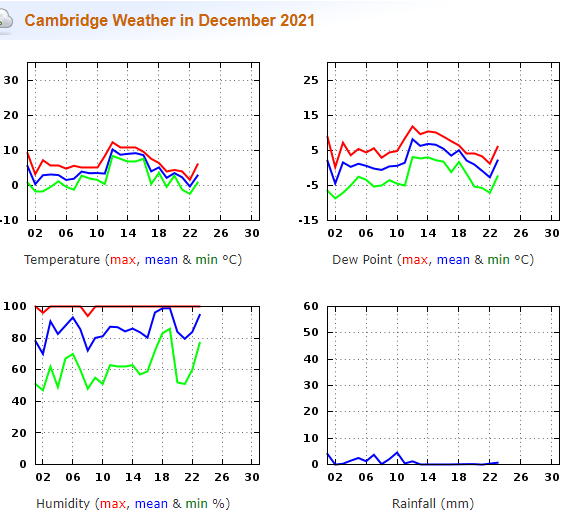

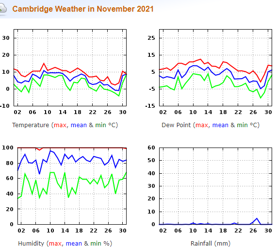

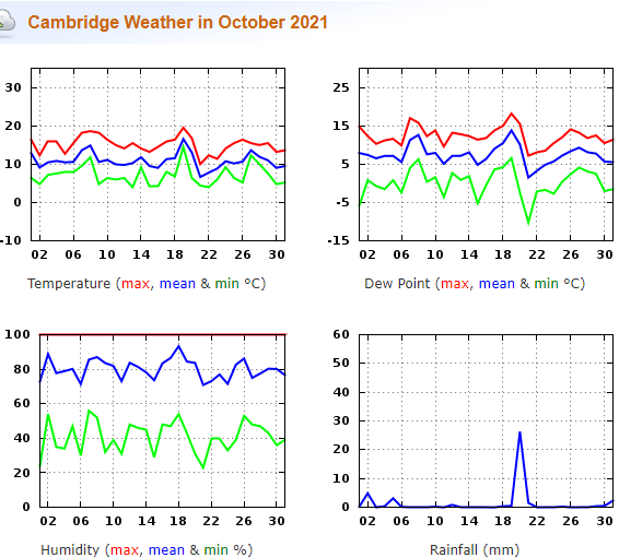

MortarThePoint Posted September 2, 2022 Posted September 2, 2022 (edited) I'm going with wet plaster to (Stranlite/Fibolite) blockwork and skim on plasterboard partitions. I was wondering when it would be OK to have this done. I'm still going through first fix, slowed by every full plasterboard needing the wife's help as well of shear weight of activities. My layman's understanding: I had hoped to have it plastered in September when the weather should be mild enough to not dry the walls too quickly but dry enough to be able to use fans to blow air though and avoid the fabric of the building getting too wet. That's slipped away and the plasterer says he's available end of Oct / early Nov. Below is some weather data from last year. I guess the most important things are temperature and humidity/dewpoint. https://www.cl.cam.ac.uk/research/dtg/weather/index-period-graph.html Edited September 2, 2022 by MortarThePoint
