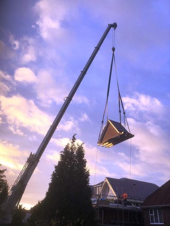

Charles t Posted September 2, 2022 Share Posted September 2, 2022 Looking to explore how best to put a second storey on our 100m2 bungalow particularly modular or timber frame kits which minimise disruption. Happy to share experience with others as we progress we have done 2 storey brick extensions and other projects before so knowledgeable in planning and organising but know we have much to learn Link to comment Share on other sites More sharing options...
JohnMo Posted September 2, 2022 Share Posted September 2, 2022 I would discuss with a structural engineer first. You need to ensure the existing building and foundation are suitable for the additional weight. Link to comment Share on other sites More sharing options...
Ferdinand Posted September 2, 2022 Share Posted September 2, 2022 2 hours ago, Charles t said: Looking to explore how best to put a second storey on our 100m2 bungalow particularly modular or timber frame kits which minimise disruption. Happy to share experience with others as we progress we have done 2 storey brick extensions and other projects before so knowledgeable in planning and organising but know we have much to learn When I was visiting @jack in 2018 I took these piccies of a company installing modular lofts on a series of houses on his road. There is the name and phone no of the specialist company in one of the piccies. How have they weathered, @Jack? My hint is that you can consider gabled upper stories as well as normal roofs, which give much more space. Mine has one front to back down one side which is gable-gable, then one with sloping roofs and roof windows at rights angles to it. So I have 2 big doubles (one very big like 10ft x 16ft), a single, and a family bathroom upstairs. Ferdinand --------------------------- Bonus piccie: Link to comment Share on other sites More sharing options...
