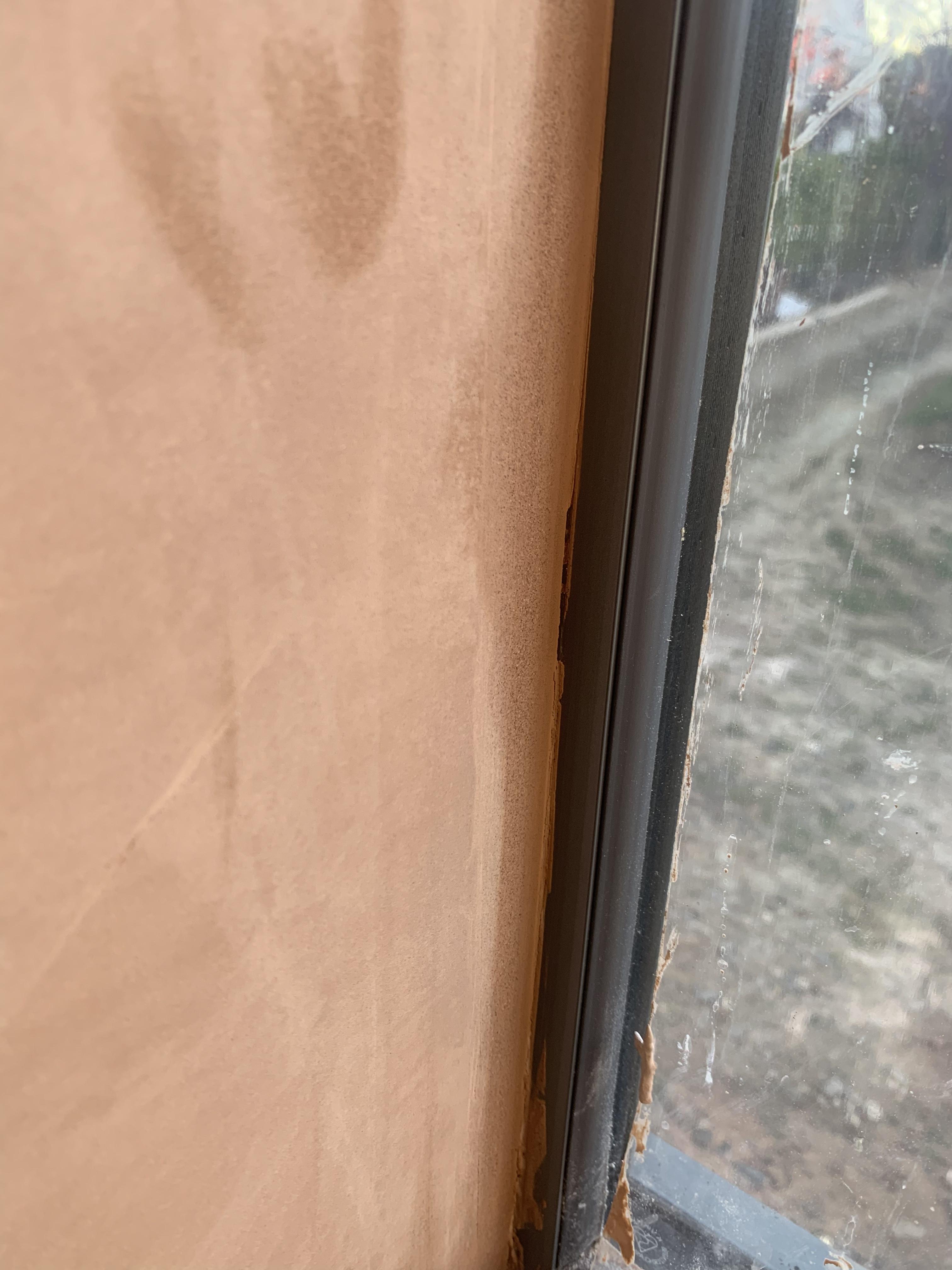

James94 Posted August 11, 2022 Author Share Posted August 11, 2022 Can anyone offer any advice for a newbie spraying a house? also best way to achieve straight lines around reveals as I don’t think what I’ve been left with will look very good after spraying. As you can see on photo, would you take plaster back a little and caulk for straight lines. James Link to comment Share on other sites More sharing options...

Nickfromwales Posted August 12, 2022 Share Posted August 12, 2022 Loads of vids of what to do / how to thin paint and types etc Take a huge amount of time to mask up around windows and doors etc, as cleaning off overspray will take 10x longer Short cuts always take 3x longer or more, so mask and spray in a controlled fashion for an easy life. If you don't put in the effort with masking, you'd be far better off with a roller. Follow the guidelines for cleaning and stowing the machine after each use, religiously. Your idea to use dead spaces for practice is a robust plan. If spraying in this weather it'll dry as you're putting it on, so will be a much bigger challenge to get a good result. Possibly spray early mornings only, and not after midday. Link to comment Share on other sites More sharing options...

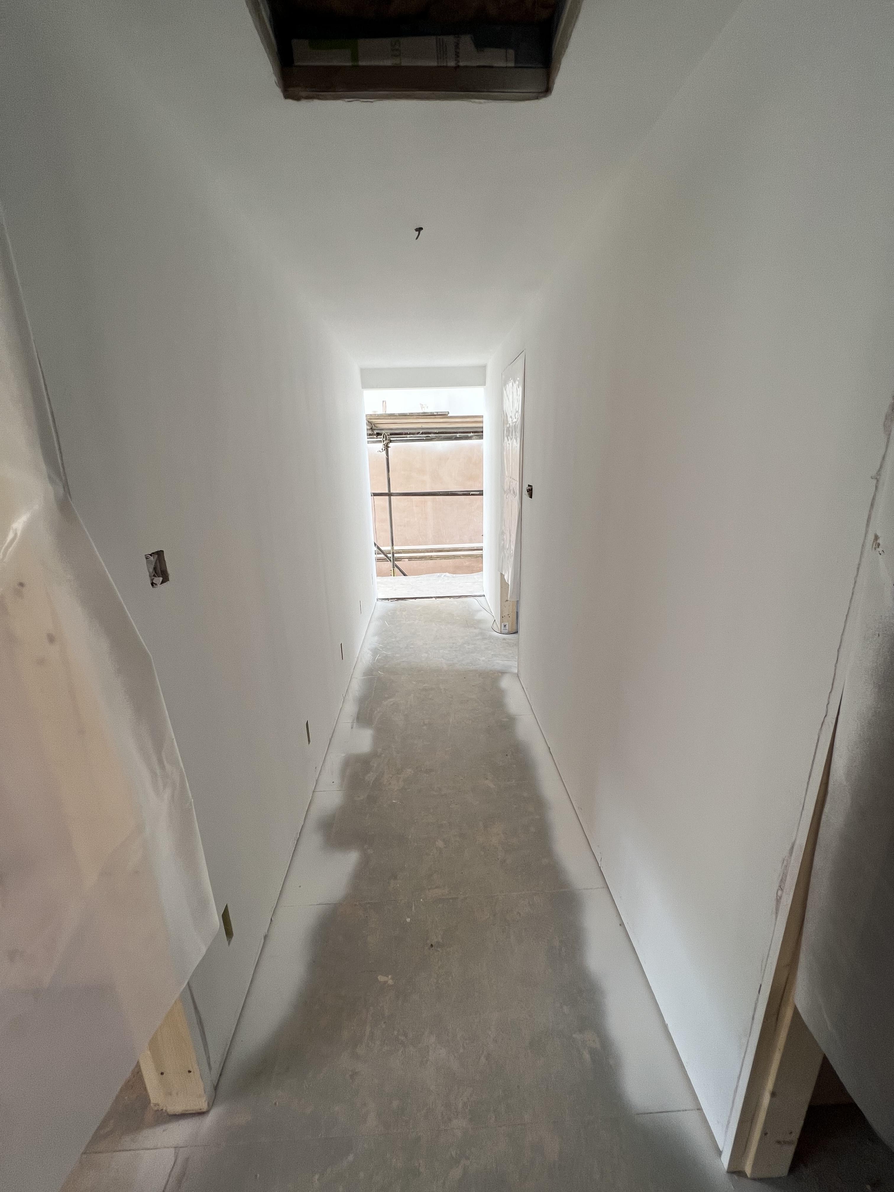

James94 Posted August 18, 2022 Author Share Posted August 18, 2022 @NewToAllOfThis @Nickfromwales Sorry for the late response but been busy, thanks for the great advice and video. I have been watching a few videos on Techniques for applying but I think getting it right will come with practise. I’ve applied a mist coat to the upstairs and a second to a cupboard and the vaulted ceiling. The cupboard was for practise with neat paint, I found that I needed to up the pressure to 3 for it to run ok. The vaulted ceiling had its second coat so we could fit the chandelier and remove internal scaffolding to enable floor prep for UFH/screed. There are a few lines in the mist coat from not getting the overlapping correct(faint plaster showing) but this seems to be hidden with the second coat. I did get a price for £700-800 for someone to come and spray it over a weekend, that was me doing all the sanding/filling/masking and buying the paint. Which would have taken more of my time away from prepping ground floor for screed. So decided to do it myself and now I’m glad I did. Link to comment Share on other sites More sharing options...
