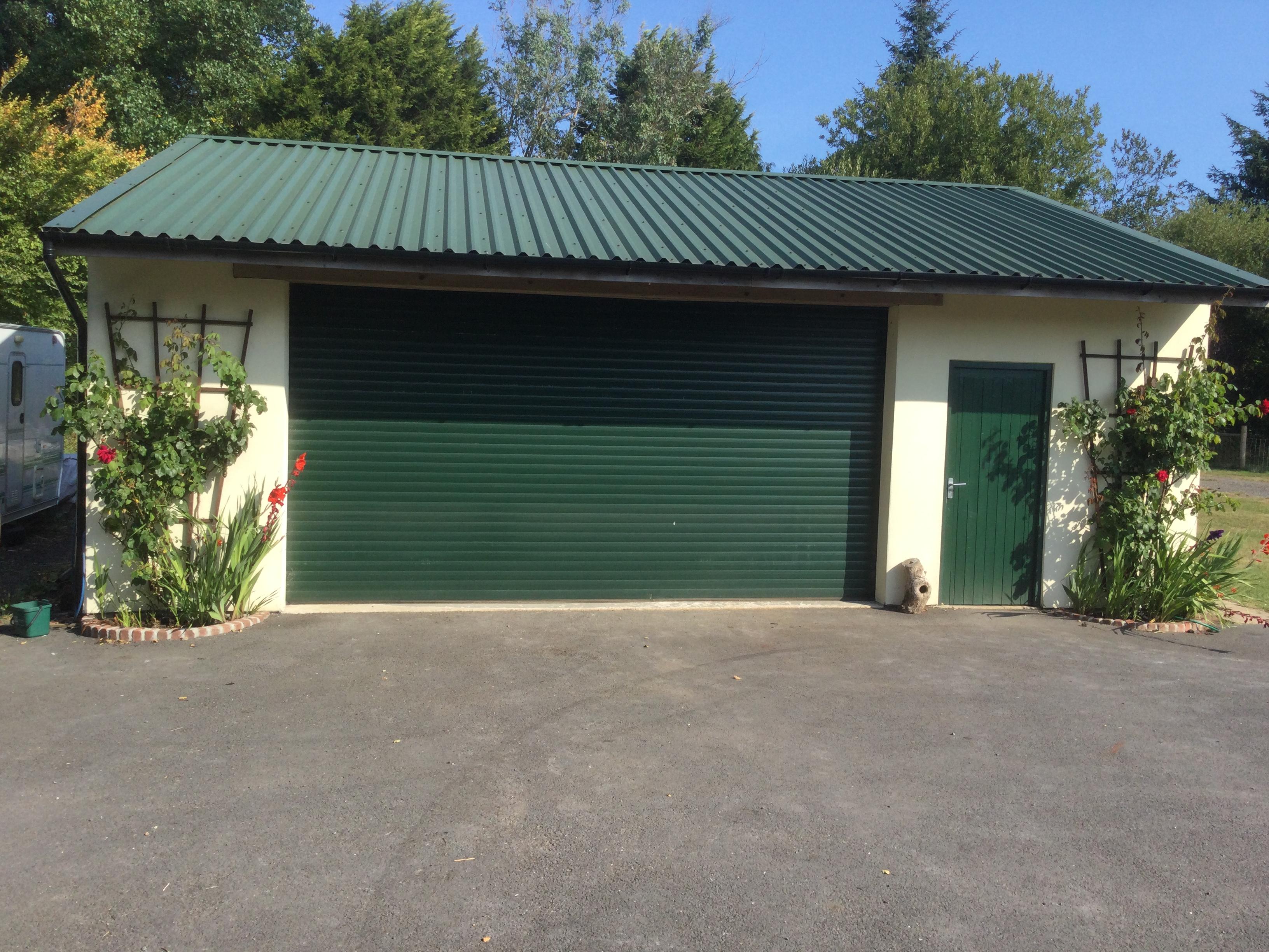

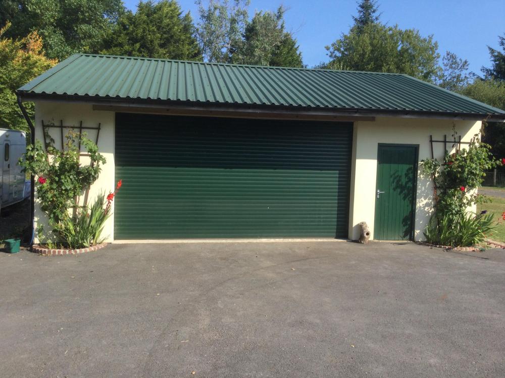

joe90 Posted August 13, 2022 Share Posted August 13, 2022 My workshop roof is steel sheet but on pre made wood roof trusses. I was worried about condensation but used breathable roofing felt below battens and had no condensation issues at all. Yes it will be cold so why the cavity?, mine is single block (rendered) with pillars. Mine is also under PD. (I think 12’ might not work with roofing felt 🤔) Link to comment Share on other sites More sharing options...
