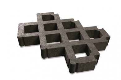

Ferdinand Posted June 6, 2017 Author Posted June 6, 2017 I am going with a 30% perforated brick wall, topped with cut roof tiles and a red brick diamond. Height will be about 10 courses. ie: stretcher bond but with 75mm 30% gaps. I'll post a piccie somewhere when done. One option I explored but did not pursue which I think would work, and be both interesting and less expensive than Sreenwall, was to use permeable paving such as Turfstone or Truckpave as a low wall. Others may want to consider that in future. Material costs approx: 1 - Screenwall = £50 per sqm (may get some discount) 2 - 1/3 overlapping blue engineering bricks = £20 per sqm. 3 - Permeable Paving matrix as wall = £30-40 per sqm. Potential problems buying in small quantity. Use for groundworks and build a decorative wall from what is left over. eg Truckpave: 600x400x80mm sections. Weigh <10kg each. Made from recycled plastic so may well bounce. http://www.terram.com/products/porous-plastic-pavers/truckpave-porous-paving.html Turfstone Made from concrete. 600x400x85mm. http://unilock.com/products/driveways/turfstone/?region=2 Ferdinand
