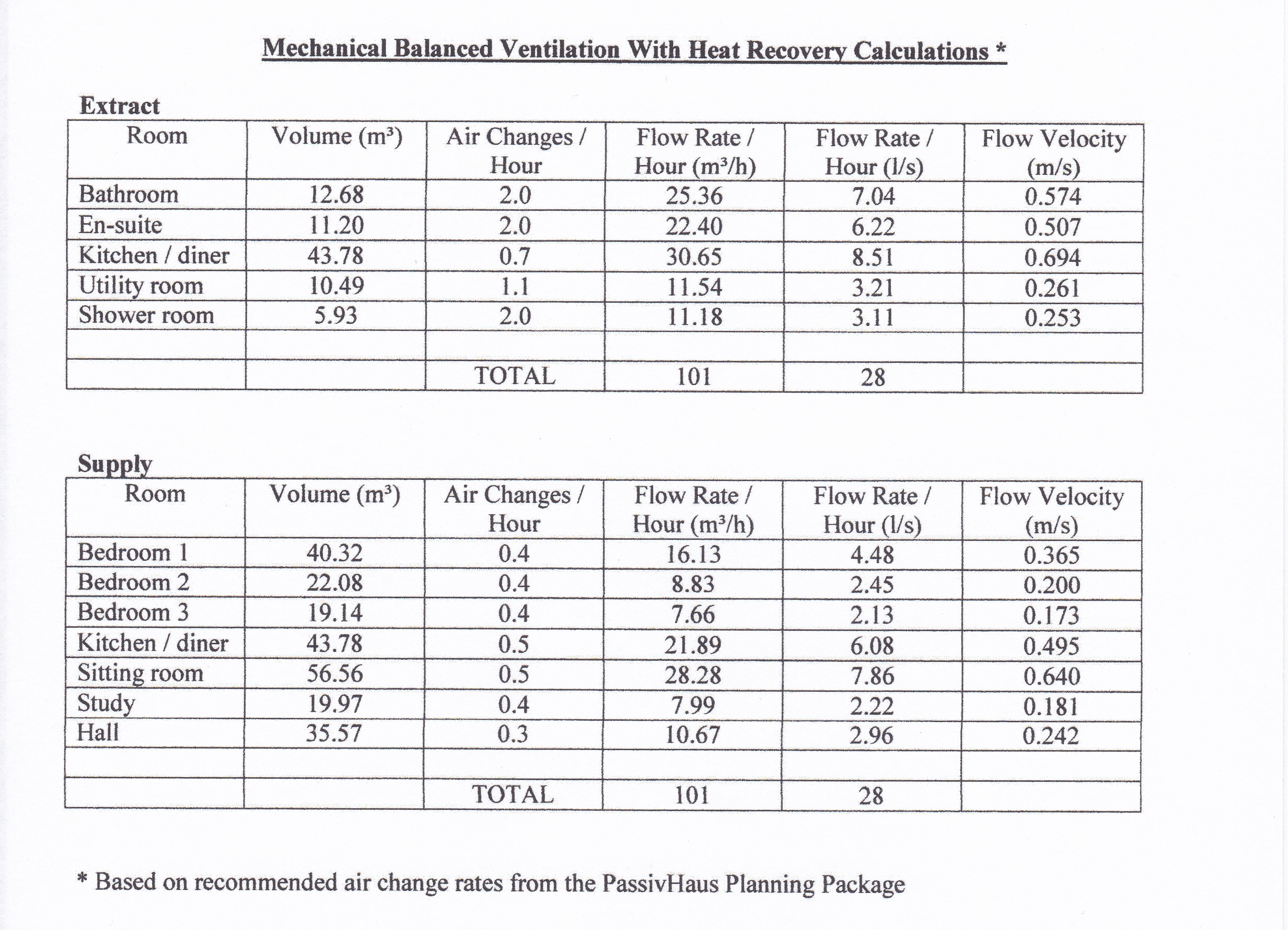

Gone West Posted August 1, 2022 Posted August 1, 2022 This is the table I calculated back in 2010 for my PH build. I can't remember much about how I did it but I commissioned the setup myself using a Testo 405i and the BCO wasn't interested in any aspect of the system. 1

tuftythesquirrel Posted August 1, 2022 Posted August 1, 2022 On 01/08/2022 at 15:41, Gone West said: This is the table I calculated back in 2010 for my PH build. I can't remember much about how I did it but I commissioned the setup myself using a Testo 405i and the BCO wasn't interested in any aspect of the system. Expand Ahh. good to know I get away with virtually anything, but I just need to get it straight in my own mind. The above suggests you needed 100m3/h, so what size unit did you fit and do you run at 0.4 ACH on a day to day setting or lower and boost when required? Thanks.

Gone West Posted August 1, 2022 Posted August 1, 2022 On 01/08/2022 at 16:29, tuftythesquirrel said: Ahh. good to know I get away with virtually anything, but I just need to get it straight in my own mind. The above suggests you needed 100m3/h, so what size unit did you fit and do you run at 0.4 ACH on a day to day setting or lower and boost when required? Thanks. Expand We used a compact unit which was a Genvex Combi 185LS. It's a combined MVHR, hot water cylinder and EASHP. IIRC, we've since moved house, I set the fan levels at around 30% and we never changed that. We never used boost and we didn't have any condensation in the kitchen or bathrooms. 1
