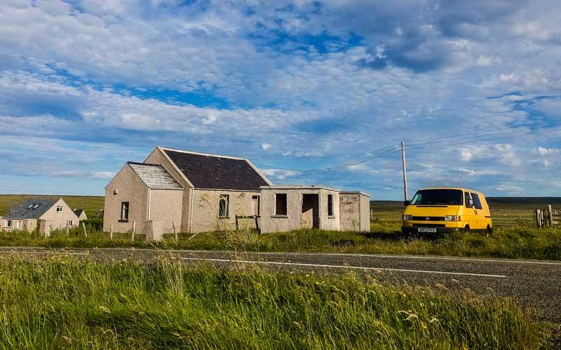

Chris HB Posted July 18, 2022 Share Posted July 18, 2022 I’m renovating a small mission hall on the Isle of Lewis in the Outer Hebrides. Due to it’s already small internal size (7.500 x 4.500), I was thinking of looking at external insulation rather than internal? Its a solid wall construction (approx 500mm+) currently with an external pebbledash finisish. Any thoughts or recomendations? Link to comment Share on other sites More sharing options...

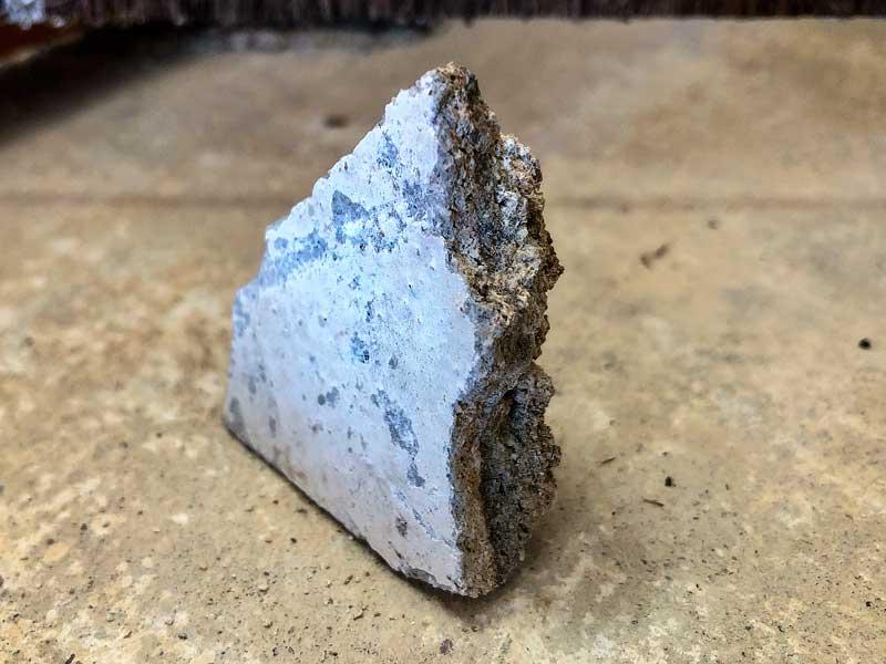

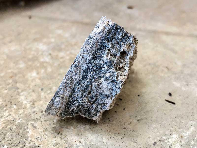

Gus Potter Posted July 20, 2022 Share Posted July 20, 2022 Hi @Chris HB That sounds great. My Sister lives on Tiree. Questions.. What kind of stone do you have. Is it granite / imported stone from the mainland or local stone off the beach? What are the walls founded on? sand or rock? Wall construction? Have you exposed what is under the roughcast? Is the outer leaf dressed but just weathered hence the render? inner core of random rubble and rough stone on the inside? What is the roof made of, construction and how does it sit on the walls? Lastly don't go hacking off the render before you have fully understood how the walls / their bearing (hesitant to say founds) are constructed and their condition. Post more if you can.. photos would be great and anything else you can think of. 1 Link to comment Share on other sites More sharing options...

Chris HB Posted July 25, 2022 Author Share Posted July 25, 2022 OK, I’ll upload some more pics in due course… I don’t know all the answers to your questions @Gus Potter and @saveasteading but so far this is what I have discovered… It was community built, date TBC, but could be around late 1930’s, but have heard other earlier dates mentiond as well? Pebble dash exterior, slate roof over main hall, composite tiles over the front small entrance porch. I have glimpsed timber sarking boards in the roof through a loft hatch, but not had chance to get in the roof space currently. Raised tie roof construction. From what I can see/tell, it is a solid wall construction from local stone (assumed). Where I have exposed a couple of areas, it seems to have been internally rendered with a hard white coloured render (see sample chunks) which I’m thinking is more likely to be an early concrete rather than a lime render? It has subsequently had a basic timber frame and plasterboard finish later on at some point fitted over this fixed to the wall. Suspended timber floor/wooden joists, unsure as yet what they are resting on. Boards all mostly good. PS; yes it includes its very own disused bus shelter at the side of the building too! 😂 Link to comment Share on other sites More sharing options...

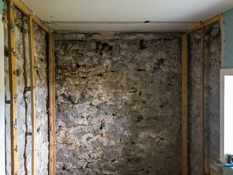

saveasteading Posted July 25, 2022 Share Posted July 25, 2022 1 hour ago, Chris HB said: how you approached damp with your solid walls? Haven't done it yet, but start in the next week or so. Fundamentally we are using the properties of the wall. It is made of inner and outer granite masonry and a central core of rubble and mortar. Very little dampness gets through all that, according to numerous studies. The little damp that inevitably exists can be dealt with by 3 methods. 1. waterproof the inside face...not a good idea because it will come off in time. 2. build inner insulated wall with a cavity, and ventilate it. This is a common solution, but in my opinion, defeats the insulating benefit of the thick wall. 3. ditto but not ventilated. There will always be some ventilation through the wall anyway, especially along the core.. The bottom metre is the only part which has significant damp so we are tanking that, and allowing the rest to breathe. (I borrowed this from another project which had a blog. Also it fits with technical info on tested buildings. come back if this works for you, but await other comments that number 2 is the only way. Our steading has similarities. Although it is big, the individual wings are narrow, so we had the same concerns about losing room width. We have dug out the floors (the ground is sand) and will put in 125mm of PIR. Walls we are thinking 50mm PIR and 50mm rockwool. attic spaces Fibreglass quilt. Exposed roof tried some PIR, and now changing to cavity batt. Insulation levels will exceed new-build requirements. You urgently need to know the wall construction. I am anticipating the end extension is modern and block. 1 Link to comment Share on other sites More sharing options...
Chris HB Posted July 25, 2022 Author Share Posted July 25, 2022 40 minutes ago, saveasteading said: You urgently need to know the wall construction. I am anticipating the end extension is modern and block. it seems to be the same thickness, so I was assuming the same construction, but I’m sure I’ll find an area where I can check… I like the idea of just a line render or earth plaster to just allow the wall breathe as that’s how the wall would become dry over time? I could live with that. I’m not sure how you’d get the U values for a stone wall or if on their own they’d meet current standards? I’d prefer to have them exposed internally, but not sure that’s a permissible option? Link to comment Share on other sites More sharing options...
saveasteading Posted July 25, 2022 Share Posted July 25, 2022 3 hours ago, Chris HB said: if on their own they’d meet current standards? Not by a very long way. Scottish standards for a conversion ask for 'reasonable efforts'. So perhaps you can convince them that the floor area is crucial, and that a U value of 0.6 in the walls is ok because you will have stunning insulation to floor and roof, etc Also for a floor area of under 50m2 some rules are less strict but I have not read in detail. Conversions - in the case of conversions, as specified in regulation 4, the building as converted shall meet the requirements of this standard in so far as is reasonably practicable, and in no case be worse than before the conversion (regulation 12, schedule 6). 1 Link to comment Share on other sites More sharing options...

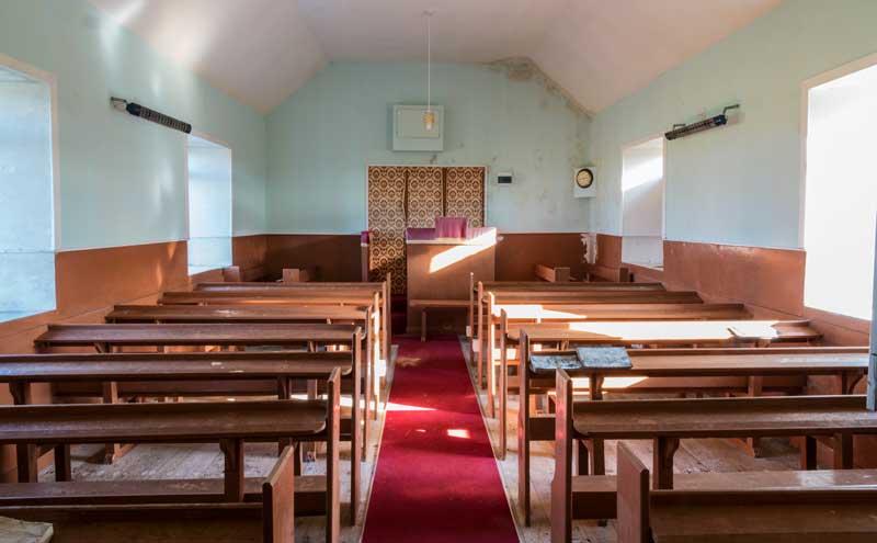

Gus Potter Posted July 26, 2022 Share Posted July 26, 2022 10 hours ago, Chris HB said: Yep, when you only have 35 sqm to play with, every little bit really does count! Hi Chris. Had a look at the photo's.. what a great project.. many challenges but the main thing is to enjoy the journey as well as the end result. Just to touch on some basics.. you may have got a handle on this already. What about things like drainage.. septic tank soak away or biodigester. Get stuck into the ground and find out what you have under the top soil. Don't quite know your exact location so have not had a look at this end but some places have deep peat (or really soft sands) interspersed with granite dykes (called igneous intrusions).. great for building on but really hard to excavate for modern sewage tanks to achieve ground porosity for soakways. Have a look about the island and ask about. Local knowledge coupled with some basic research should give you clues here. See link below. https://mapapps.bgs.ac.uk/geologyofbritain/home.html The photos of the internal render are interesting. Hard to tell from the photos but do you think they have a bitumen content.. like an early attempt at waterproofing.. like mastic asphalt? You may actually be still able to smell "oil / hydro carbons" when freshy split or put the sample in a bit of petrol and see what dissolves. Don't taste it.. stick to the whisky. I would really try and find out more about the walls, the founds, there may just be a partially failed damp course! .. could be a slate / pitch (tar) one. Also what is under the floor.. are there any solum vents? may be hidden but look closely. In the 1930's things construction methods were changing fast and costs were getting driven down so don't assume that just because it is a mission hall it will be more traditional and that it is dressed stone outer layer / random rubble with a rough stone inner skin. In fact if it was a mission hall they would have maybe aimed to get the cheepest building on the market at the time so they could spend their money on the "mission" thus this could be an ideal case where you may find that innovation has occured. Do research here on the original intended use and who paid for it to get built. You may find this in the deads.. but that is cheating! You may just be able to squeeze a quazi mezzanine / gallery up there but post a dimensioned cross section. It will need a bit of design flair and an understanding of the regs etc but don't rule it out for now. Lastly what about these out buildings.. any chance of doing something with these? Could you link them to the house? If done sympathetically you just may be able to incorperate this into the habitable space with a link concept at some stage. Is any part listed grade C say? Try and really spend time being "Columbo" now and it will pay dividends later when you come to the design of the insulated envelope and subsequent structure / finishes. Plenty folk like @saveasteading and myself for example are interested in this so please keep posting. Lastly keep a photo diary of this as it will great great interest to all both now and in the future. 1 Link to comment Share on other sites More sharing options...

saveasteading Posted July 27, 2022 Share Posted July 27, 2022 8 hours ago, Chris HB said: discover as much about the building in its as is state Excellent. Gus's points are very good. What were they building with in those days? I don't think concrete blocks were around yet, so stone seems likely. And yet it has that coloured render. More pictures would be good. When I started researching stone steadings, I knew there was a lot to learn. It has been fascinating and also very important. If you can find local information that would be a good start, from talking to people / asking at the library or whatever. 1 Link to comment Share on other sites More sharing options...

saveasteading Posted July 28, 2022 Share Posted July 28, 2022 Stone is certainly more interesting than block. This is not the work of a master mason! There doesn't seem to be any coursing, more of an undulating pattern. Do you know what kind of stone is used locally? Because we have granite, we use the kind of lime that goes quite hard, and has to be used before it sets, which was a surprise after reading so much about lime staying soft for days. 7 hours ago, Chris HB said: CoS didn’t seem that interested. Most people wont be interested it is 'just a building'. But there may be an estates manager, or a retired clerk of works who could be interested to help. Also try to find what other conversions have been carried out recently, as there may be information to be had. 1 Link to comment Share on other sites More sharing options...
