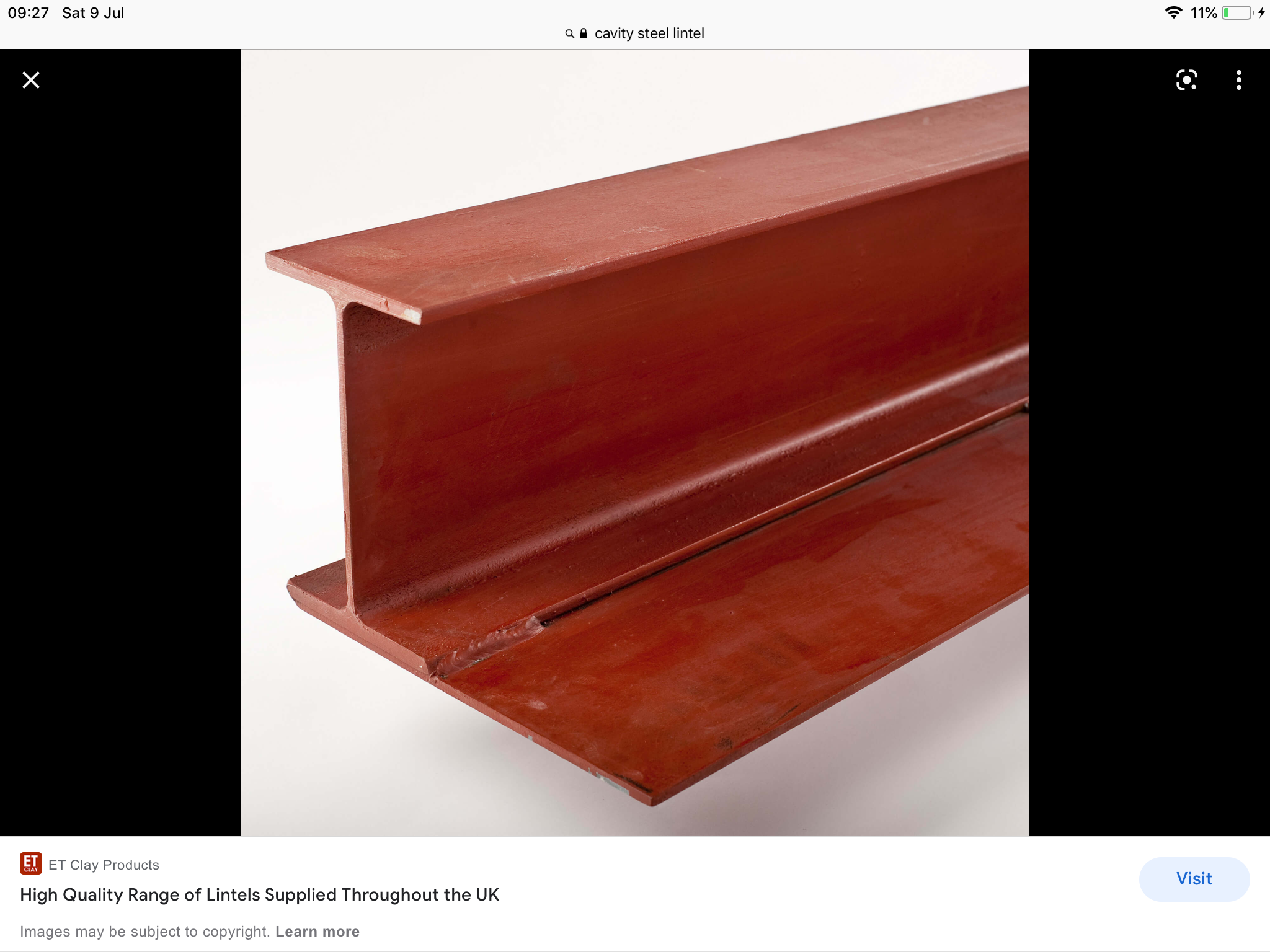

Jet Posted July 9, 2022 Share Posted July 9, 2022 Hi could anyone tell me the best way to build over a a cavity. Obviously the steels sit in the inside block work and I have to return the brickwork over the cavity and on to the steels. Thanks Link to comment Share on other sites More sharing options...
Russell griffiths Posted July 9, 2022 Share Posted July 9, 2022 The steel will have a large foot welded to it, like a 12mm plate, this extends over the cavity and onto the outer brickwork. Link to comment Share on other sites More sharing options...
nod Posted July 9, 2022 Share Posted July 9, 2022 35 minutes ago, Russell griffiths said: The steel will have a large foot welded to it, like a 12mm plate, this extends over the cavity and onto the outer brickwork. As above I’ve just lifted this one in this morning Hit and miss welded plate to a box section that my mate had over in his yard Link to comment Share on other sites More sharing options...
Jet Posted July 9, 2022 Author Share Posted July 9, 2022 Thanks for replying but I don’t think I made myself clear. I am building over a garage extension which will have a pitched roof. I am building above the garage about a metre in. I have to put 2 steels in to take both leaves. Do I make the steels longer which would bridge the cavity as I have to return the brickwork 90 degrees. Thanks Link to comment Share on other sites More sharing options...
George Posted July 9, 2022 Share Posted July 9, 2022 You'll need to post some pictures/drawings. You may need to get a structural engineer to do a quick design. Link to comment Share on other sites More sharing options...
