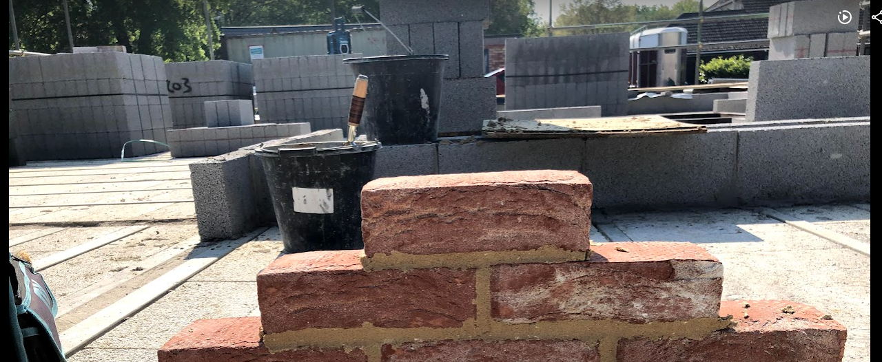

BadgerBadger Posted June 30, 2022 Share Posted June 30, 2022 Our beam & block floor is now in and has been grouted, but the way our site is laid out means space for materials is now quite limited. Is it common to store materials (i.e. pallets of blocks) on the beam and block floor or do I risk overloading it? Link to comment Share on other sites More sharing options...
George Posted June 30, 2022 Share Posted June 30, 2022 I've seen pallets of blocks go through beam and block flooring so be wary. The domestic live load the b&b will have been designed for is 1.5kN/sqm so you'd be safe storing 150kg/sqm on them if needed. A pallet of blocks is more like 1000kg, or 700kg/sqm. Link to comment Share on other sites More sharing options...
crispy_wafer Posted June 30, 2022 Share Posted June 30, 2022 (edited) It's fine Our builder did the same, but did spread them out a bit. Not too many pallets on the same span of beams, and closer to the edges rather than middle. He did come and set the blocks out quickly though as he was keen to get a crack on. Not too many images of this but found one. edit: Reading George's post, I guess it depends on the type of block too, some weigh a bit less than others, maybe you could ask when they are likely to set out the blocks, Not sure I'd want pallets sat on there for weeks on end... Edited June 30, 2022 by crispy_wafer Link to comment Share on other sites More sharing options...
nod Posted June 30, 2022 Share Posted June 30, 2022 (edited) Pallets are fine if they are over sleeper walls I would at least quickly halve the pallets as soon as possible if they are unsupported Edited June 30, 2022 by nod Link to comment Share on other sites More sharing options...
