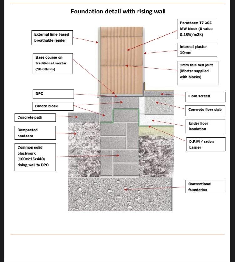

AppBricky Posted June 20, 2022 Author Share Posted June 20, 2022 (edited) 38 minutes ago, Mr Punter said: No. You often see below ground just built in 2 separate leaves with a load of cavity fill concrete between. If the footings are deep you could put in some wall ties but I don't think you need them. Ah right. No the rising wall I’m talking about is solid. It is a block on edge with two blocks on flat behind it. The attached image showing a section through, will hopefully clarify the type of rising wall I am talking about. I’m just so confused about how to build it. I’m afraid of doing something wrong. Edited June 20, 2022 by AppBricky Link to comment Share on other sites More sharing options...
Mr Punter Posted June 20, 2022 Share Posted June 20, 2022 You don't need to alternate the block on flat from inside to outside. Do it inside all the way. BTW Poratherm has many negatives. Very difficult to get a fixing and not good thermally. There is a reason they don't get used over here much. 1 Link to comment Share on other sites More sharing options...
Declan52 Posted June 20, 2022 Share Posted June 20, 2022 Have no pictures. The block on its edge will be set to suit the outside measurement on the plan so when it goes up to sub floor level you then start the first course of brick/block that will end up being visible. You can go right round with one on its edge in one go no bother. This will give you a straight wall with which to put the 2 blocks on the flat up against. Your 2nd course then will be 2 on the flat set plumb on the outside so your bonding over the single block below on its edge. Your basically building a single skin right round and then filling in the back with a 9 inch wall with the blocks bonded as normal. Then on the next course you build a 9 inch wall and fill in the back with the single block bonding as you would normally do building this width. 1 Link to comment Share on other sites More sharing options...

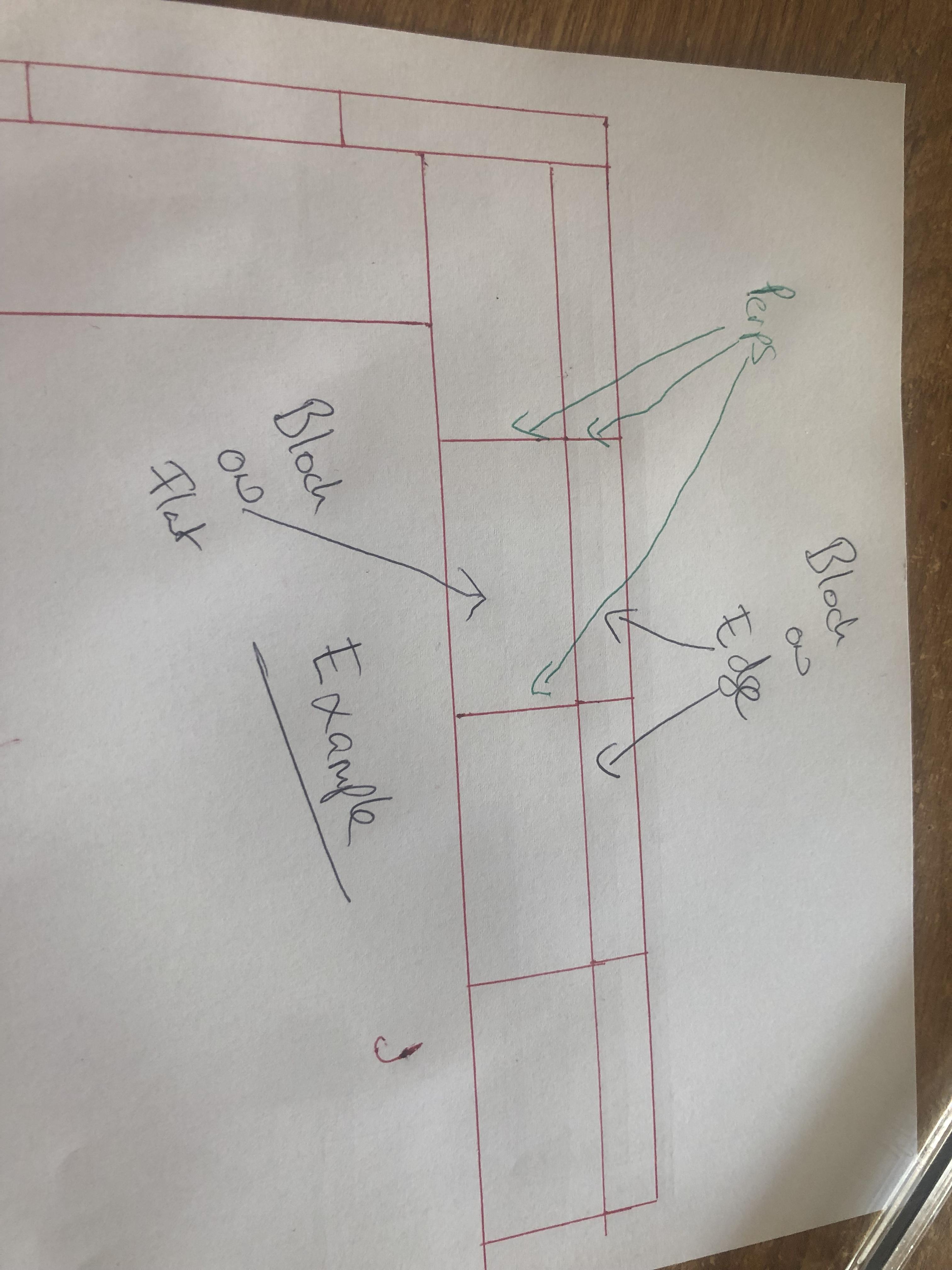

Brickie Posted June 20, 2022 Share Posted June 20, 2022 52 minutes ago, AppBricky said: And hopefully my last question on this - do the perps / cross joints of block on edge and block on flat have to align on each course? For example, should the first course of block on edge cross joint / perp but in line with the cross joint / perp of the block on flat? Indeed they should-sectional joints is the phrase. If you don’t then you’ll have straight joints (or less than quarter bond) vertically somewhere. 1 Link to comment Share on other sites More sharing options...
AppBricky Posted June 20, 2022 Author Share Posted June 20, 2022 29 minutes ago, Brickie said: Indeed they should-sectional joints is the phrase. If you don’t then you’ll have straight joints (or less than quarter bond) vertically somewhere. Thanks Brickie 👍🏻 So like my rough drawing here? Link to comment Share on other sites More sharing options...
Brickie Posted June 20, 2022 Share Posted June 20, 2022 Yeah,that’s the principle. Bonding the corners could be a pain though. Link to comment Share on other sites More sharing options...
AppBricky Posted June 20, 2022 Author Share Posted June 20, 2022 38 minutes ago, Brickie said: Yeah,that’s the principle. Bonding the corners could be a pain though. Pain? How so? Cuts to keep the joints the same on both leafs? Link to comment Share on other sites More sharing options...

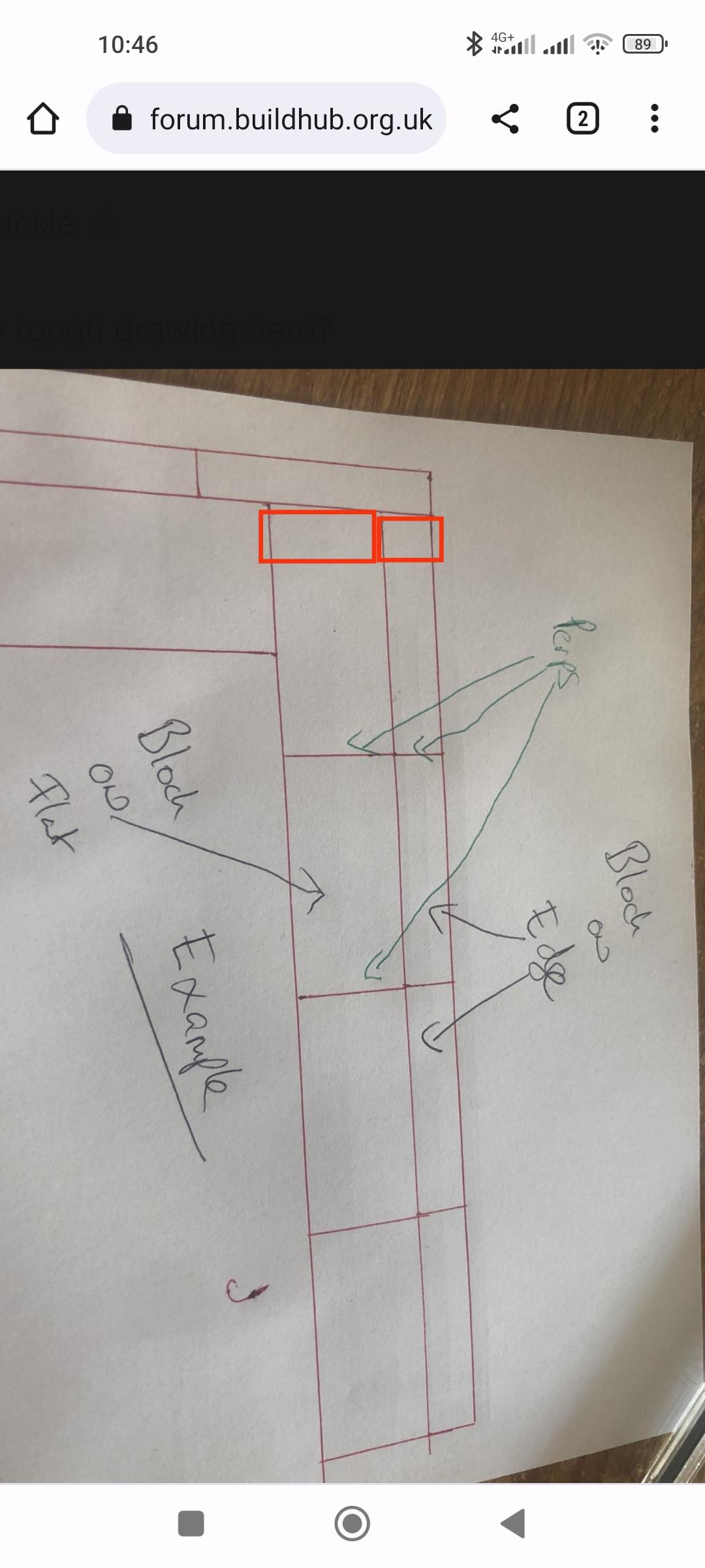

Declan52 Posted June 21, 2022 Share Posted June 21, 2022 You should have bricks in the return of that pic but otherwise yep. You always end up with cuts no matter how you try to do it. Link to comment Share on other sites More sharing options...
AppBricky Posted June 21, 2022 Author Share Posted June 21, 2022 21 minutes ago, Declan52 said: You should have bricks in the return of that pic but otherwise yep. You always end up with cuts no matter how you try to do it. Thanks Declan. Which return? The block on edge? Can I cut 3/4 for corner to keep half bond? Link to comment Share on other sites More sharing options...
Declan52 Posted June 21, 2022 Share Posted June 21, 2022 Should look like this then you get the correct bond. Use 3 bricks. Link to comment Share on other sites More sharing options...
