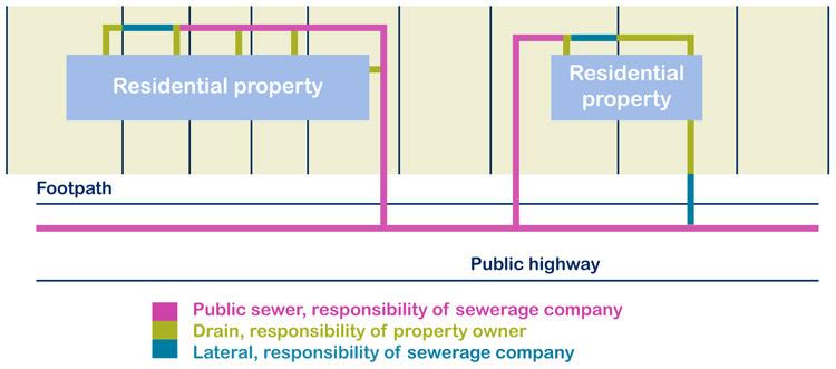

Temp Posted June 19, 2022 Posted June 19, 2022 13 minutes ago, saveasteading said: It sounds as is yours is a private stub only affecting your 3 houses. Perhaps not since 2011?... https://www.ofwat.gov.uk/nonhouseholds/supply-and-standards/responsibility-supply-pipes/
Alchemist Posted June 19, 2022 Author Posted June 19, 2022 Well thank you for your responses. They are gratefully received. Ok the situation is as follows. The sewer is shared between the three houses. I believe this defines it as a public sewer. The sewer gets clogged about three times a year due to a fault where the sewer joins the main sewer. When this happens, our patio gets flooded with sewage and the water board unclogs it. Without putting too fine a point on it, the blockage is always `sanitary` products (which we don`t use) It is always us that has to organise this. We have had constant bullying over the construction of the conservatory for eighteen months now. My wife has been reduced to tears many times. The old conservatory was constructed before the Water Board adopted the sewer and was built over the sewer. We don`t know if there was any mention of this sewer in the old planning permission. When planning permission was requested for the construction of the newer, bigger conservatory, a proviso was definitely put into the approval certificate via the Water Board, that they were not to build within 3m of the sewer (I have a copy). This will be 3m along and into my patio and just 2ft from my extension wall. The entire conservatory will be constructed over the sewer. A relative seems to think that because old conservatory was built over the conservatory, than the 3m condition will not apply to the new conservatory. We have come up against type of thing this before. Planning stated that, because the old conservatory `overdeveloped` the site (their words). then if the new conservatory over developed the site even more well, that was ok. I have given up trying to fathom out the logic system the planning department work to. For instance 80% of the conservatory will contravene the 45 degree rule but hey that `OK its only guidance we can apply it when we want to!` I`d really appreciate some guidance on the sewer they have definitely not strengthened it or done any modifications to it just build over it. Thanks for your help
