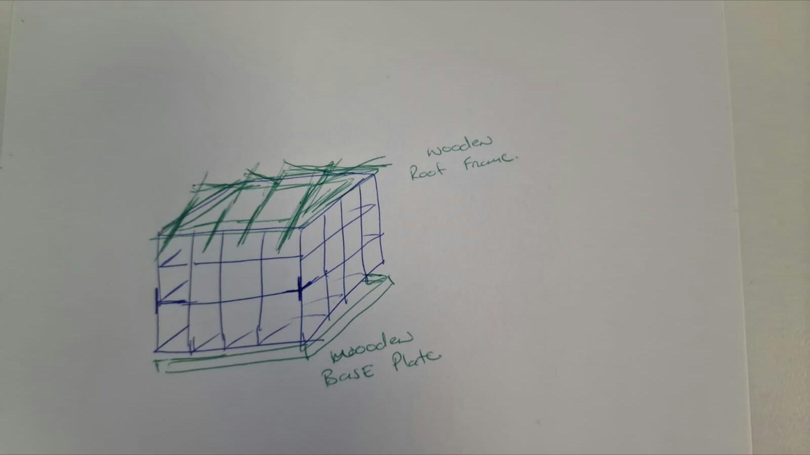

A while back my mate gave me a load of 25mm box section. I think it's powder coated. This was old server racking.

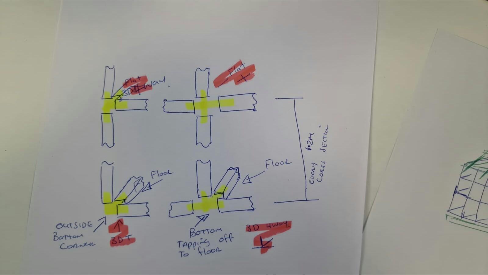

He's been on for ages about building a new workshop and has a mad idea for my lad to print him 120 - 140 PETG connectors. Then to clad the resultant frame in 18mm ply with self drill screws. It comes from him seeing the veg patch frame I've built from the box section using similar connectors.
IMG_20220605_162742628
Seems a crap idea to me for a number of reasons. For one I feel MIG welding it would be better if at all.
I can't see how he'd insulate it easily either.
Gut feel is such thin walls would be "wobbly" to say the least.
These are his sketches:
Any thoughts? @Gus Potter?
@Onoff Like the veg patch.
Would advise your mate to give the "shed" idea a rethink using these sections. Also could be false economy.

Thanks. It'll probably get some small sheet gussets pop rivetted at the junctions.
Yeah, daft for many reasons. I still reckon pallets. I've done it and it works.
Plus I'll have to give the box section back! 😂
Welding with gussets would be much stronger I guess 🤔Yes pallets are a good idea (and you keep the steel 😎
