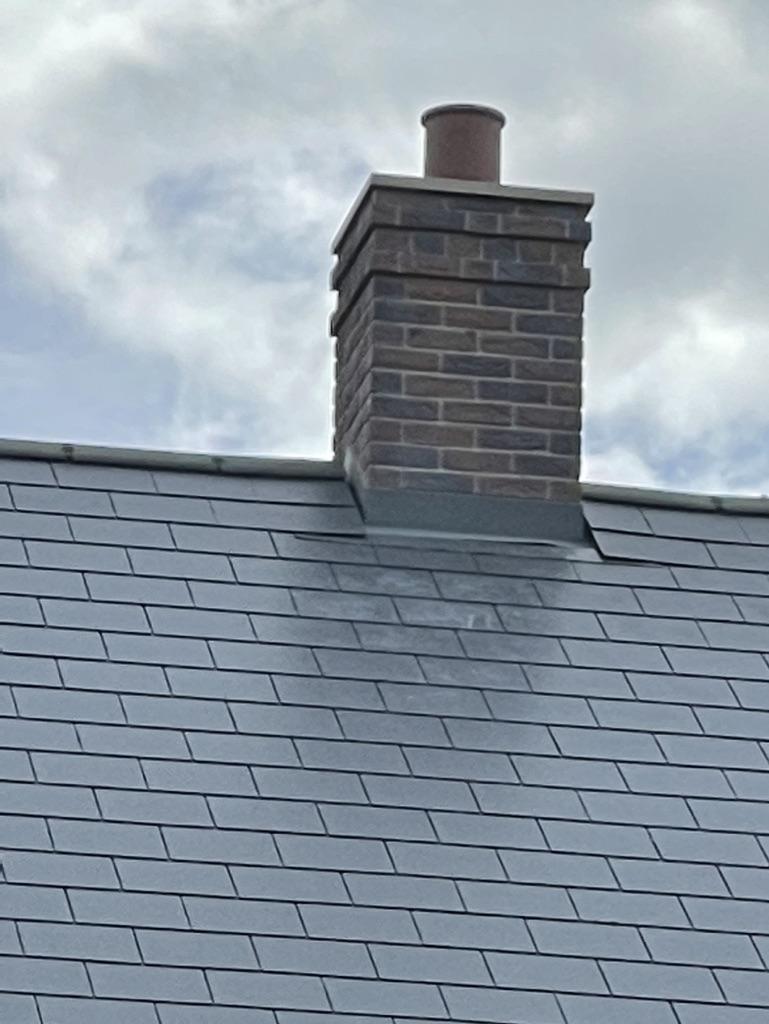

Hi,
We're buying a new build property and I've been watching the build processes pretty much weekly as it's within walking distance from where we live now.
The roof has recently been completed which includes a GRP mock chimney. Apparently the roof has been 'signed off' but in my opinion, the tiles around the chimney are not flush and look awful. I'm thinking this will cause problems over time with the wind/rain/snow etc. getting underneath them.
I'm interested in other peoples opinions, does anyone think this is a bad job or is this just acceptable and more of a cosmetic/personal opinion thing? I've made a complaint to the sales office who has contacted the 'build manager' but I'm not sure if I'm just being fussy.
Thanks!

Looks ok
Its not always easy to get the slates-tiles to lies flat over the flashing Especially thin ones like yours
With a thicker type you can knock one of the lugs off the tile Which helps
Chimney looks good for a fake
There’s some real horrible ones being used
Personally I think that is a failure of the engineering design.
Do a search and see if you can find the manufacturer and ask their opinion. They almost certainly want their product to be fitted correctly.
You could do
But if you look around at other chimneys and Velux It’s quite common
Not pretty though
Manufacturers couldn’t care less how there product is fitted once it’s left the factory

It's hard to tell why that 'kick-up' occurred. I suspect it'll be fine in terms of being waterproof, but once being aware of it, it would annoy me. Pity the 'stack' (in terms of the lead visible on each side) is asymmetrical, too.
The kick up is due to the lead and is unavoidable with those thin cement-fibre slates.

Thanks for all the responses, we’ve found it really helpful. I decided not to make too much of a fuss about the tiles. I’ve now noticed there’s a window in the wrong place, so that’s become the priority to get sorted!
