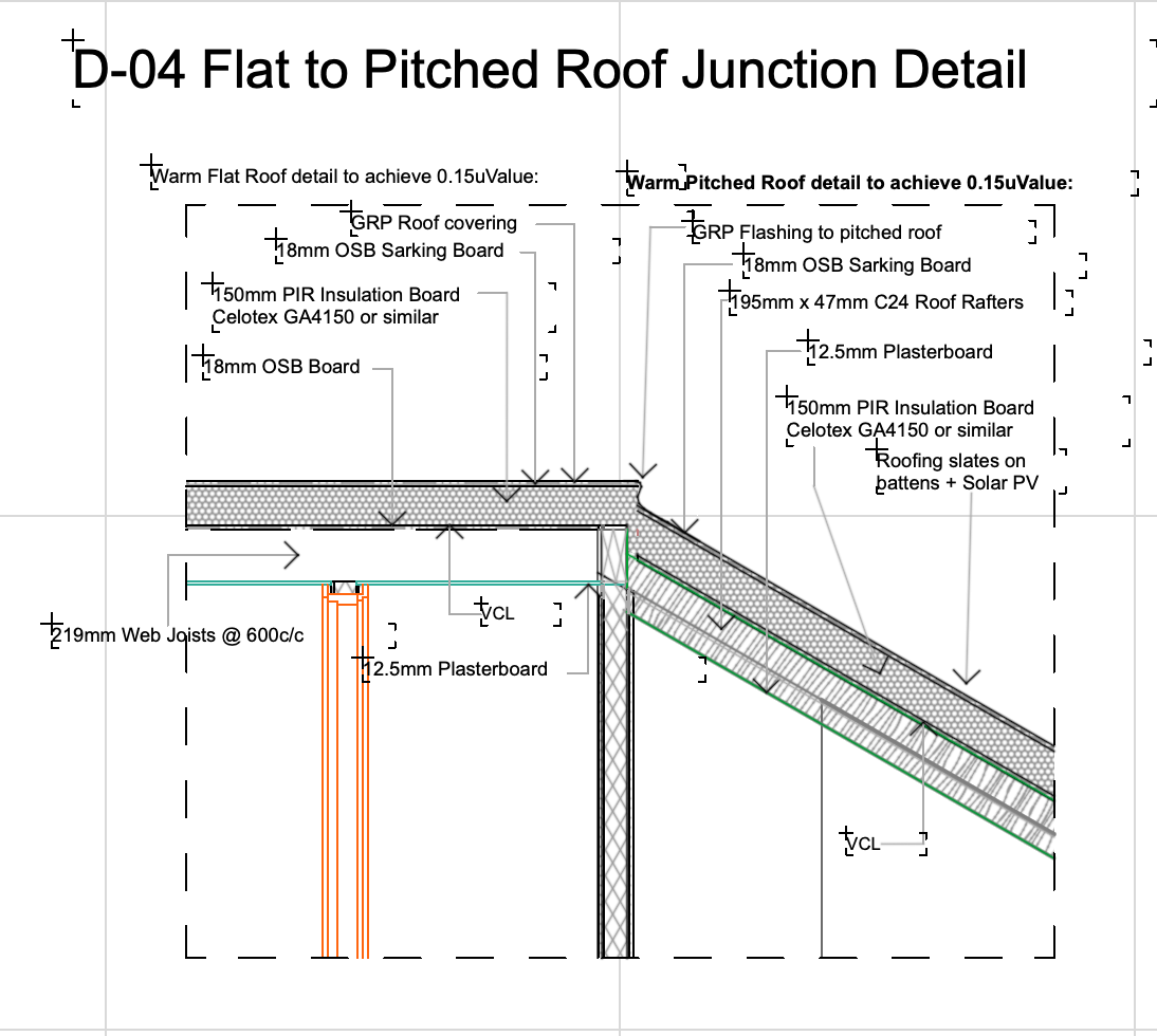

BartW Posted May 18, 2022 Share Posted May 18, 2022 Hi again, Sounds like there will be a lot more of me seeking reassurances going forward.... I have two roofs adjoining: - warm flat - warm pitched Detailed as below: Can anyone see problems with it? It was going to be warm to cold initially, but possible cold bridges and likelihood of failing in such form had me redesign it. Or would an inverted hybrid be better on pitch? i.e. 60mm over the joists, and 60mm inbetween? Thanks! Link to comment Share on other sites More sharing options...
Iceverge Posted May 18, 2022 Share Posted May 18, 2022 Have you planned a fall for your flat roof? Bregs suggest 1:40. Link to comment Share on other sites More sharing options...
BartW Posted May 18, 2022 Author Share Posted May 18, 2022 3 minutes ago, Iceverge said: Have you planned a fall for your flat roof? Bregs suggest 1:40. Yes, falls towards the pitched roof. Link to comment Share on other sites More sharing options...

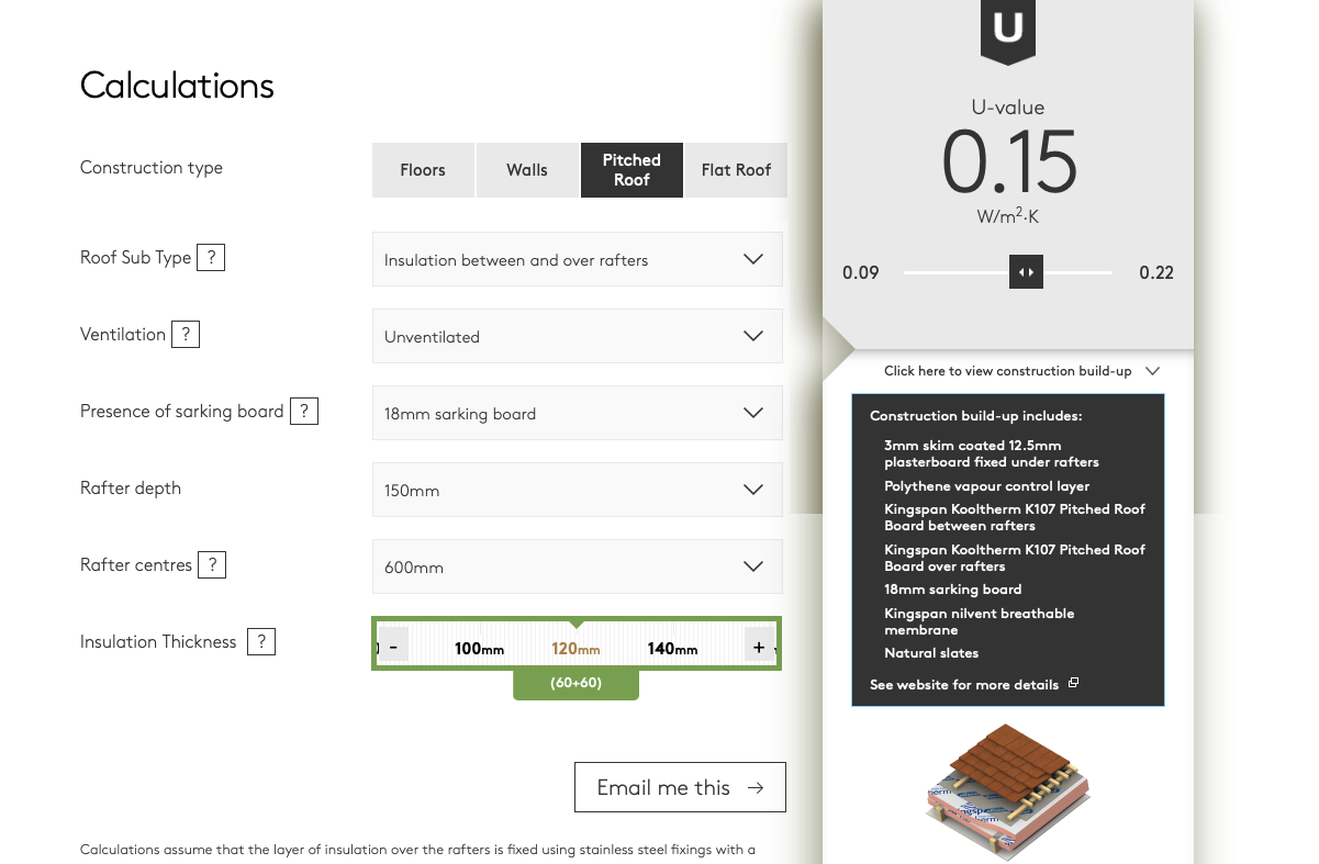

BartW Posted May 18, 2022 Author Share Posted May 18, 2022 Thinking about this again, would I be able to achieve better performance of the pitched roof by doing a 100mm PIR above rafters, and 100mm rock wool between the rafters? Decrement delay and thermal mass come to mind, having read a few recent posts. Also, would it fly with flat "warm roofs"? I.e. 100mm PIR above, and 100mm rock wool between rafters? Link to comment Share on other sites More sharing options...
BartW Posted May 20, 2022 Author Share Posted May 20, 2022 Anyone to comment please? Also, weirdly, Kingspan suggest 60 over + 60 in-between for the "warm" roof buildup on pitched. Any benefit to having sarking vs no sarking? Would I be better off doing that instead of bulky 150? Link to comment Share on other sites More sharing options...
Dave Jones Posted May 24, 2022 Share Posted May 24, 2022 no vapour control barrier shown on the drawings, absolutely critical. Alutrix is the best. Look at kingspan thermataper insulation, you can adhere EDPM directly to it saving the cost of 1 layer of decking. Link to comment Share on other sites More sharing options...
