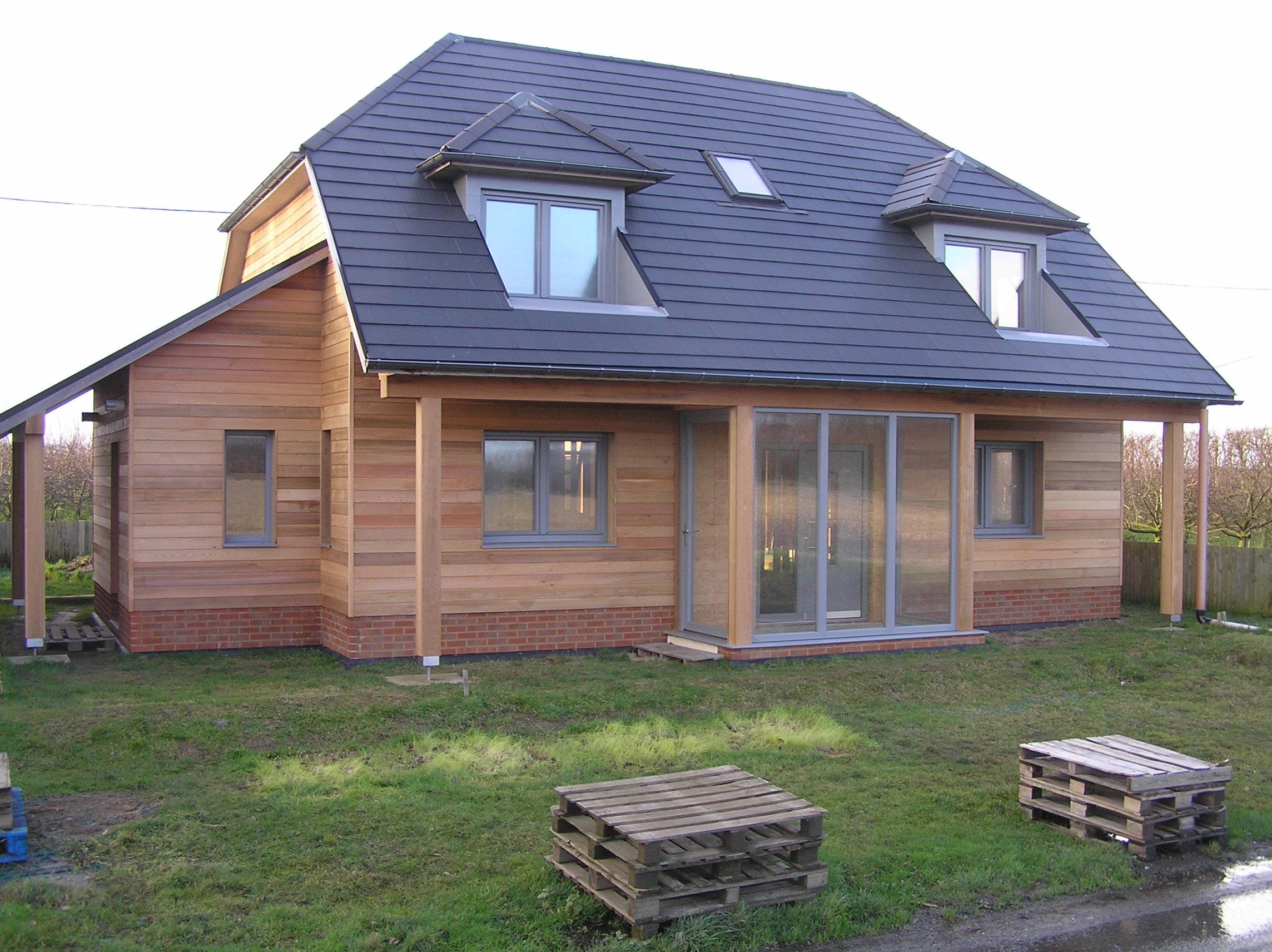

Gone West Posted May 17, 2022 Posted May 17, 2022 On the TF house I built I had a plinth clad in brick slips on cement board. Around the porch there wasn't a plinth but I clad the foundations EPS upstand with two rows of brick slips just glued to the EPS using Titebond PU gel glue. We didn't have a problem for the five years before we moved. https://www.axminstertools.com/titebond-solvent-free-construction-adhesive-311ml-10-5oz-409001

deuce22 Posted May 18, 2022 Author Posted May 18, 2022 I've spoken with STS (which specialise in slip cladding). They have advised to fix battens to the ICF, then a render board to the battens. I can then use a brick slip mortar for bonding the slate. I'll try that Titebond adhesive first, directly to the polystyrene on a small section and see how that holds up. What timber cladding is that on your house?
Gone West Posted May 18, 2022 Posted May 18, 2022 1 hour ago, deuce22 said: What timber cladding is that on your house? It's Canadian Western Red Cedar graded number two clear and better.
deuce22 Posted May 18, 2022 Author Posted May 18, 2022 Thanks. I have two areas of my property that needs cladding with timber. How much was it and where did you buy it from?
Gone West Posted May 19, 2022 Posted May 19, 2022 15 hours ago, deuce22 said: Thanks. I have two areas of my property that needs cladding with timber. How much was it and where did you buy it from? It was a local timber yard that supplied it, but it was several years ago now. At the time I got quotes from all the internet suppliers and the local place was competitive and would supply all 4.8m lengths rather than a mixture of lengths.
