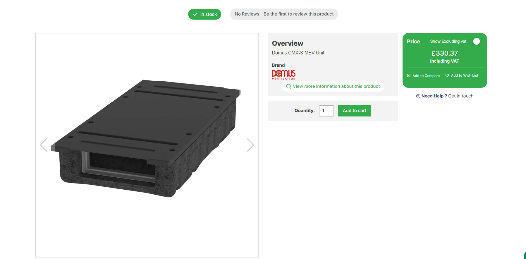

PIV is an option also ( positive input ventilation ) but seems to have opportunistically doubled in price in the last few years.

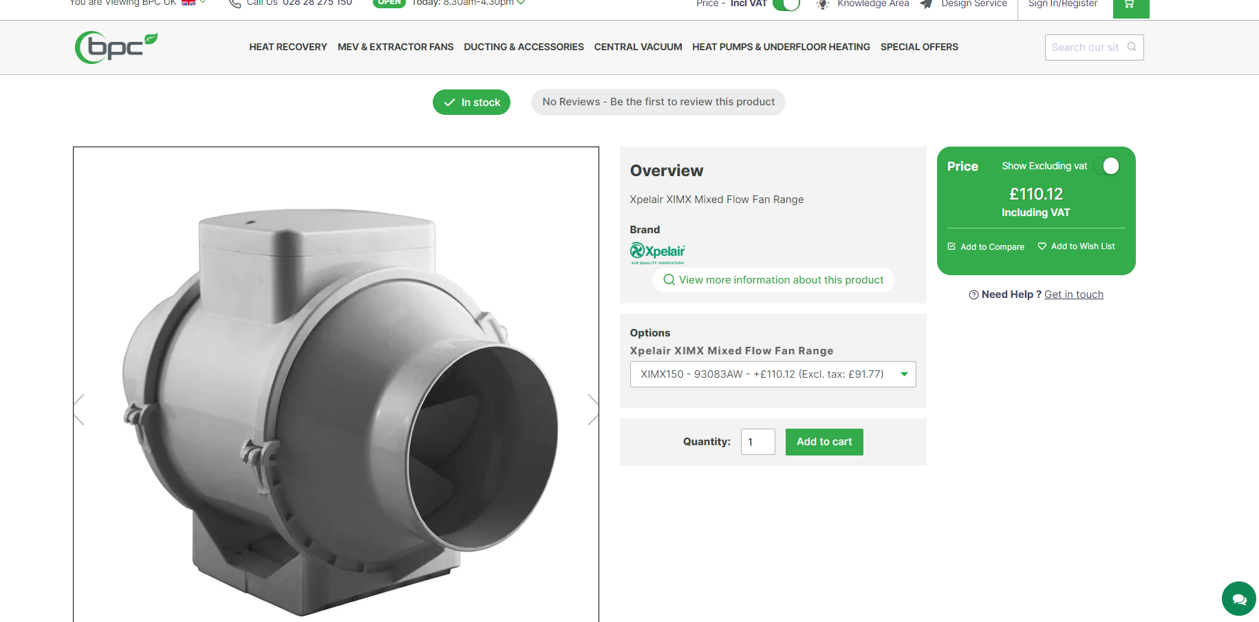

I installed one of these in my parents house last year as it was very damp.  It just sits in the attic above the upstairs landing extracting from there to an outside vent.  No ducts to any wetrooms. I did this on the impression that if the internal doors are opened occasionally then the humidity will equalise.  It seems to be proving right.
It has helped to get rid of lots of the mould although they seem to think the house is colder with it running. Hard to say objectively. I did need to install a DIY silencer as it was noisy without one.
I can't see where the price increase goes over something like this is however.
