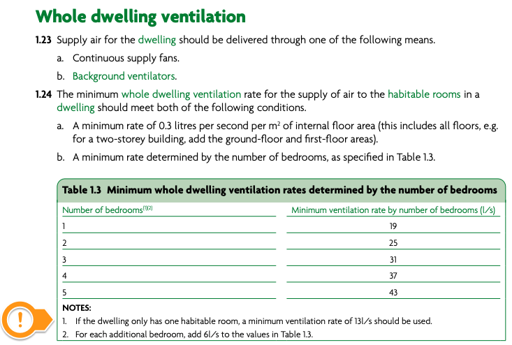

MrMagic Posted May 12, 2022 Author Share Posted May 12, 2022 (edited) Thanks for the feedback, reminded me to go read part F to see what I should be doing - note this is an existing small garden office/shed. Part F actually makes it quite clear - Since this garden office/shed is a single room, you could argue it should follow the above and have a minimum fresh air delivery rate of 13l/s - currently I'm only putting in 6l/s with my dMVHR - which kind of explains why CO2 is rising so much. No combustion appliances or anything like that here and the graph tracks exactly when I start/finish work.... perhaps less gassing on Zoom will help too? For reference its 17m3 so if we take the lower 0.3 ACPH - (17*0.3)/0.2778 = 18.35 l/sec of air. So whichever way we cut it, I'm at least 7l/s of air 'short'. (assuming it's a perfectly sealed box) Thanks @JohnMo and @SteamyTea ! Edit: I've got a https://www.vent-axia.com/range/lo-carbon-tempraselv fitted - looking at that it's 6 or 9l/s in trickle and 15l/sec in boost - so running in boost all day should be enough to clear the air.. will give it a whirl. Edited May 12, 2022 by MrMagic Link to comment Share on other sites More sharing options...
