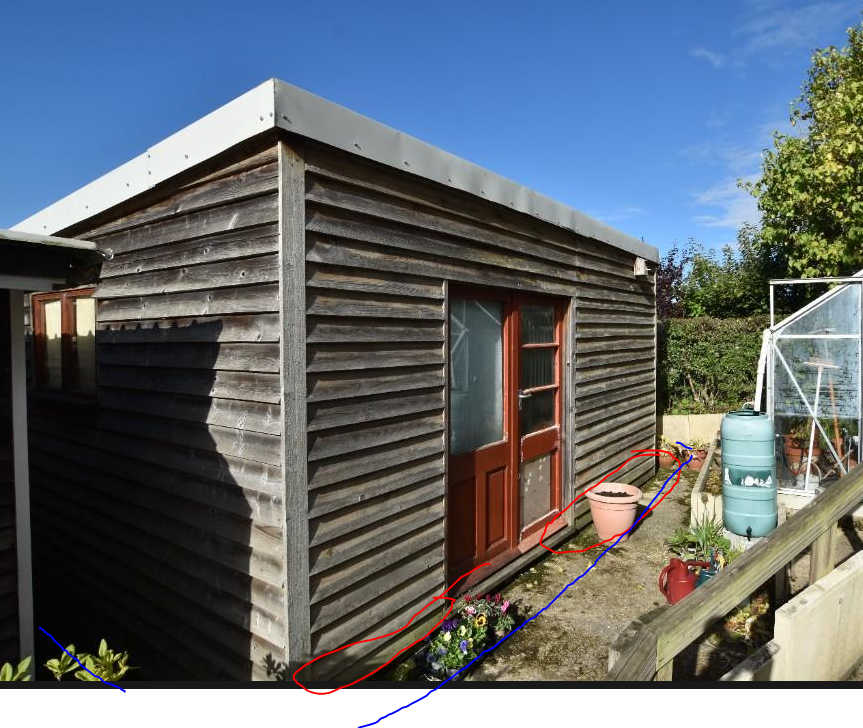

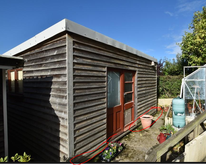

Most of the cladding looks to be in good order, as does the roof. Leave well enough alone I say.
What are you planning on doing with the windows/doors?
One area that might merit some thought would be the bottom run of cladding. It looks like it is suffering from some splashback from rainwater ( red looped areas) .  Normally cladding wouldn't start 150-200mm above the ground to prevent this.
Technical Details: How to Transition From Rainscreen Cladding to Brick
A simple solution might be to cut the concrete along the blue line maybe up to 300-400mm back from the wall, with one of these.
You could break it by hand but it wouldn't be as neat.
Then dig out 300mm deep and backfill with 100-150mm of gravel. This should be enough to ensure the timber stays dry.
What is your plan for the electrics?
If the internal ply hasn't rotted with the poly/paint sandwich by now it's not going to.
Get some airtightness tape and tape all the joints in the plywood and tape the doors and windows to the ply. Tape the ply to the roof and floor making a perfectly airtight box. This is more important than insulation in creating a stable internal environment.  Very easy to DIY, just takes care.

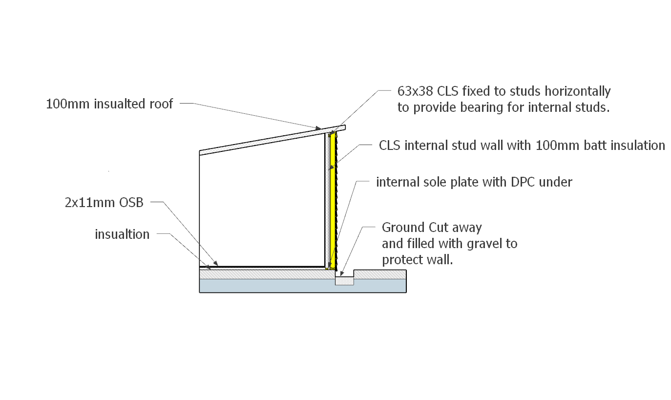

For the walls I'd use 63mm CLS set back from the wall by 38mm @600 c/c. Any smaller timber will be too bendy to get a nice wall finish. You can use a 38*63mm CLS timber on its side screwed through the ply tot he studs at the top ( and bottom if required) to create this setback .
This will create a 100mm ish (63mm+38mm) space to fill with 600mm rockwool batts or similar. Also the gap behind the studs will give you a nice thermal break and leave a gap for the electric cables etc. Then cover with 15mm plasterboard.
2 hours ago, Adthrawn said:
Still deciding on finished floor - would have liked an amtico etc, but  need floating flooring. That said, if I put double lapped OSB down, is that secured in anyway and suitable for adhered floors, or is that still left as a floating floor?
If you glue the two layers or OSB together with all joints well staggered and stick down the Amtico too it'll work fine. I'm not an expert but I can't see any issues. You'll need to get your floor insulation dead flat first however. If the floor of your shed is undulating use a straight edge and some sand/cement mix or tile adhesive to fill any low spots.  Put down your insulation and the OSB on top. make sure to leave a few mm for the OSB to expand at the edge.

Thank you for the detailed reply!
1A) Windows - the two side windows will be removed in the next phase. The neighbouring wooden garage is in a very poor state, so I'll pull that down and rebuild it. Longer lead time as will need planning, as want to change the roof direction for solar panels, and absorb space taken by other wooden "things" that have been built around it. The plan is to join the two buildings by a wide link, that will be both a passage and storage etc. This will take in the two Windows (single glazed and not very useful).
1B) Doors - replacing them with a 3-door bifold. Obviously wider opening needed, and that will be closer to the left-hand wall. The front wall appears to have been made from three "modules", so I'll have to rebuild some of the framework, but less of a job thanks to how the front has been built. I still need to source a threshold for the bifold, as want to account for the increase in floor thickness (circa 70mm with the 50mm PIR and 2x 9mm OSB (for amtico or less if a floating laminate flooring).
2) French gutter at front - totally agree with that, and around the sides and rear it's soil and been overgrown, so will scrape back soil but soil membrane down and put gravel down. Planning to leave the gravel until after building work, but if I'm just doing the inside now, then could be a "quick" job to get done first (already spent a couple of days clearing the overgrown ivy and weeds etc). The front path however will have to wait for the electrics...
3) Electrics - quite my forte, was planning to surface mount, but if I have a void, may as well hide the cabling and create a nice crisp white box... Linked to the above, the current power supply is an armoured cable buried in concrete. Not to my liking, and makes changing the path near impossible. I've already laid ducting along a fresh route, so when I pull the new cable in, I'll be free to cut the concrete in front.
4A) Ply sandwich - fair point, it's been standing for 15 years or so. Internal ventilation is definitely the big issue, as when I cleared out the old workbenches, shelving etc, the majority of the musty smell went. Still not completely gone, but a good bleaching of surfaces and properly ventilating the place should get rid of that.
4B) Air tight tape - just any foil tape, or something specific? Also, if taping the plywood, does this in effect become a vapour barrier? Is the insulated stud wall on the cold side or the warm side? Are you for/against the addition of ventilation in the top of the cladding panels?
5) The stud wall does seem the best option, and something I can chip away at progressively... Because it's a metal roof (insulated panels), is there any special treatment of the top of the frame, like extending a tape or barrier between the frame/plasterboard and the plywood? I'll use skirting and trim at the roof to finish the plasterboard off. Or is the frame/plasterboard happy to just butt against the roof as-is?
6) I plan to lay a vapour barrier poly sheet under the PIR - I'm not sure if a barrier was laid in the concrete floor originally. I'll seal that to the plywood walls as well - would that be a sufficient DPC for the stud wall?
Thanks
As that might be a time off I'd treat the windows as if they were staying put for the time being, Tape into place and do your best to make sure they seal properly.
This might be lots of work for limited benefit. The existing opening looks to be about 1800mm wide. I would put in a pair of French doors at half the price of bifolds into the existing opening. Bifolds are notoriously drafty unless you get very good ones. I wouldn't sweat too much about  the threshold. Door suppliers do PVC spacers that would raise your door to floor level.
So long as it is proper airtight tape I wouldn't be too fussy.  Something like this would work fine.
https://passivehousesystems.co.uk/product/phs-argo-joint-tape/
Split tape is better for the windows.
https://passivehousesystems.co.uk/product/phs-85-15-split-release-tape/

I would install the final windows and doors in the structure as is. Make your own blower door fan and make the external plywood totally sealed with tape at all the joints and to the floor. This isn't hard and is ideally suited to the DIY'er. Given it's your own project you're lightly to get a top result too.
Then build a stand alone stud wall (63mm CLS minimum) stood off the ply internally by say 100mm. (can be increased/decreased) This will create a handy void for all your services. Fill this with mineral wool/ rockwool insulation and the gap between the studs.
Finally plasterboard internally. You may need vapour retarder plasterboard/ foil backed to keep the vapour in check.
To really add polish use blown cellulose  in the void.
Pretty cheap and very easy to do in bits as it's all internal. Equally importantly, given your busy life at any point in the progress you can close the door and walk away as all the work is internal.
As for the floor, Insulation board (as much as you can fit) and then a floating floor or 2 layers of staggered OSB. If you have the head height you could use a pumped screed with UFH.
With the plywood layer being sealed, should the plasterboard be foil backed or plain? Just ordering materials, and realised not clarified that...
