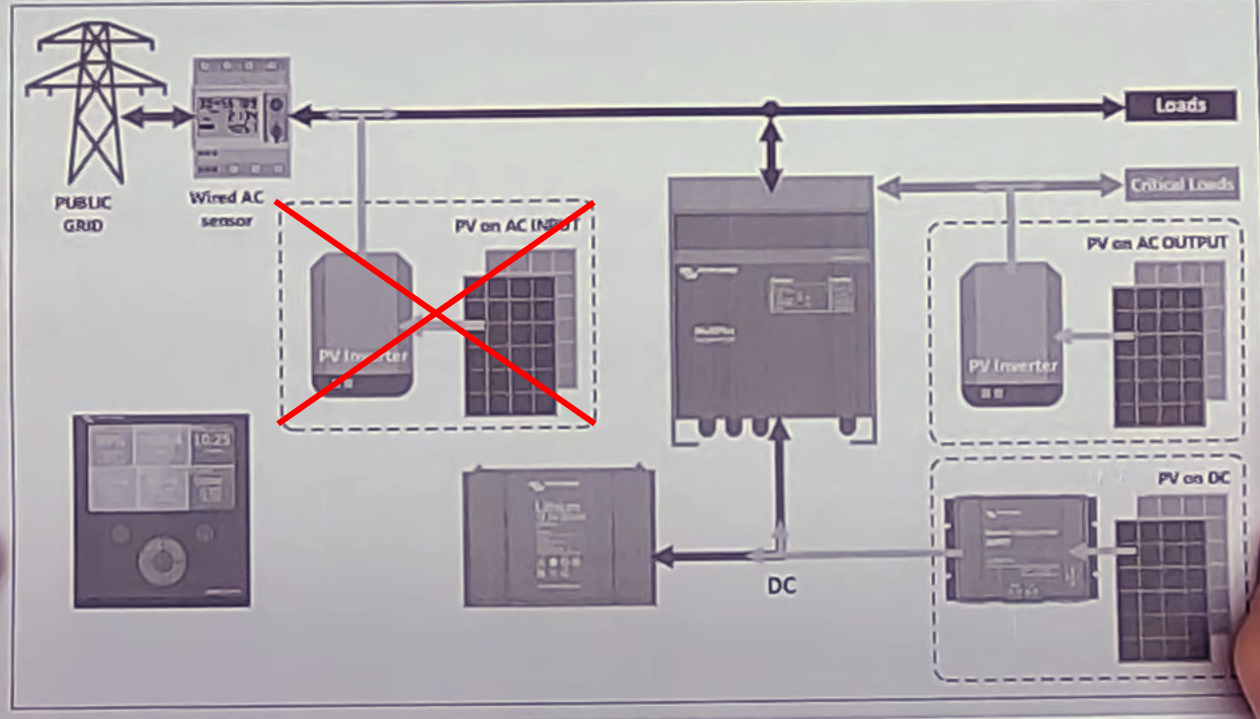

Ronski Posted May 3, 2022 Author Posted May 3, 2022 @Nickfromwales Do you have a link to a build thread of what you are intending on installing? Our gas bill isn't too bad, between February 2021 and February 2022 what we used at current prices equates to £600 of gas + £100 standing charge. Just had a quick look at costs of cylinders and they are not bad, its something to consider as I could install myself back where the original hot water tank was. One consideration is that if installing a battery of sufficient capacity then there would be a lot less spare solar energy to heat the water though.

Ronski Posted June 6, 2022 Author Posted June 6, 2022 I’ve been watching more of Andy’s off grid garage journey, and it occurred to me at the weekend, from a simplicity and cost point it view it would be better to use four MPPT 150/35 charge controllers, with three panels on each string. Whilst this won’t work as well as SolarEdge optimisers with regards to shading, it probably wouldn’t be far behind, problematic panels could have Tigo optimisers fitted if need be. This approach would reduce maximum usable power, as the new array and batteries would be just through the Multiplus II, which unless I went up a size (a lot more expensive) would be limited to 4kw output, but it’s not often we’d exceed that anyway. The existing array could be run in to the critical loads output, and thus both arrays would keep running in an extremely rare power cut, supplying power and charging the batteries. The fridge freezers (on their own circuit already), lighting and perhaps some emergency sockets could be run off the critical loads circuit. This would of course require two new cables from the garage. Would the Multiplus II be able to handle the existing 4kw array on the critical loads circuit and would we be able to use say 7kw of solar if both arrays was producing 3.5kw? What's you're thoughts on the above?
