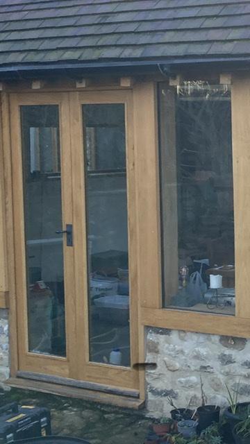

Rishard Posted April 29, 2022 Share Posted April 29, 2022 Oak doesn’t ‘need’ finishing. It’s often an aesthetic choice. The lovely golden colour of milled oak soon goes when exposed to the elements. If you oil it, generally it stays golden for 5 or more years but you set yourself up for a life time of maintenance to try keep that golden colour. Osmo is good for this but I have found it is useless on any surface which isn’t vertical. Horizontal weather bars seem to flake, peel and start the greying process. 1 Link to comment Share on other sites More sharing options...
Rishard Posted April 29, 2022 Share Posted April 29, 2022 See the weather bar on the french door cils. These doors are 6 years old. 1 Link to comment Share on other sites More sharing options...
