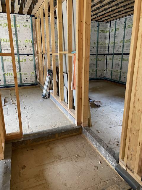

Thorfun Posted April 24, 2022 Posted April 24, 2022 I think I know the answer to this one and logic tells me I'm right but do I cut out the coursing blocks between the internal doorways/openings where the sole plate was cut out? I'm going to have to run UFH pipes so I'll need to cut holes for them and also lay insulation for the UFH pipes to staple to and then get a liquid screed in. so my head and logic is saying to cut those blocks out. just thought I'd check with the collective before I do something stupid.
Thorfun Posted April 24, 2022 Author Posted April 24, 2022 55 minutes ago, nod said: Sure do Always best to check cheers @nod. will get the disc cutter out next week then. 😉
