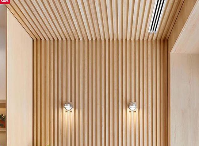

Hi. The finish to our kitchen living area is a sand cement render - no skim. I want to put approx 10mm x 40mm latts on parts of the wall as a centrepiece. Just wondering the best way to fix them. I will have a 20mm gap between latts so cannot put a backing lat in there. Is it rawl plugs for each latt?..might be 10 latts wide in total.
These latts will continue along the ceiling - this is just a brad nailers into the plasterboard i presume..would the brads go into the aluminum dropped ceiling holding the plasterboard?
Thanks
Morgan
I would fix a stiff backing board first. Then glue/pin the laths to the board. Fixing them individually would be not only laborious but will end up all over the place.
As you are on Sand and cement, I would go for glue.
