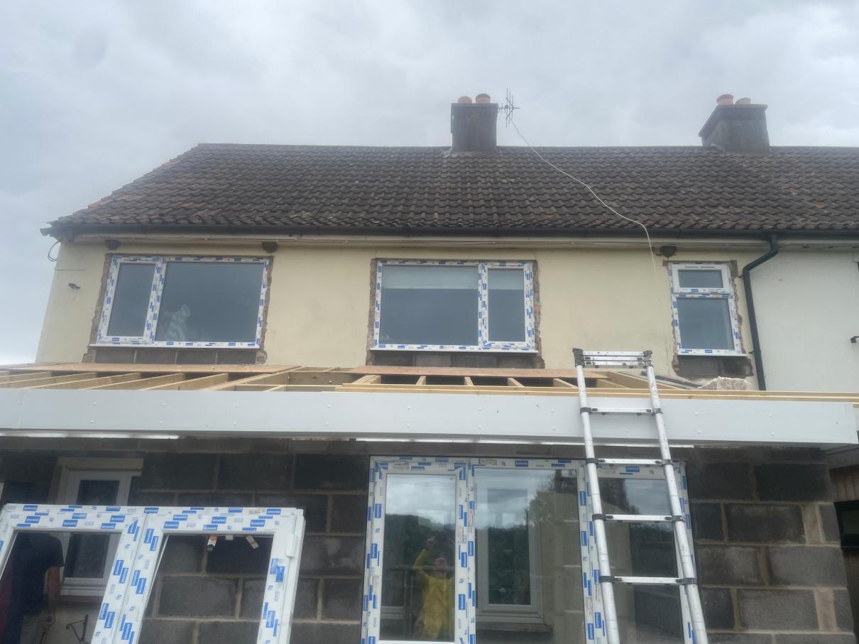

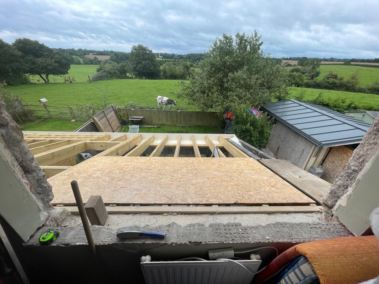

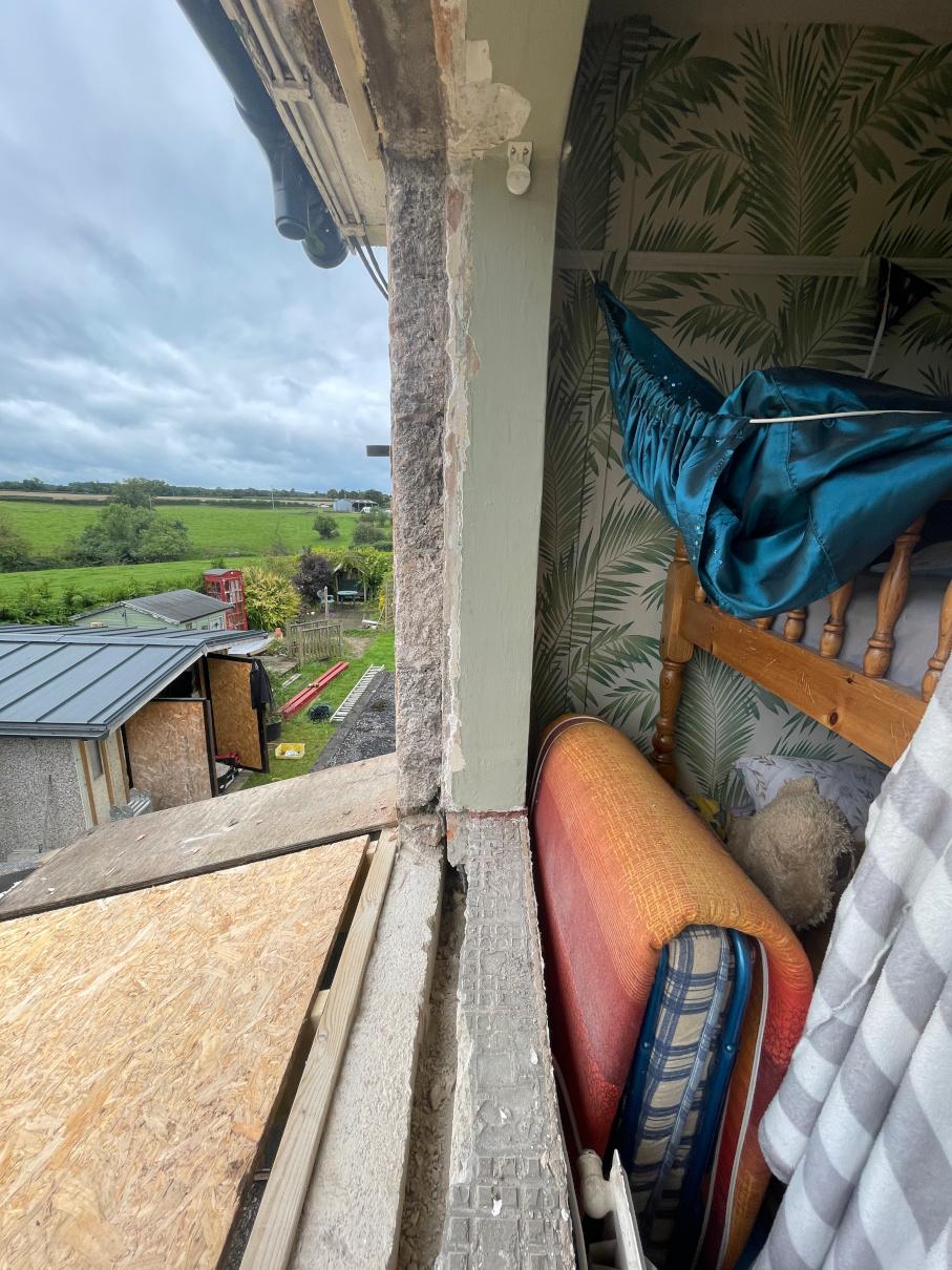

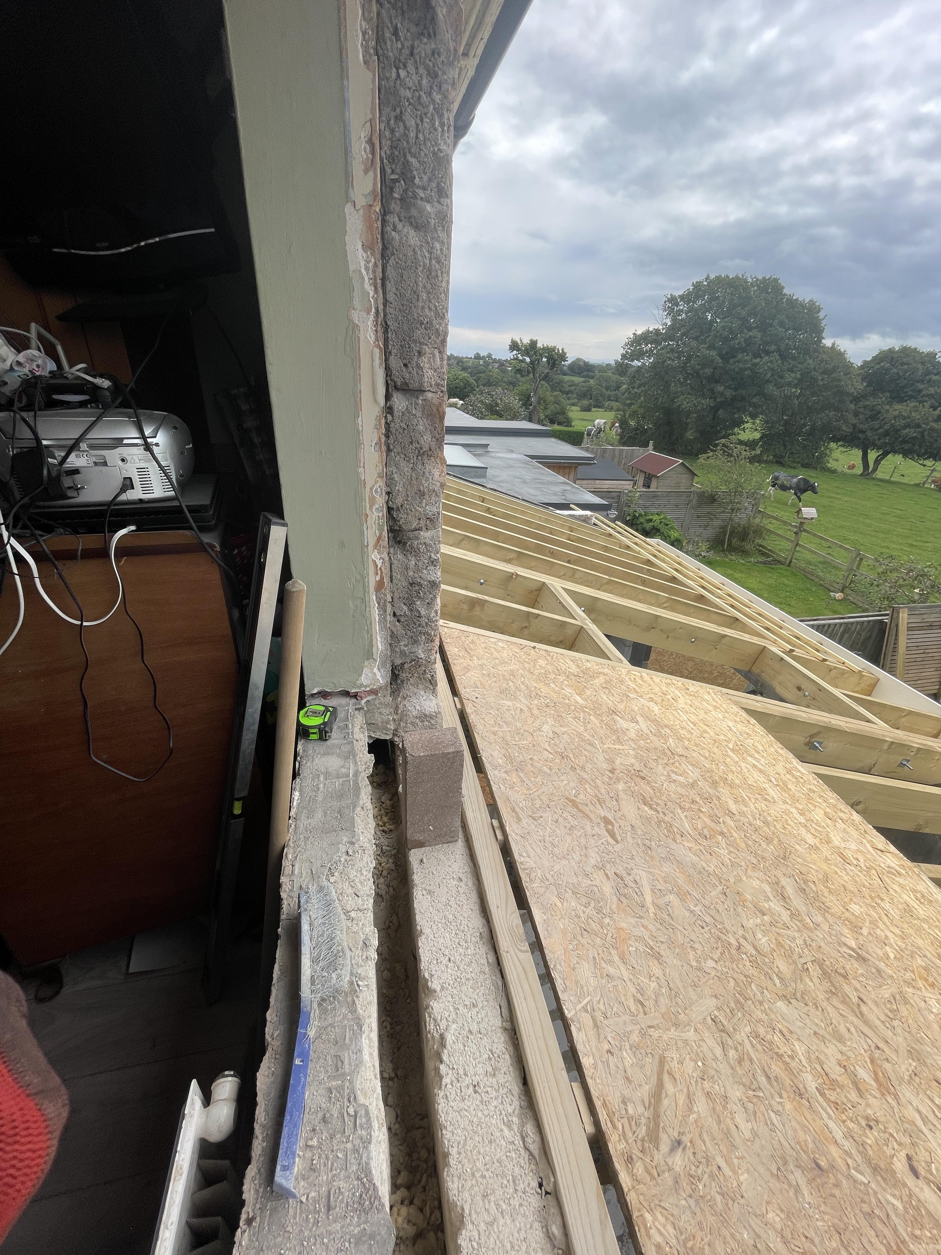

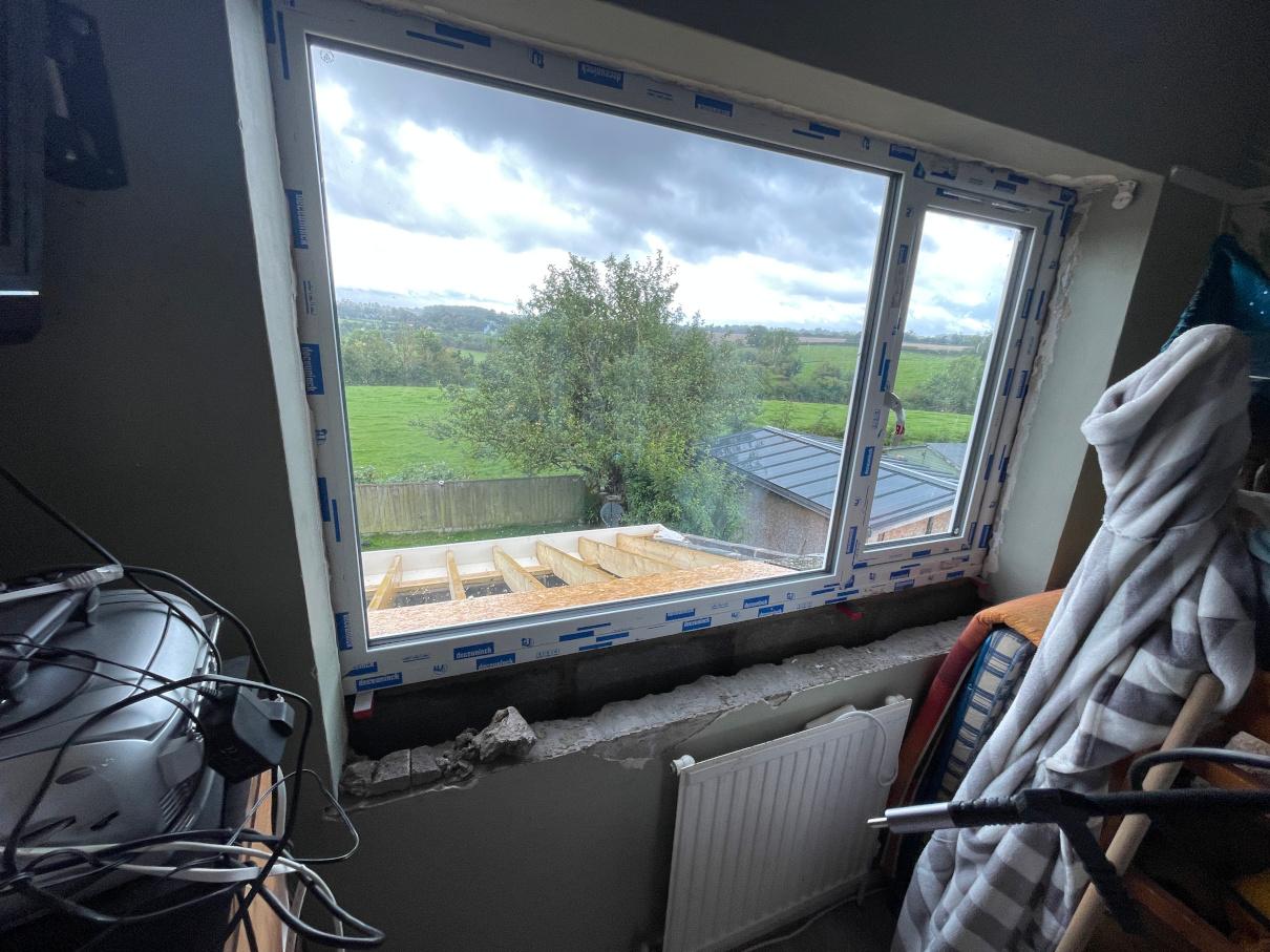

HughF Posted August 2, 2023 Author Share Posted August 2, 2023 Tiled/cold bridge/poured in situ concrete sills removed, cavities stuffed with some more rockwool, windows fitted with compriband and fm330... Making the best of a bad situation. 2 Link to comment Share on other sites More sharing options...
HughF Posted August 2, 2023 Author Share Posted August 2, 2023 Making the best of the view though... Link to comment Share on other sites More sharing options...
