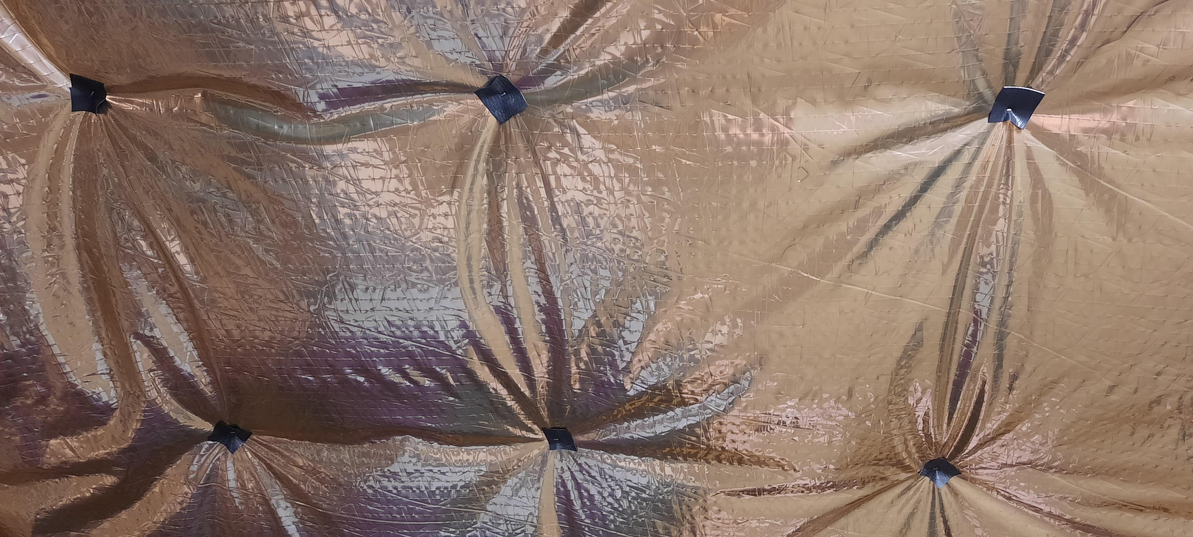

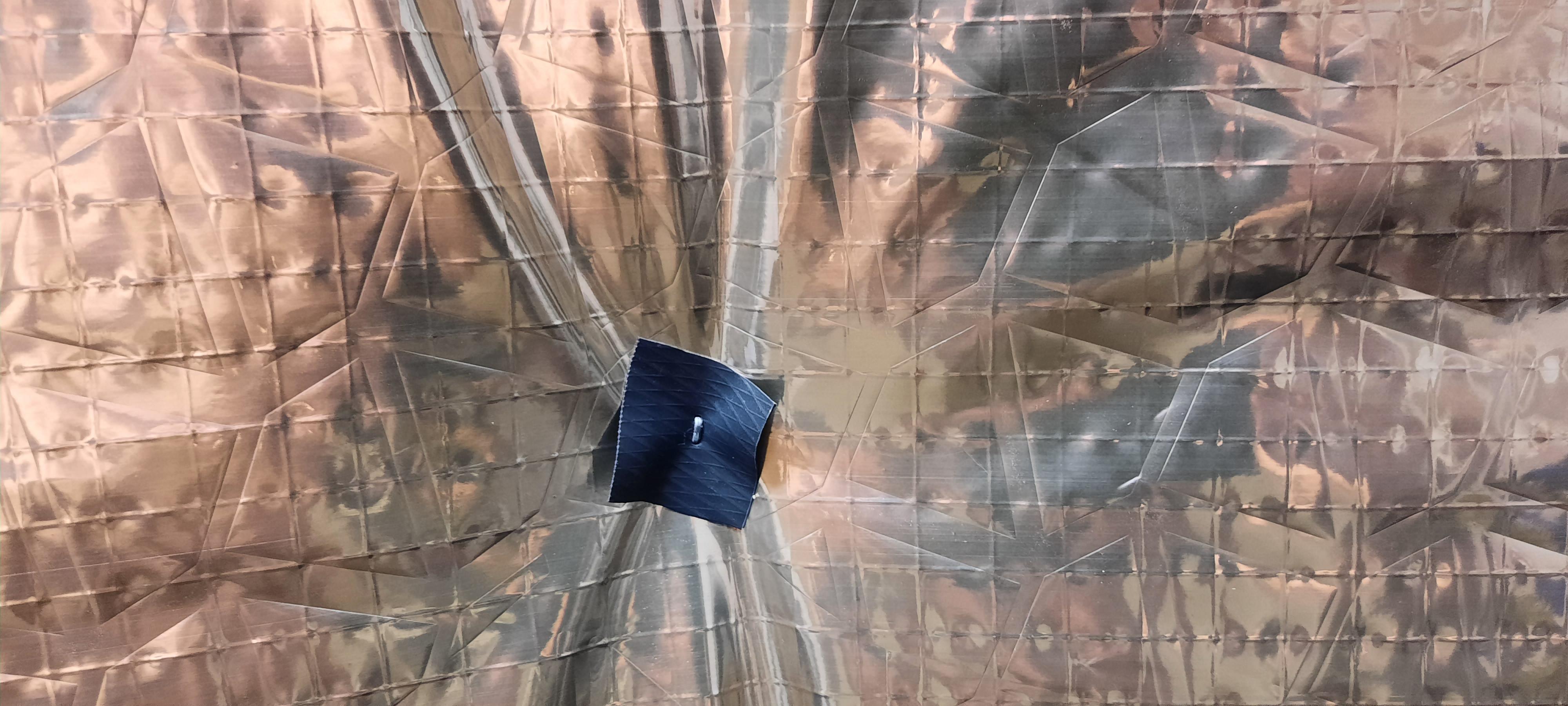

I doubt that you'll be able to secure it with a hand stapler, there's too much 'spring' in the Actis. I cut 1 inch squares from a roll of DPC membrane and used them as a pad to fire circa 40mm staples through the Actis with an electric staple gun. I'll dig out a pic and post later.
PS. Without the DPC pads the staples tear through the foil.

It was a cheap Titan gun from Scewfix, and I've just checked the size if the staples and they were actually shorter than I recalled, ie Tacwise 22mm stainless divergent.
