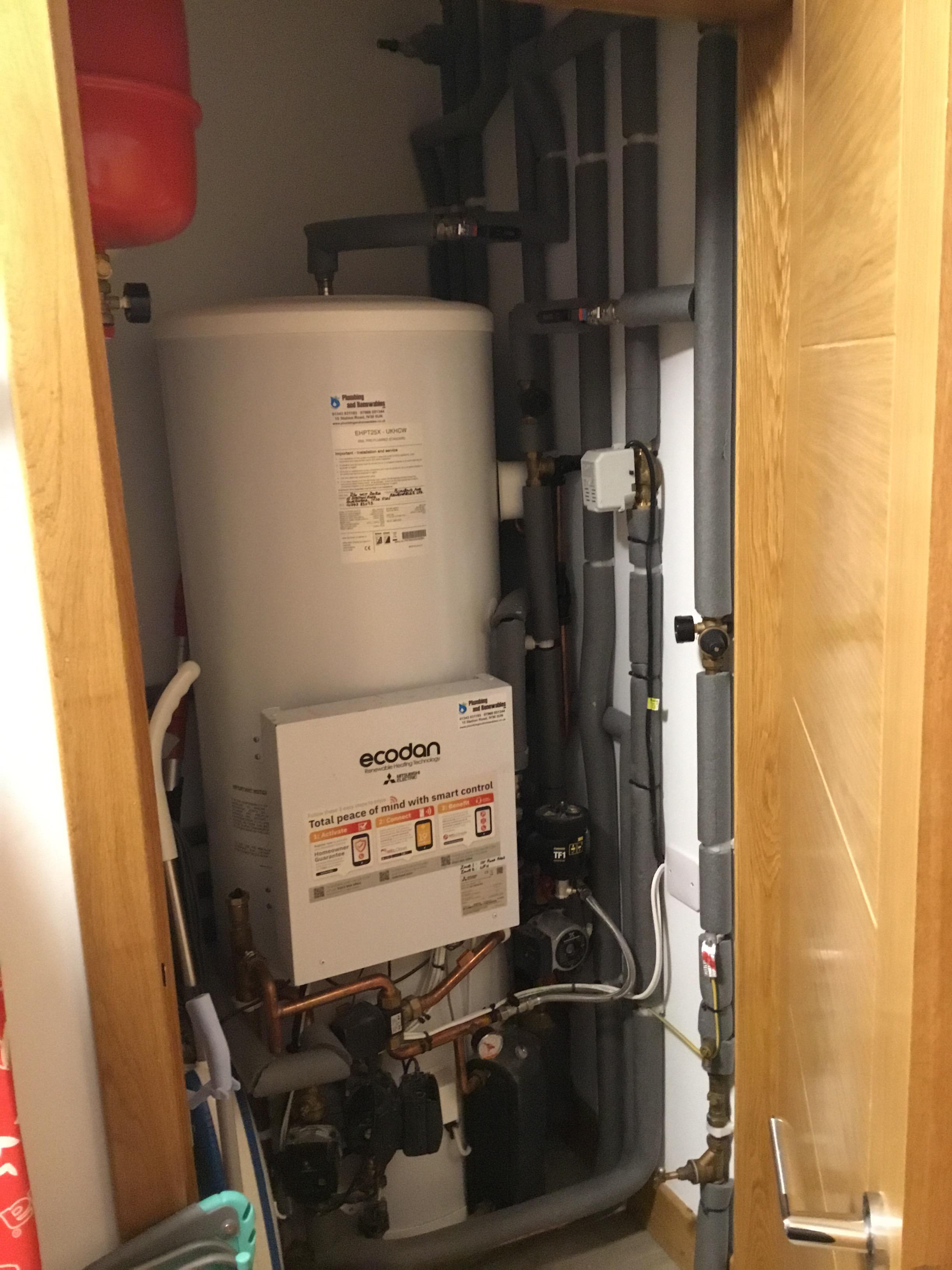

SBMS Posted April 9, 2022 Share Posted April 9, 2022 Hi all Just wondered if anyone can give an idea of the smallest 'cupboard' required to house: 300l cylinder 100l buffer (for the ASHP) Plumbing gubbins for the ASHP We have currently set aside space in our utility on the ground floor of approximately 1m x 1m internal space (full height ceilings). I think we might be being optimistic but this cupboard has stolen space from the downstairs WC already so hoping we don't have to steal any more. Does this sound tight? Link to comment Share on other sites More sharing options...
JohnMo Posted April 9, 2022 Share Posted April 9, 2022 You can get a square 100l buffer that is designed to sit under the cylinder. So find the cylinder and buffer sizes and there you go. 1 Link to comment Share on other sites More sharing options...
Bozza Posted April 9, 2022 Share Posted April 9, 2022 Our cupboard is 1x1 full height. Contains 230l cylinder & gubbins, fuse box etc etc. Some space to front for ironing board etc but not much room each side of cylinder. do not place your cupboard underneath or next to bedrooms, you’ll hear the system when on. If you have to, mitigate with extensive sound insulation. Hope this helps. Link to comment Share on other sites More sharing options...
SBMS Posted April 10, 2022 Author Share Posted April 10, 2022 8 hours ago, Bozza said: Our cupboard is 1x1 full height. Contains 230l cylinder & gubbins, fuse box etc etc. Some space to front for ironing board etc but not much room each side of cylinder. do not place your cupboard underneath or next to bedrooms, you’ll hear the system when on. If you have to, mitigate with extensive sound insulation. Hope this helps. Thanks - do you have a buffer? Am thinking it might be tight to get a 100l buffer which our installer has specified, in a cupboard this size (if we can’t do what Johnmo suggests) Link to comment Share on other sites More sharing options...
Bozza Posted April 10, 2022 Share Posted April 10, 2022 Yes so there is dead space above the cylinder. So stacking a buffer is theoretically possible, as suggested, depending on dimensions and obviously allowing for some sort of structure/framing. Probably need to speak to your plumber though as what might physically fit on paper is different to what can be fitted in real terms eg access etc. as a door is only 2m high or thereabouts. Link to comment Share on other sites More sharing options...
