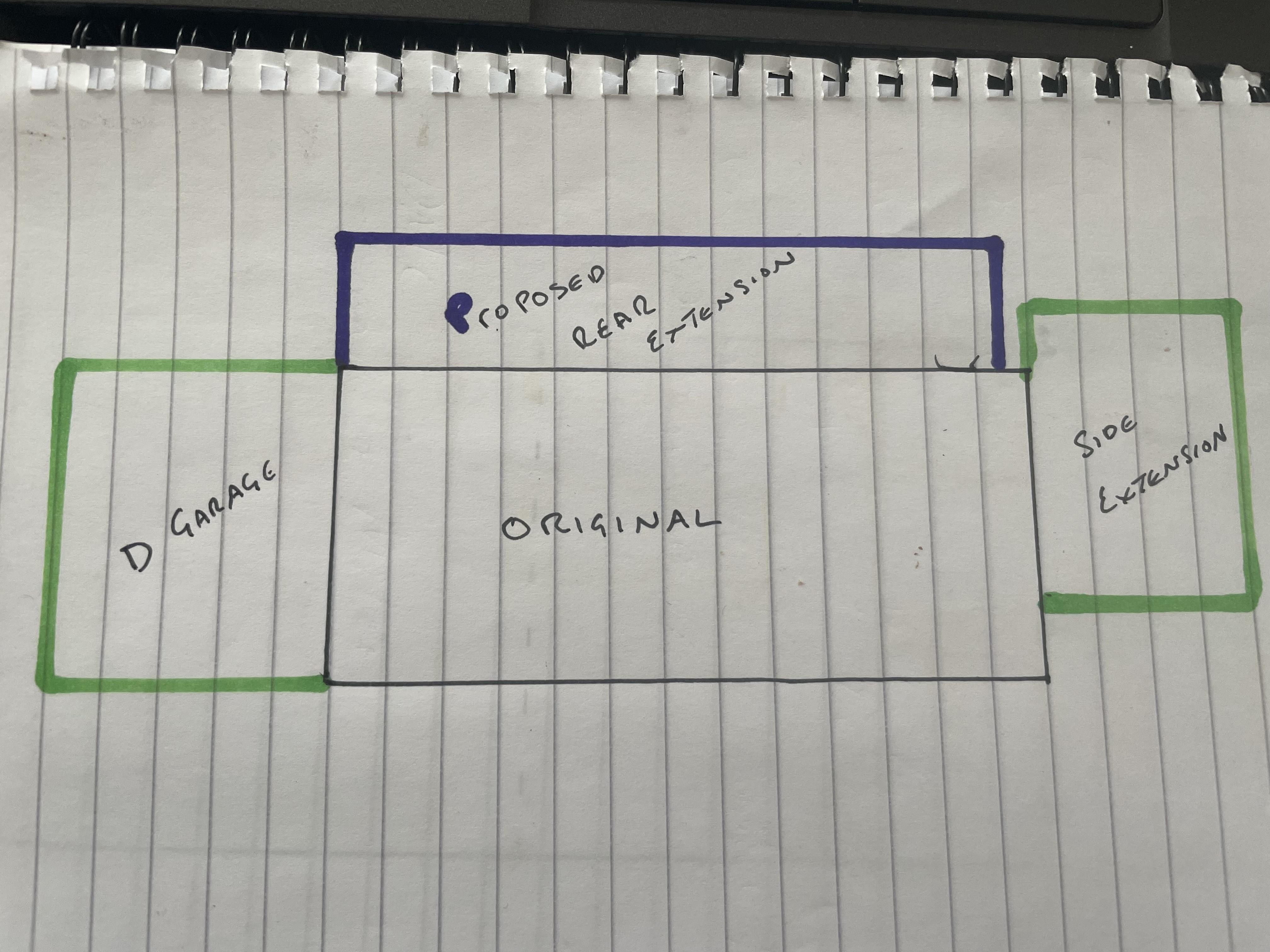

hi,
We hope to add a rear kitchen extension (purple outline) to this 1930s property in a green belt and AONB area. We will have to use PD as the house has already extended, under planning, back in the 70s (green outline) and is at the 50% volume of original mark. Annoyingly the side extension goes past the original house by about 2m. This means if we attach the rear extension to the side extension it is classed a wraparound and we won’t be able to go full width of the original house (black outline).
Q is to any experts out there, if I leave a small gap between the rear extension and the side can I go nearly full width rear extension? Or would we need to demolish part of the side extension back to the original rear building line?

I think you are correct. The half width of original house restriction only applies when it extends beyond a side wall. Which it would do if it joins the previous extension. So leaving a gap should be OK. However I recall reading that planners have argued over the size the gap needs to be.
It might be worth applying for a certificate of lawfulness to establish that an extension with gap would be Permitted Development and make a planning application for full width extehsion without a gap at the same time. If they reject it appeal on the grounds that overall the difference is insignificant.

Thanks Temp, good idea on trying the planning app alongside the CLD.
