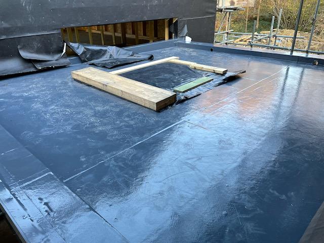

our flat roof makeup from inside to out is:
posi-joists
18mm OSB
VCL
190mm PIR
11mm OSB
Alwitra VSK single-ply membrane
then the green roof is simply laid on top of the single-ply. not sure on the exact make-up for the green roof though sorry. I wasn't really paying too much attention at that point and they laid it so quickly that I missed most of it!
we have 2 drains on each green roof which are part of the waterproofing layer, so built in when the single-ply got laid. then the green roof drains down to that layer and the out of the outlet. you can see them on the far side of this photo.
