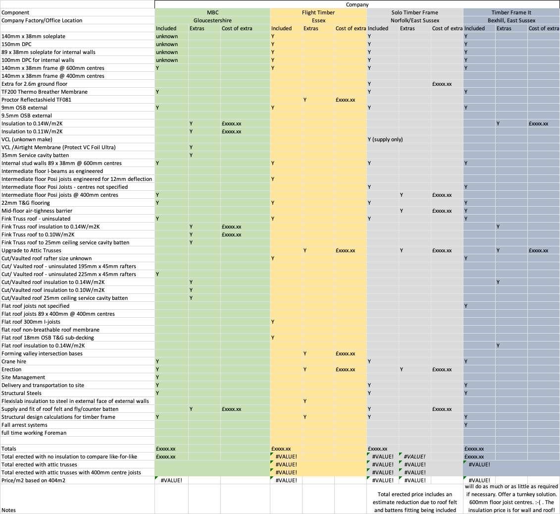

thefoxesmaltings Posted April 1, 2022 Posted April 1, 2022 I am in the process of getting our technical drawings completed by my architect - these will then be sent out to timber frame companies to tender for. I will be project managing and sourcing trades myself. Appreciate that each timber frame company is slightly unique, and some may consider elements as 'standard' whereas others may consider elements as 'extra'. Therefore, I'm looking for a 'belt and braces' tender document or spreadsheet which I can send out to all the timber frame companies (for them to fill out against), so that we can accurately compare quotes like-for-like between the TF companies to make sure all elements are included and quoted for, thus avoiding surprise additional costs as much as possible during the build. I was hoping that with the vast amount of significantly more experienced individuals on here, that someone would have produced a thorough document/spreadsheet which they used to successfully tender against TF companies. If so, would it be out of the question to share it with me? Much appreciated.
Thorfun Posted April 1, 2022 Posted April 1, 2022 (edited) I did it the other way and just sent our BR drawings to various TF companies and then put the resulting quotes in to a spreadsheet and could then see which companies included stuff and which didn't etc. I could then go back to the ones that didn't include things and asked them to add that item. I figured that TF companies should know what's required to build a house better than I did and so basically left it up to them to tell me what I needed as a base line. but at the end of the day my decision on who to use came down to quality of work and gut feeling as to whether I could work with them more than price. Edited April 1, 2022 by Thorfun 1
thefoxesmaltings Posted April 1, 2022 Author Posted April 1, 2022 42 minutes ago, Thorfun said: I did it the other way and just sent our BR drawings to various TF companies and then put the resulting quotes in to a spreadsheet and could then see which companies included stuff and which didn't etc. I could then go back to the ones that didn't include things and asked them to add that item. I figured that TF companies should know what's required to build a house better than I did and so basically left it up to them to tell me what I needed as a base line. but at the end of the day my decision on who to use came down to quality of work and gut feeling as to whether I could work with them more than price. Fair enough, I guess that approach makes sense, too. Would you mind sharing the spreadsheet which has the most 'complete' list of items included? Even if you take out the actual numbers/quotes, that would be helpful to see.

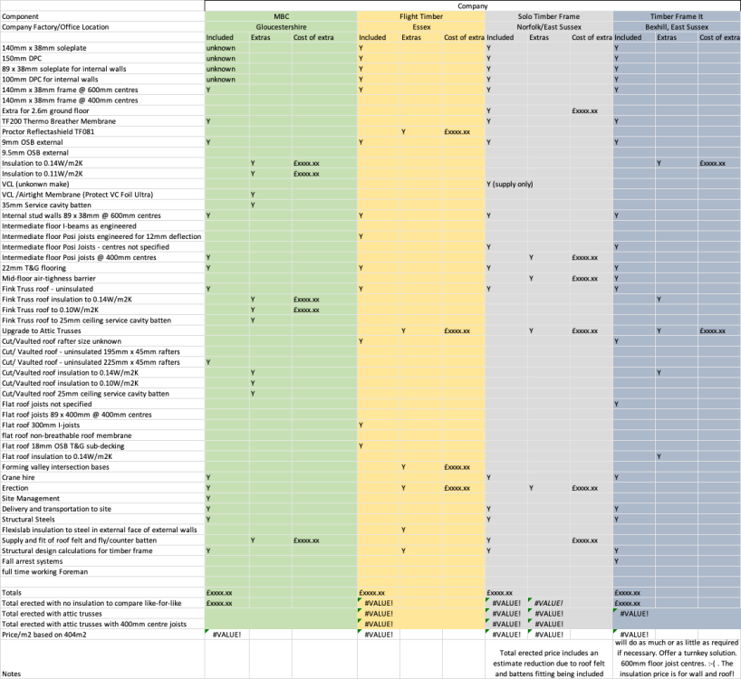

Thorfun Posted April 1, 2022 Posted April 1, 2022 10 minutes ago, thefoxesmaltings said: Fair enough, I guess that approach makes sense, too. Would you mind sharing the spreadsheet which has the most 'complete' list of items included? Even if you take out the actual numbers/quotes, that would be helpful to see. it's a pretty simple spreadsheet and I won't share but here's an image of the categories I got from the various TF companies. hope this helps and there were a few unknowns in there as well so it is very hard to compare like-for-like as most people find which is why build quality was so much more important than cost for us. once we'd narrowed down to these 4 companies we did site visits for each to get an idea of how they work. 1
thefoxesmaltings Posted April 1, 2022 Author Posted April 1, 2022 13 minutes ago, Thorfun said: it's a pretty simple spreadsheet and I won't share but here's an image of the categories I got from the various TF companies. hope this helps and there were a few unknowns in there as well so it is very hard to compare like-for-like as most people find which is why build quality was so much more important than cost for us. once we'd narrowed down to these 4 companies we did site visits for each to get an idea of how they work. Thats helpful, thanks.
