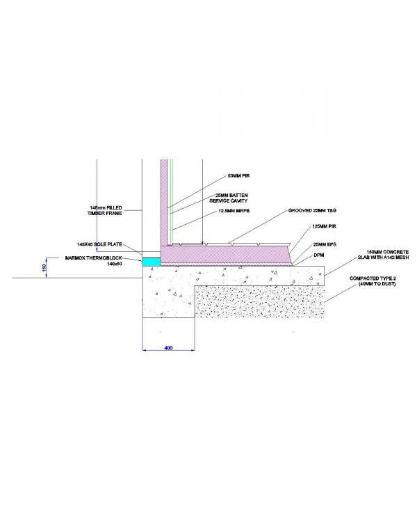

maxdavie Posted March 29, 2022 Author Posted March 29, 2022 1 hour ago, Thorfun said: can you not design it with an insulated slab? This was my original intention, but it doesn't suit my system. I appreciate this approach works well with other frame types. Here's the detail I adapted - this is from a book of Passivhaus details.

maxdavie Posted March 29, 2022 Author Posted March 29, 2022 (edited) 17 minutes ago, Thorfun said: I was talking about insulation below the slab. Yes - so was I, and that was my original intention. I don't think its going to work with my system, but I think I'll have another check with my engineers - my timber cassette would have to bear mostly onto the EPS which I can't imagine will fly. Still, worth another look as it might be the better way to do as you say. In the meantime, here's my re-designed detail incorporating comments. There is a bit of a thermal bridge there still. I'm not sure how much of an issue that will be, but I've decided to get a quote for some U-value and condensation risk analysis. Thanks again for all input! Edited March 29, 2022 by maxdavie

maxdavie Posted March 29, 2022 Author Posted March 29, 2022 28 minutes ago, Thorfun said: I don't get how your system is, in essence, any different to a SIPS panel or a twin-wall system? again to refer to MBC's drawings https://www.mbctimberframe.co.uk/passive-house/passive-wall/ Yes - you're right. There's not much of a difference. I abandoned that approach a while ago because my understanding was that doing it like that meant that you had to have inner structural timber studs bearing onto the slab and an outer 'truss' of timber - much like a Larson Truss - to increase the thickness of the whole buildup. But, maybe I jumped to a hasty conclusion - as you say, if they do it like that with SIPS..... I meet with my engineers tomo and can ask
maxdavie Posted March 29, 2022 Author Posted March 29, 2022 I'm not sure my plywood cassettes can bear partially onto the slab is what I mean - ref image below.

Thorfun Posted March 29, 2022 Posted March 29, 2022 9 minutes ago, maxdavie said: I'm not sure my plywood cassettes can bear partially onto the slab is what I mean - ref image below. ok. I guess that's one for your structural engineer.
