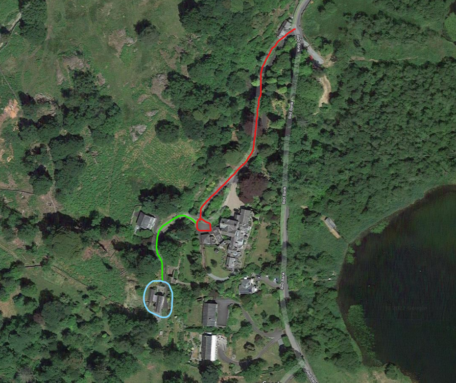

memnoch Posted March 8, 2022 Share Posted March 8, 2022 Morning all, Just after your collective thoughts on the issues of awkward site access. I'm looking to purchase an site in a few years and am trying to come to a conclusion on whether plans are possible and options. The site currently is along a narrow single lane road, 500m of moderately steep shared driveway to a flat area which recycling lorries can get up. Then another 100 metres with a 35 degree ascent and a sharp off camber 90 degree corner which is really restricted to cars and small vans. The current building isn't very good condition and could potentially gut and insulate with EWI, and refit but looking simpler to knock down and rebuild using ICF and would be annoying but easier to handball all the foam up there and pump the concrete from the flat staging area. How much of a nightmare is it going to be to demolish and get rid of the waste and excess earth from redoing the foundations? while you'd get the recycling lorry up the hill I doubt you'd get a grab lorry up there. Any thoughts on how you may achieve this, only idea I've come up with is trying to rent a corner of a field nearby and use a dumper and get the grab lorry to pick it up from there. Ralph Link to comment Share on other sites More sharing options...
ToughButterCup Posted March 8, 2022 Share Posted March 8, 2022 Hello, A map or a sketch drawing or a google maps or other online mapping reference - or a screen grab of the image produced by the mapping tool would help us help you. Link to comment Share on other sites More sharing options...
memnoch Posted March 8, 2022 Author Share Posted March 8, 2022 Not easy to show but is built on the side of a lake district fellside so steep enough that I wouldn't want to have to push a barrow up that last bit. Red line is shared driveway up to a set of garages, green is private driveway up to the house. The house was build before so should be doable but guessing they just used lots of manpower. Link to comment Share on other sites More sharing options...
