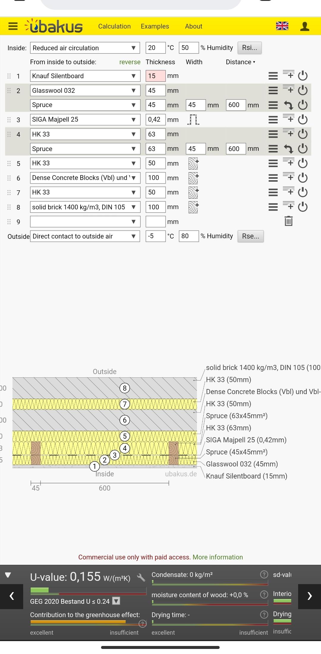

Iceverge Posted March 9, 2022 Share Posted March 9, 2022 I wouldn't bend over backwards with thermal conductivity values. The actual quality of install is more important. To get PIR exactly correct is very tricky. It's only performs to its stated K value under lab conditions. Also it's very expensive compared to mineral wool and EPS. I would get the the existing mineral wool vacuumed out of the walls. Then blow in EPS beads. Put an airtight membrane inside your framing, seal it to all windows and the floor and ceiling. Blow EPS beads behind. Insulate the service cavity with mineral wool. Then plasterboard. Over all U value of about 0.25 at a guess. It would lightly perform much closer to this rather that PIR between studs. 1 Link to comment Share on other sites More sharing options...
Iceverge Posted March 9, 2022 Share Posted March 9, 2022 Actually I've underestimated it. This is the result for 63mm studs. If you want to minimize wall thickness omit the 45mm service cavity and include a 22mm strapping instead. Link to comment Share on other sites More sharing options...
