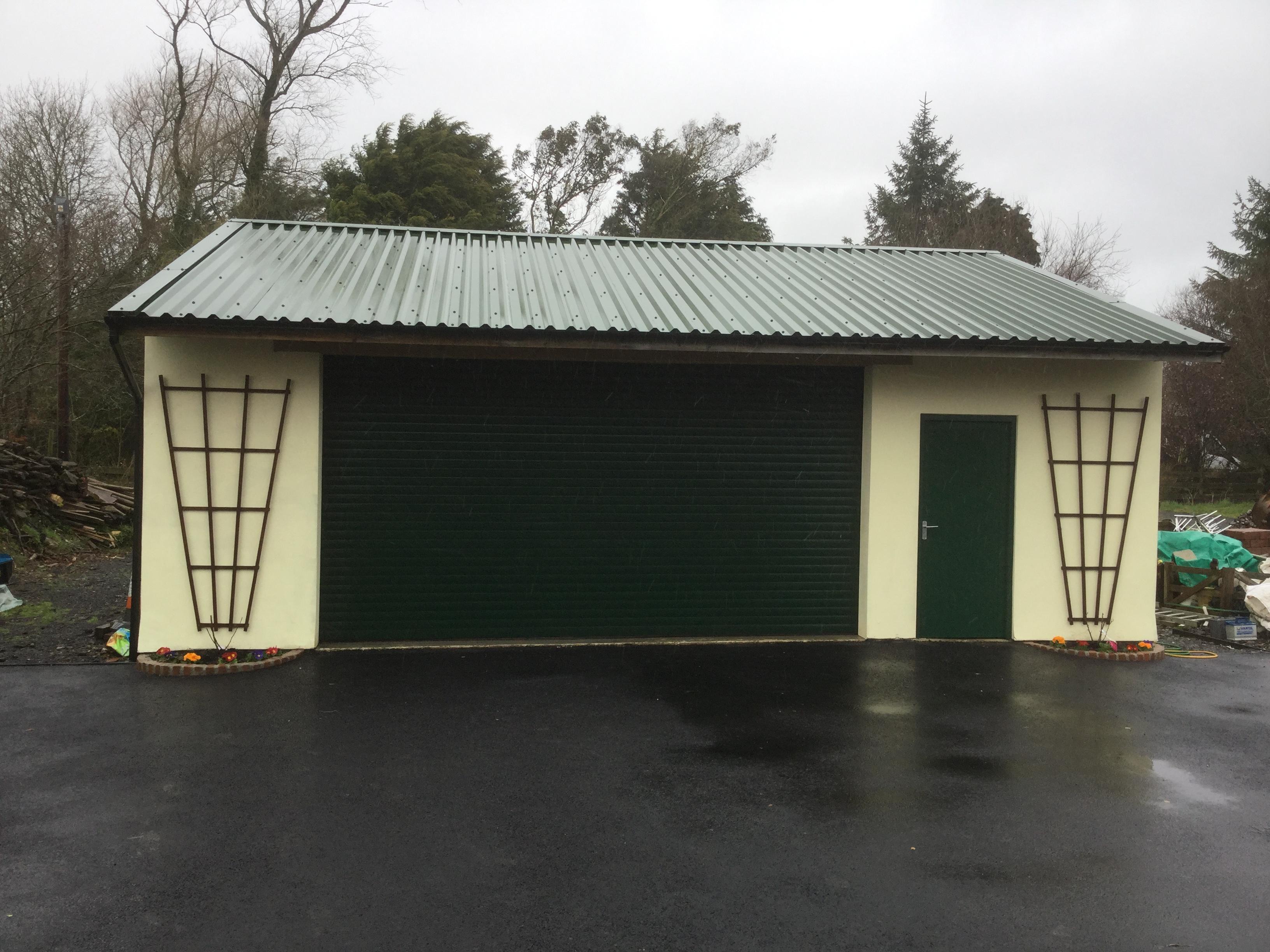

Easy to do with these, it’s what I did, the spec came with the roof trusses, although I have a 700mm overhang both sides of my garage and live in an exposed site close to the Atlantic these latest storms failed to move it 👍

Good to know, especially that the storms didn't move it. I live at the bottom of a mountain range and the house is in a dip between 2 hills, so do tend to get some wind coming through. Is your garage roof made from steel also? If so why do you have the overhang on both sides? Thanks

The overhang at the back is to store logs and at the front to stop rain driving in if I have to work with the door open. Also the overhang allowed me to build under permitted development (eaves height) and hide the roller Door mechanism higher to allow vans to get in.
Thanks, that makes a lot of sense about the overhangs and looks well constructed.
