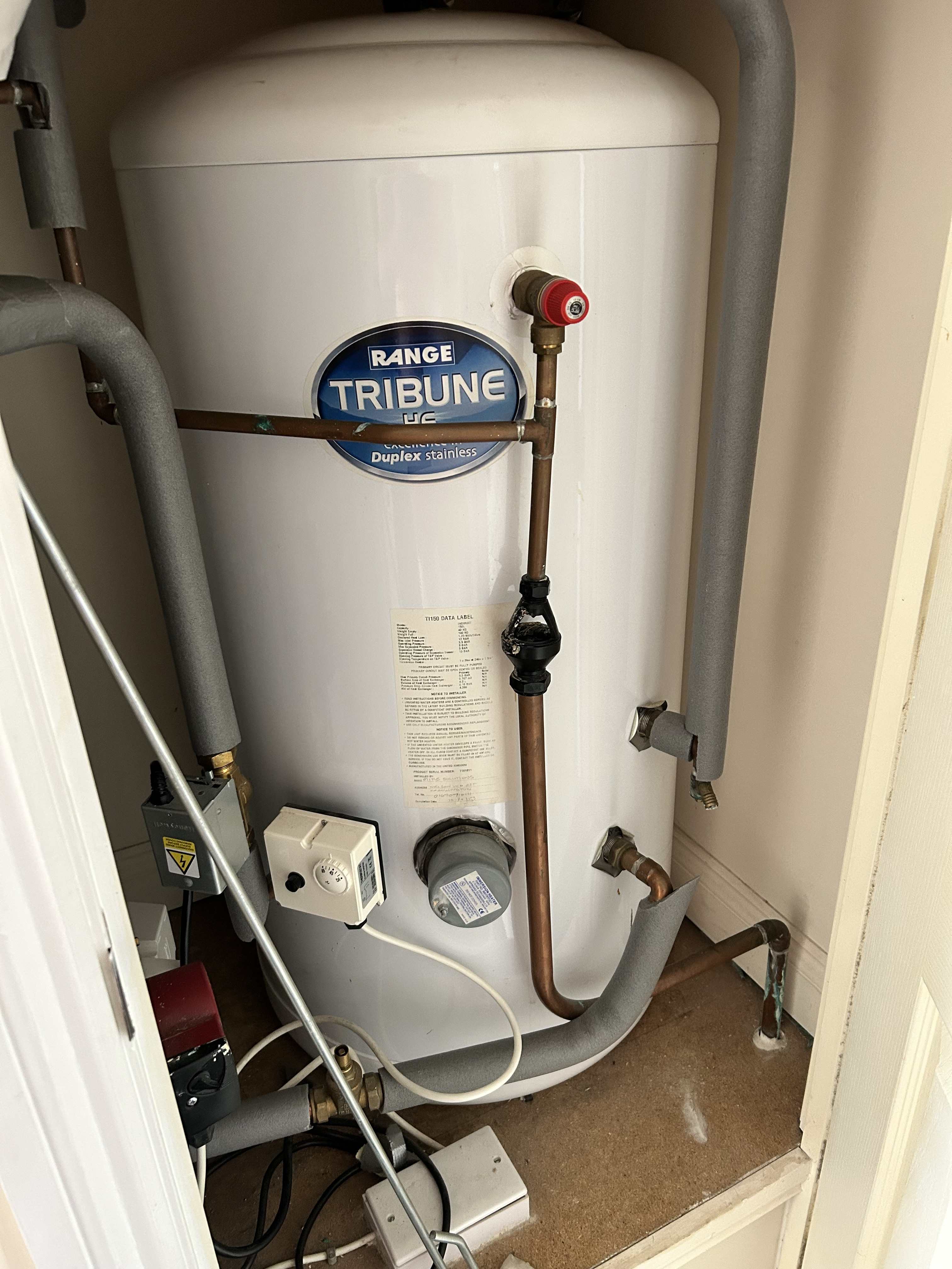

My daughter lives in a new build (Redrow, 6 years old) and has a Range Tribune HE TI150PT4. It appears to have caused a loss of pressure almost everywhere through the house. The main bath tap is barely a trickle, and some other faucets are on a stop too, with extremely limited flow throughout. It would seem from searching online that this is a known problem with this cylinder, and, that some internal part can disintegrate, causing a blocking of the system.

I would start by checking cylinder pressure - open the blow offs on the control block and the PRTV and see if you get the same pressure / flow. That will give an idea if it is flow related through the Control block. Next attach a hose to the drain valve on the inlet to the tank - same check, open it to see what flow / pressure you get as it should be full 3bar or same as cold.
If these are all good then the blockage could be in the pipework from the tank to the outlets - has the pressure and flow got worse over time ..? That could be a pig to find, and short of removing the tank and  back pressurizing the hot system to check for issues it’s going to take some serious diagnosis.

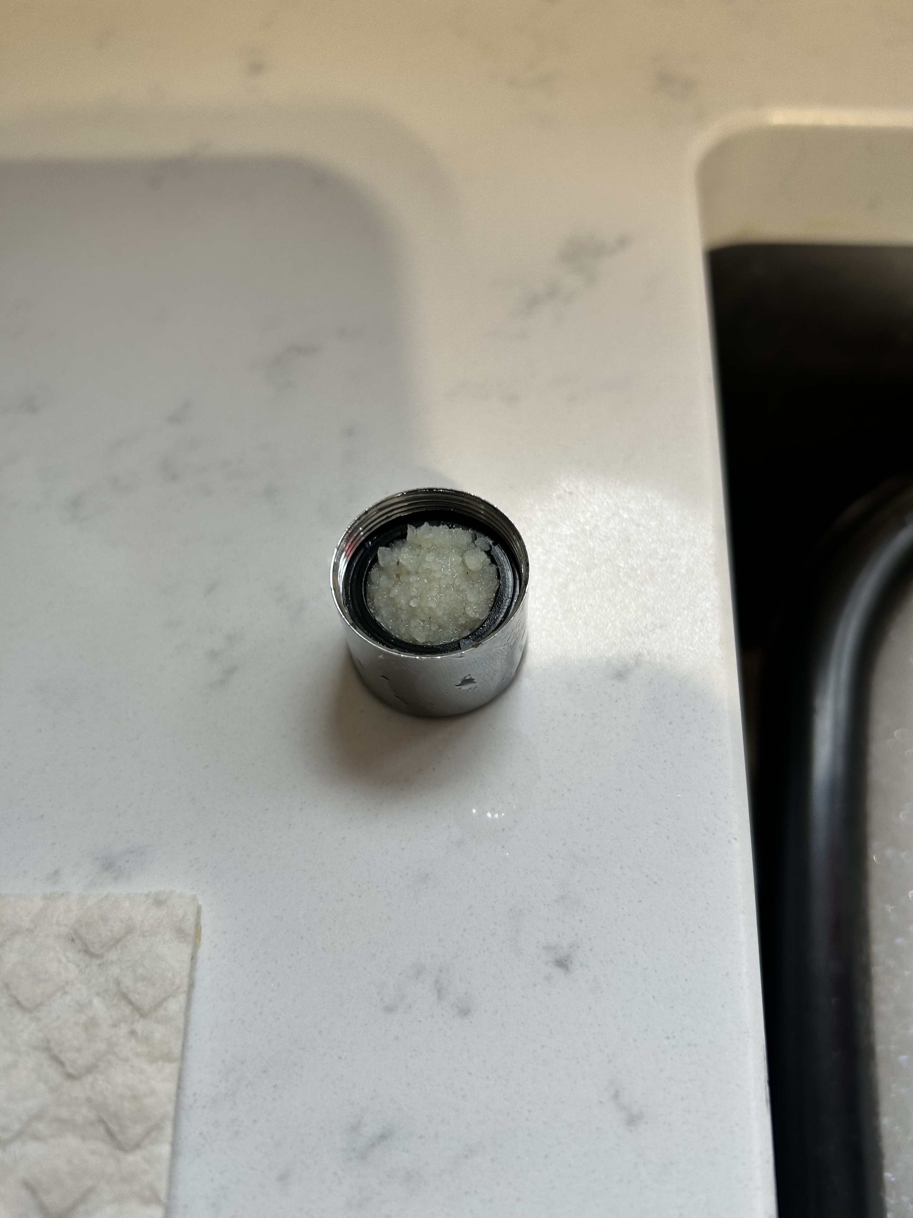

I have been getting blockage problems in recent months too. We don’t live in a hard water area and are in a modern housing estate some 15 years old. After finding mixer taps and shower becoming less effective to water flow, I decided to check the gauzes on all taps and found what seemed to be white crystals. Initially thought limescale but when tested with vinegar, they did not dissolve which leads me to some sort of plastic. Got a feeling it’s from the range tribune he water cylinder. See the amount of particles in the attached photo. Can someone please confirm my thoughts?

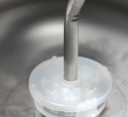

The cylinder does have a plastic diffuser at the bottom - could it be that breaking up? (I know they are prone to being blocked by limescale but haven't heard anything about them deteriorating though)
RangeTribuneHEUnventedCylinderInletDiffuserIllustration.png.823033316c7a85f041b7bfabdb3054a4.png
