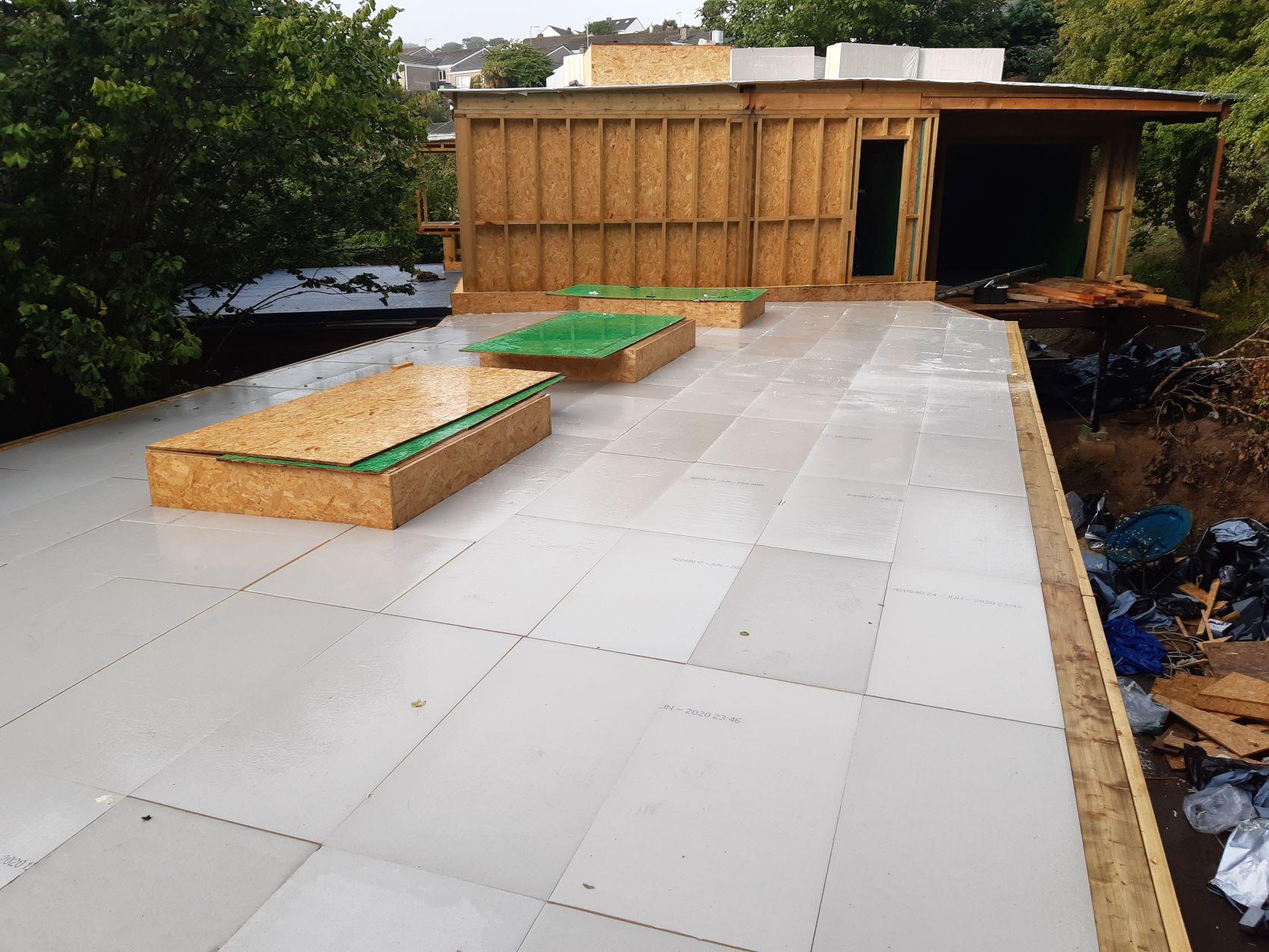

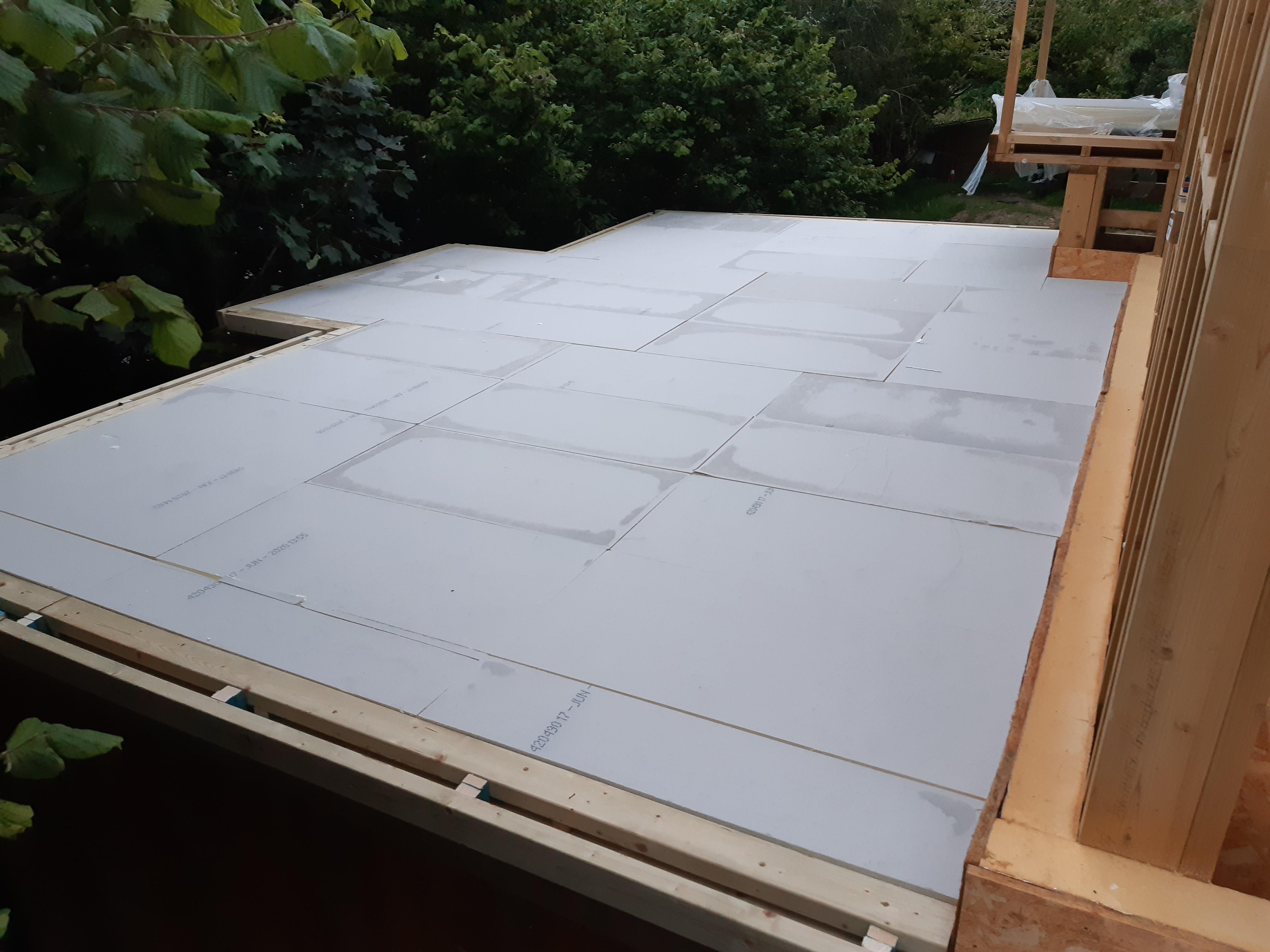

redtop Posted February 15, 2022 Share Posted February 15, 2022 1 hour ago, Dave Jones said: unless its gong to be walked on you dont need the top OSB, EDPM will glue to glass fibre backed insulation no problem. What make of vapour seal are you using ? I didn't use a top osb, did use tissue backed high compression pir for flat roofs. It still squashes a bit if you tread on a corner, hence putting the timber frame all round Link to comment Share on other sites More sharing options...
redtop Posted February 15, 2022 Share Posted February 15, 2022 14 hours ago, hotnuts21 said: This is great do you have any photos or diagrams of the buildup as you did it by any chance? I only need to overhang one side due to neighbours, but it's perpendicular to the joists which makes the ladder a bit more awkward. Love the idea of using pir below the WF so obvious but didn't think of it, even though I'm using XPS below the DPC floor in the same way 1 Link to comment Share on other sites More sharing options...
redtop Posted February 15, 2022 Share Posted February 15, 2022 1 Link to comment Share on other sites More sharing options...
redtop Posted February 15, 2022 Share Posted February 15, 2022 Should add the OSB upstand was probably more like 300mm or even a bit more. Whole thing will be a green roof, eventually ! 1 Link to comment Share on other sites More sharing options...
Dave Jones Posted February 15, 2022 Share Posted February 15, 2022 looks like your missing a vapour barrier as it should have been brought up around the skylight upstands (they need to be insulated as well) ? 1 Link to comment Share on other sites More sharing options...

redtop Posted February 15, 2022 Share Posted February 15, 2022 9 hours ago, Dave Jones said: looks like your missing a vapour barrier as it should have been brought up around the skylight upstands (they need to be insulated as well) ? Half right, and I half screwed that bit up. Vapour Barrier in, but didn't bring it up roof lights so ended up insulating from inside. Not ideal... Link to comment Share on other sites More sharing options...
