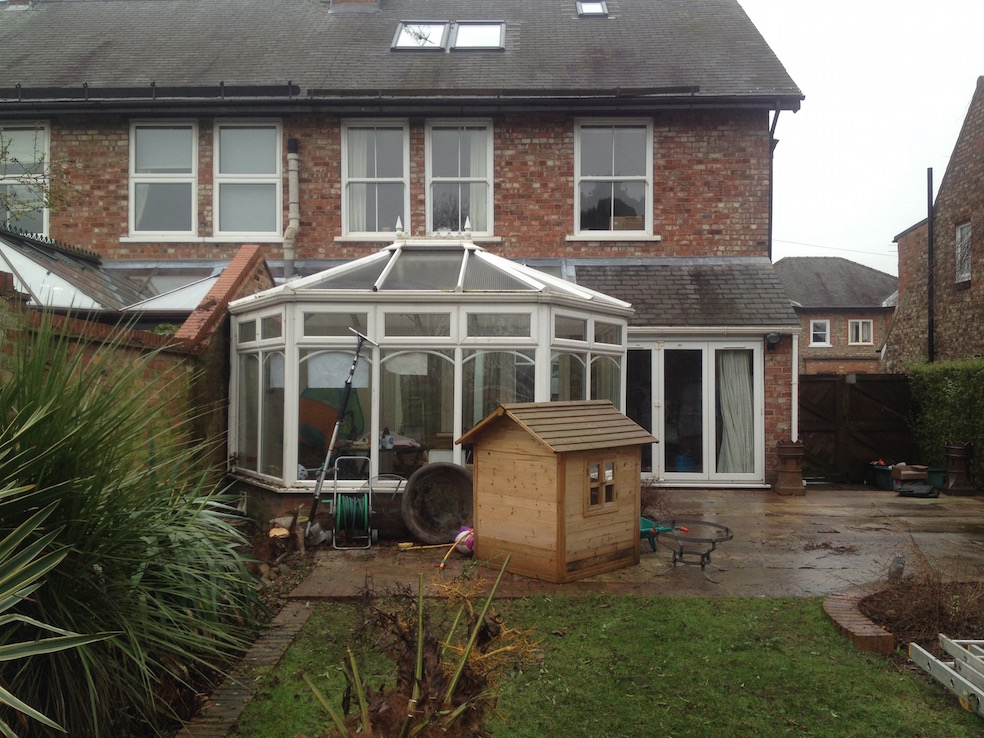

I am planning on doing a small single story extension on the back of my house.

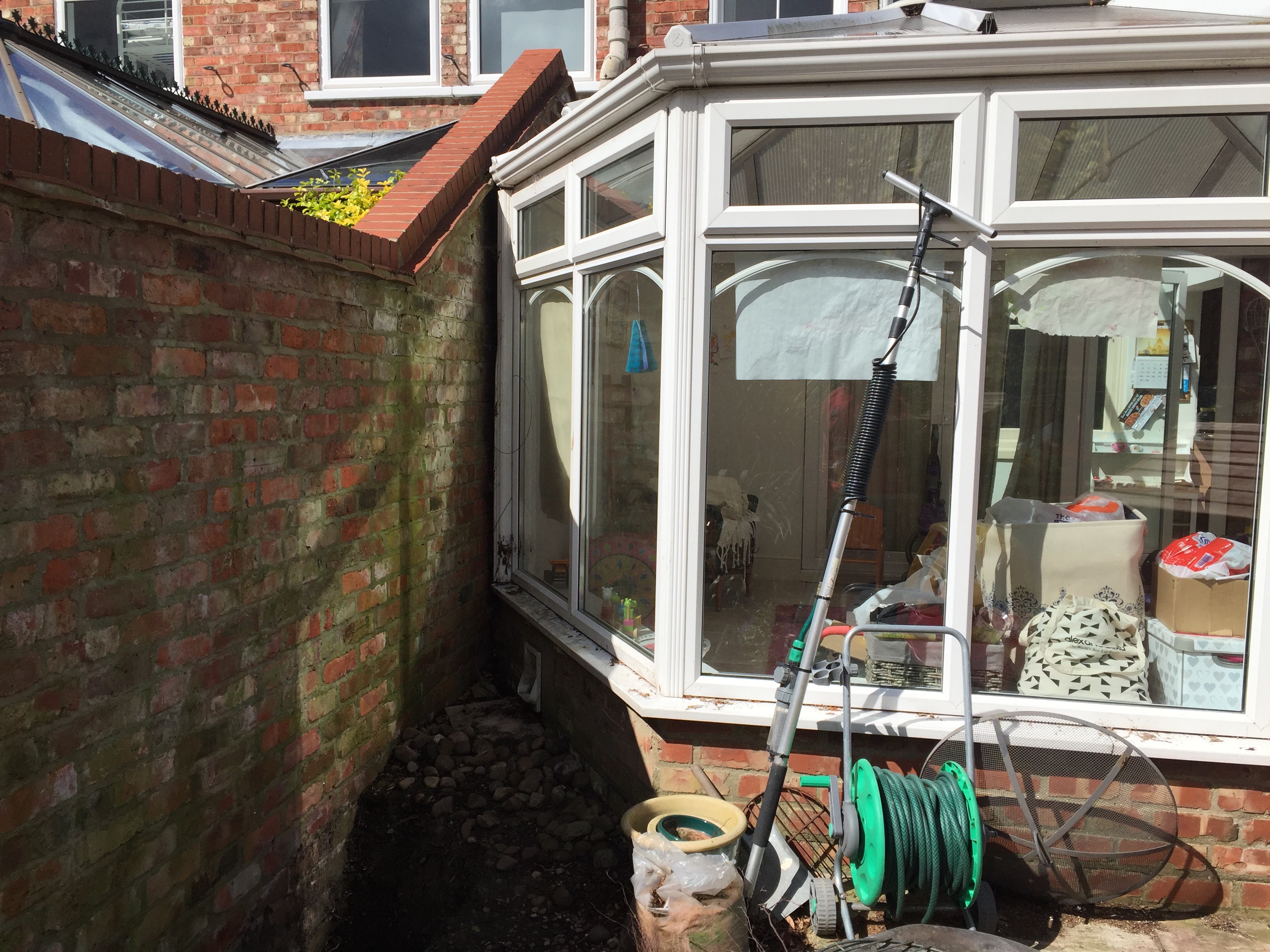

Our house is a semi and i won't be building on the dividing walls of the houses or the neighbours garden wall which is 1.8m high.
I will be building about 200mm away from this wall, so the foundation will be touching this walls foundation i imagine (if i go to the same depth which is currently 700mm as done a trial pit).

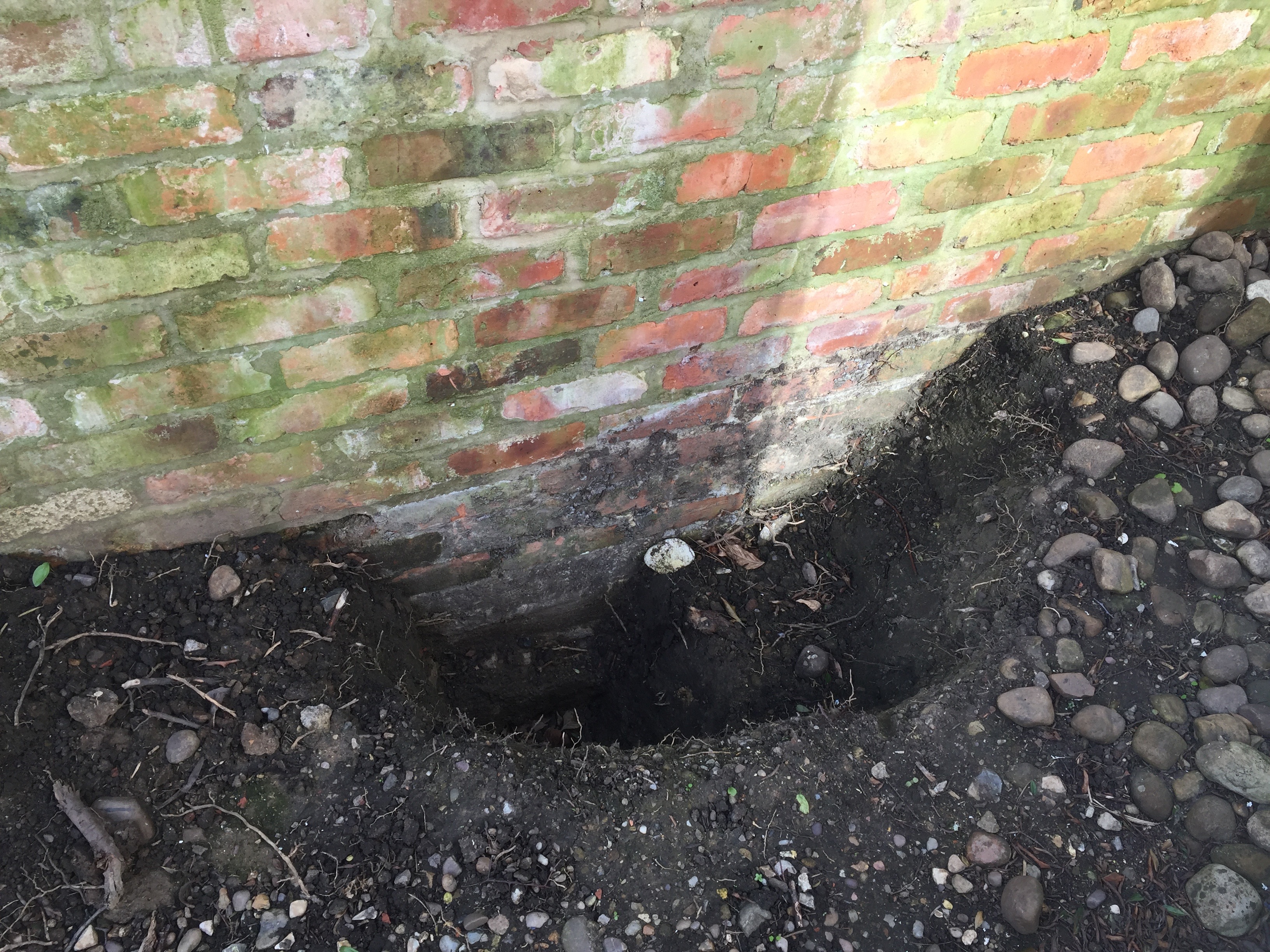

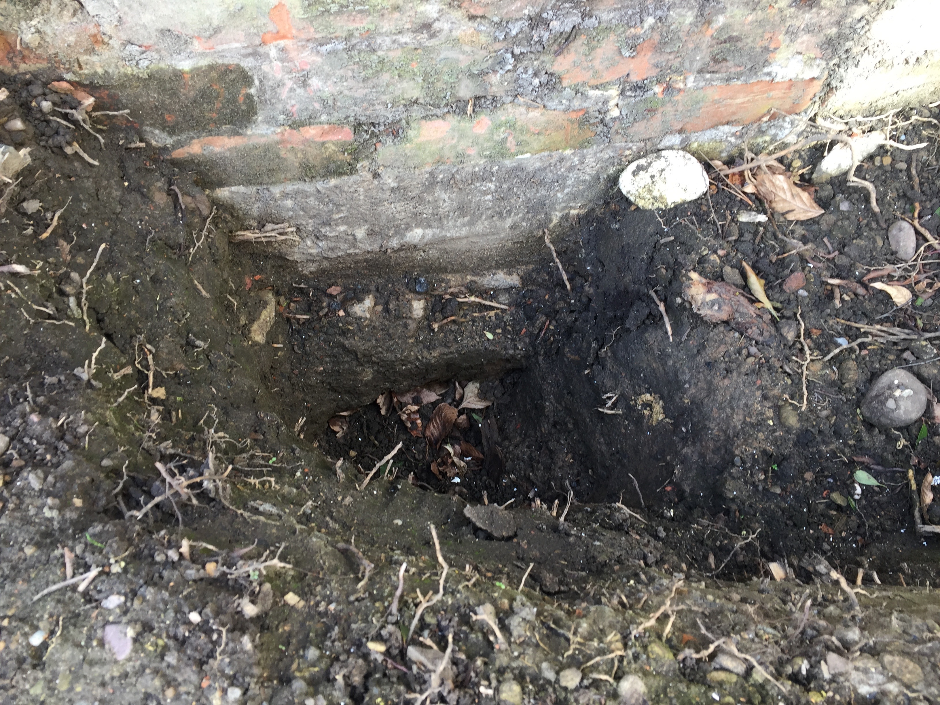

1) Is it ok to excavate down the side of this wall the full way which will be 4.5m.  Going no deeper than the current footing.  I have done a trial pit and it seems the wall has been built on a thin concrete base and then the bricks have been used to build up the foundation.  I have a photo inc.  The extension comes to the end of the current conservatory which will be going.

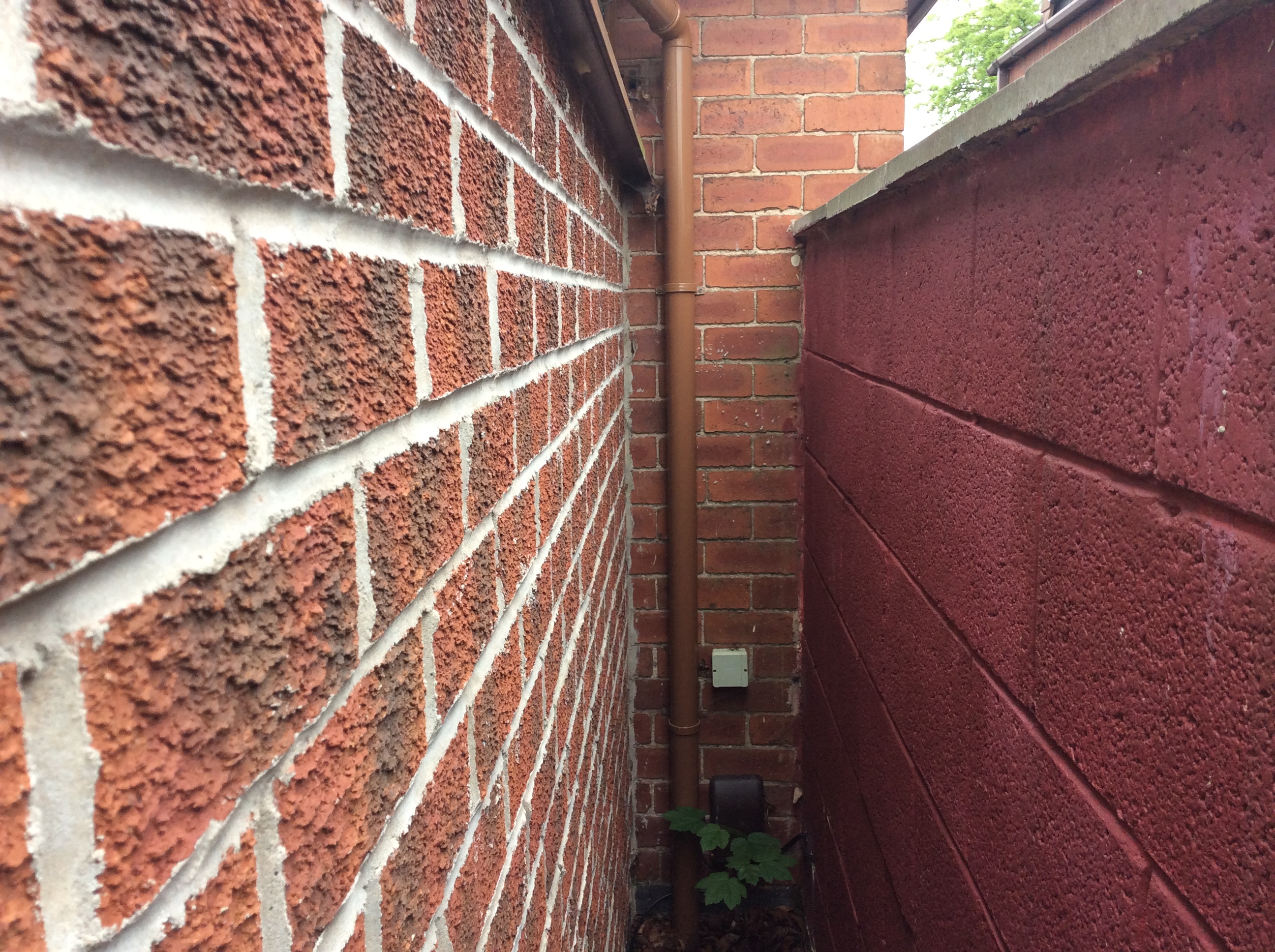

I will leave others to comment on the PWA aspect, but I question that 200mm gap you are suggesting. That seems to me to be the wrong width because it is not easily maintainable:
1 - ISTM that there is not space for you or  your builders to build it tidily (bloke plus trowel and room to work is more than 200mm). For such a narrow gap you or your builders will be working overhand (ie from the inside) which will make your new wall a probable mess.
2 - Once it is built it will be impossible to maintain your wall and the ground in the gap. eg What will you do when it fills up with autumn leaves which bridge the damp proof course, or should building work ever be required down there,or if a child gets stuck, or if you or your neighbour get rats and the ratman needs access?
My suggestion is that the gap should either be zero, or at least 450mm (= 18 inches), which is just wide enough to get in to sweep out etc. 600mm seems to me to be more sensible, as you can then do something with it such as ladder storage etc.
The only exception I would make would be where your gap is short enough that you can reach down it with your arm plus a sweeping brush, rake etc. and reach the end.
I would suggest reducing the width of the extension by 300mm to make the gap wider. You can recover much of any lost inside space by using a thinner design of wall ... eg by using Celotex rather than Rockwool insulation. Alternatively talk to your neighbour about butting right up - even if you are not needing the PWA it is good to talk unless there is a good reason not to do so.

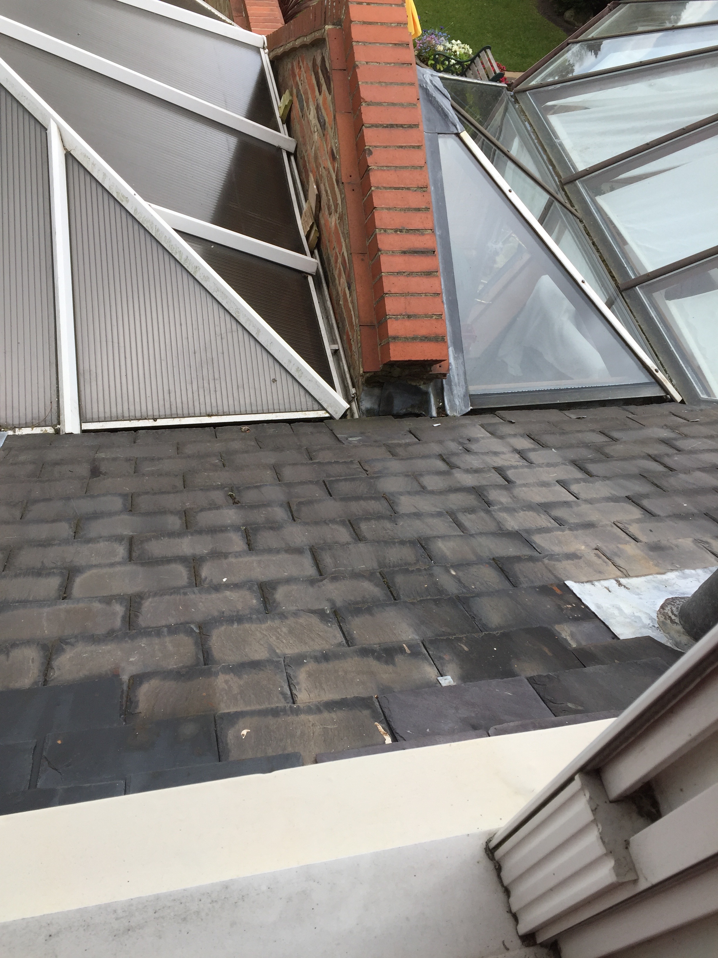

The issue then will be the change over at roof level where i break away from our shared tiled roof (original lean to).  Both our lean to's are slate roof and glass.  The middle section can't be seen very well, but it is slate.  My new flattish roof in fibreglass will be built over the tiled/glass roof i currently have and extend out to where the conservatory sits and also fill in to the right.
His slate roof will stay and run into my new brick wall which will be built upwards.  I will then use a flashing to connect into the wall.  The wider gap will mean i now need to provide some form of drainage for this very narrow section of roof as it will be draining into the gap.  Here is another photo to show you how the current drains work now.  I have a boxed in drain hidden by the conservatory currently, but this will come down obviously. My neighbour has an overflow drain if needed at the base of the brick coping.

Ok, but if i do go for a 450mm void do you think i could build the outer leaf ok ?  Working in that gap.
