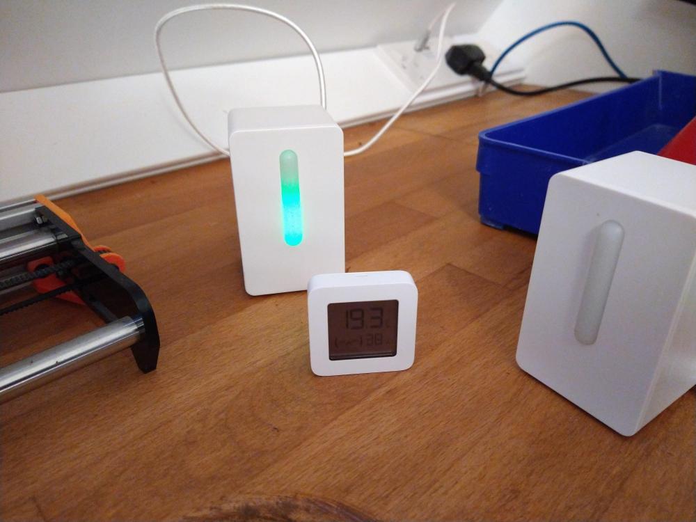

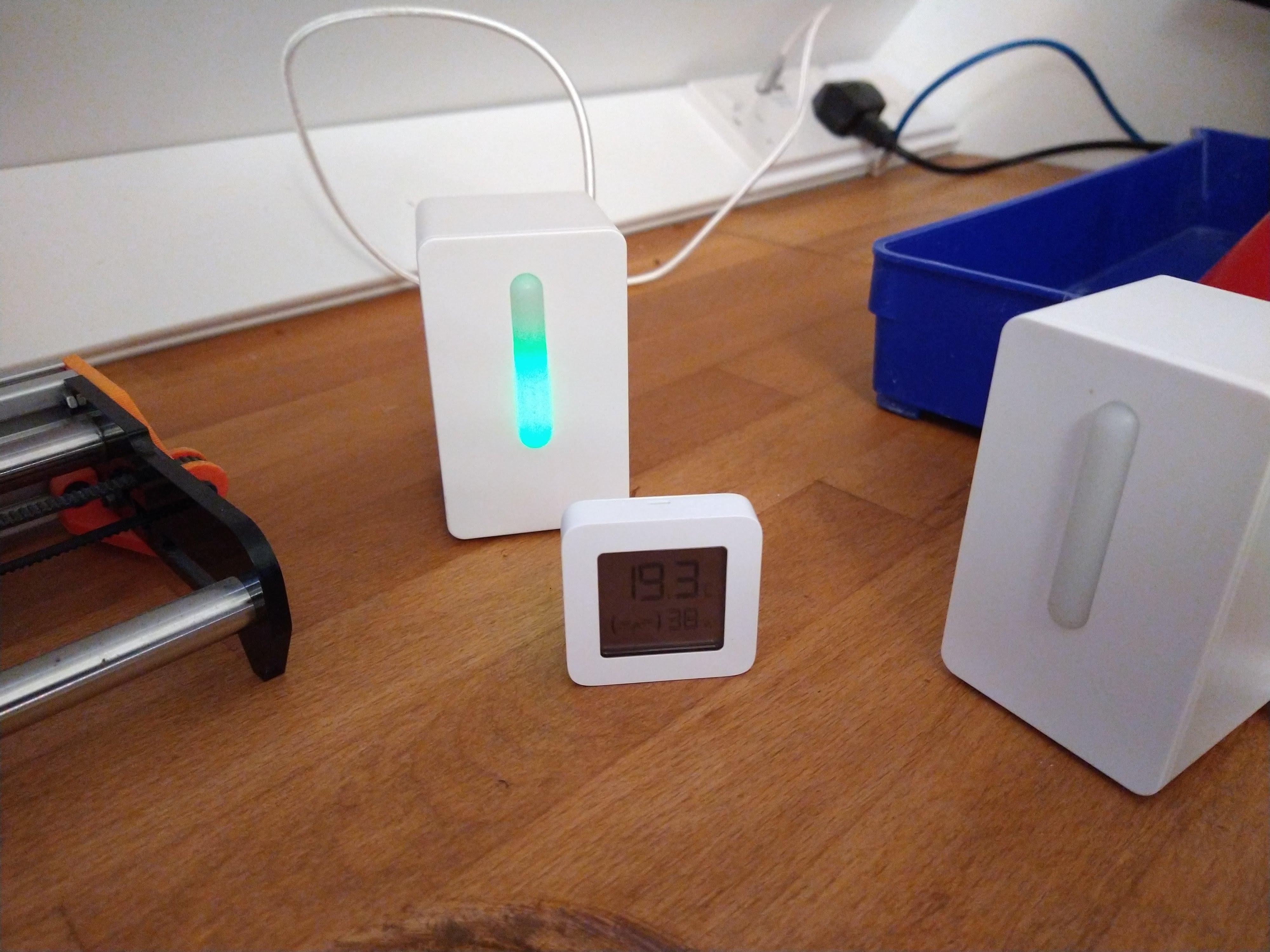

XIAOMI Thermometer next to a couple of IKEA VINDRIKTNING
The VINDRIKTNING (or 'wind direction' translated) has a USBC port round the back and three LEDs giving a crude 'traffic light' readout of air quality. People have already hacked these to extract the sensor data and relay it over WiFi  as MQTT for integration into Home Assistant or whatever. This struck me as an ideal 'base station' for my XIAOMIs while at the same time providing air quality data and anything else I could squeeze inside the box along with the ESP32.

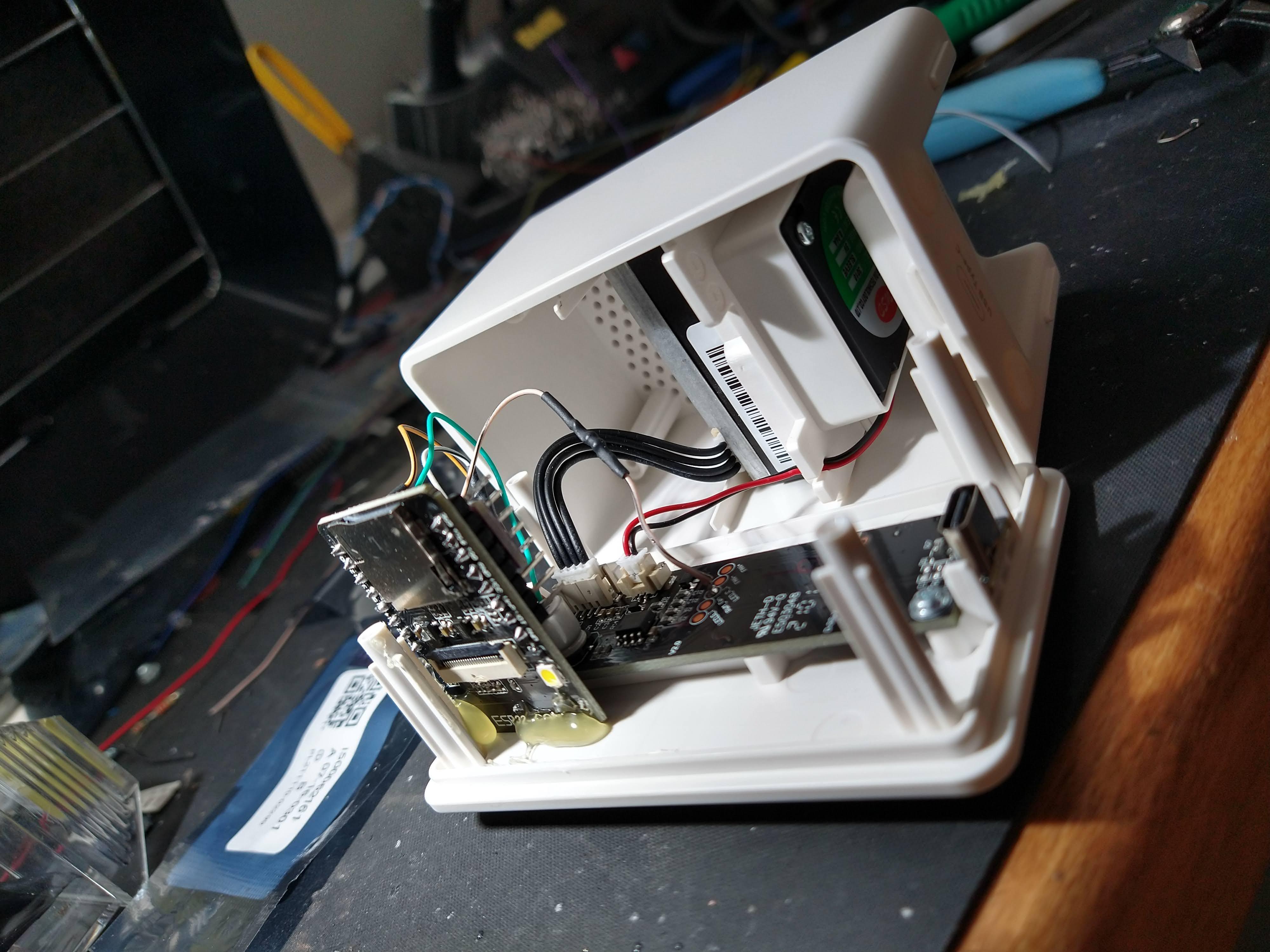

ESP32-CAM wired to IKEA VINDRIKTNING PCB
ESP32 dev. boards tend to be a little bit bigger than ESP8266 so I had a job finding one that would fit. Oddly enough, the cheapest proved to be the ESP32-CAM which actually comes with a camera! As for getting more value out of the modification I also mounted a BME280 module on the ESP32 to provide temperature/humidity/barometric pressure as well as PM2.5 data from within the base station. Oh, and there's a light sensor that VINDRIKTNING uses to dim the LEDs so I fed that into an analogue input. There's also enough room in the box for a CO2 sensor but I've yet to wire that in. Unfortunately these additional sensor use some of the camera connections so a sneaky CCTV from this device wouldn't be possible when fully loaded with sensors.

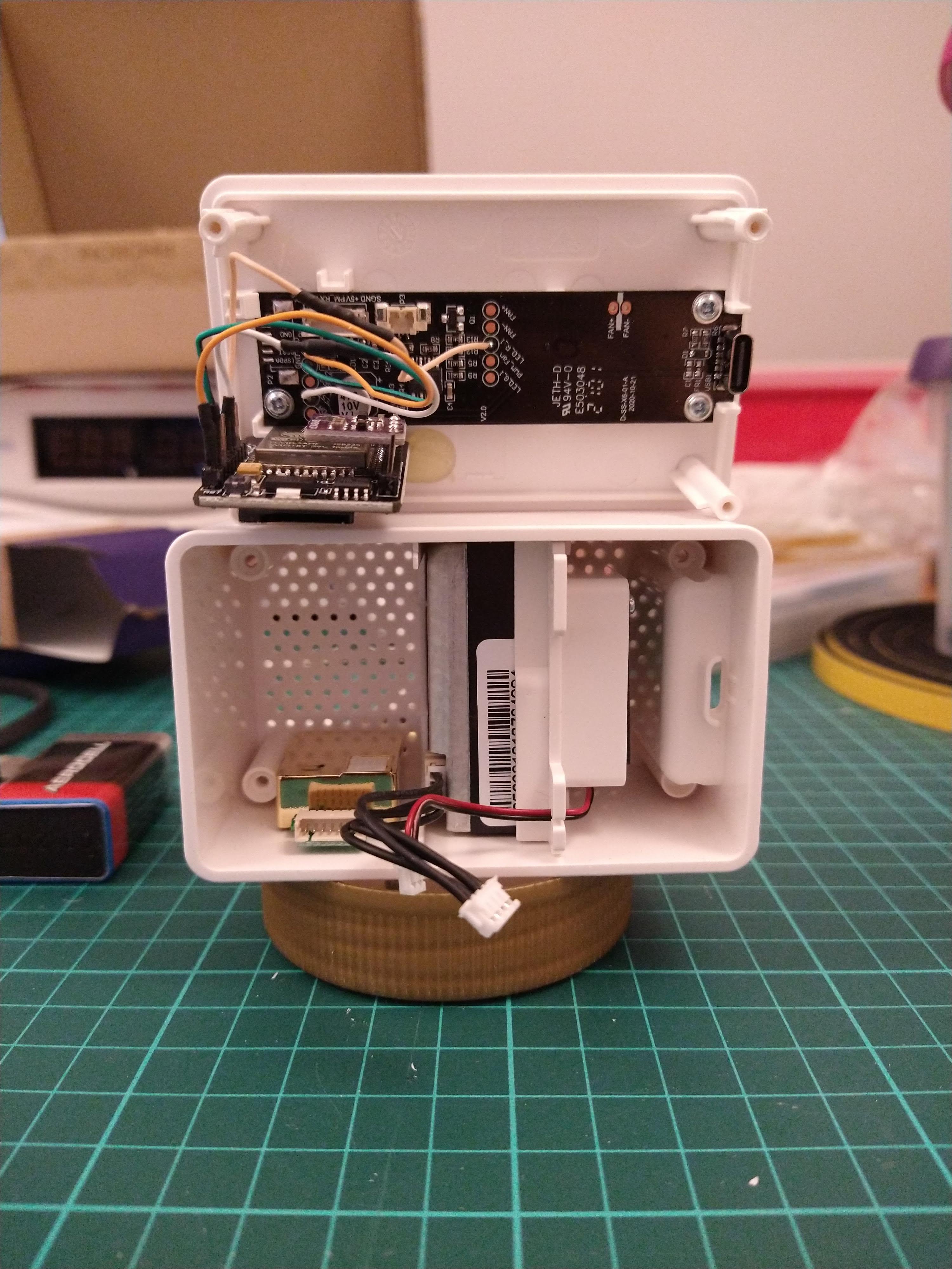

CO2 sensor at the bottom left of the enclosure
The end result is a base station providing air quality measurements costing <£20 that can host numerous ~£6 thermometers.

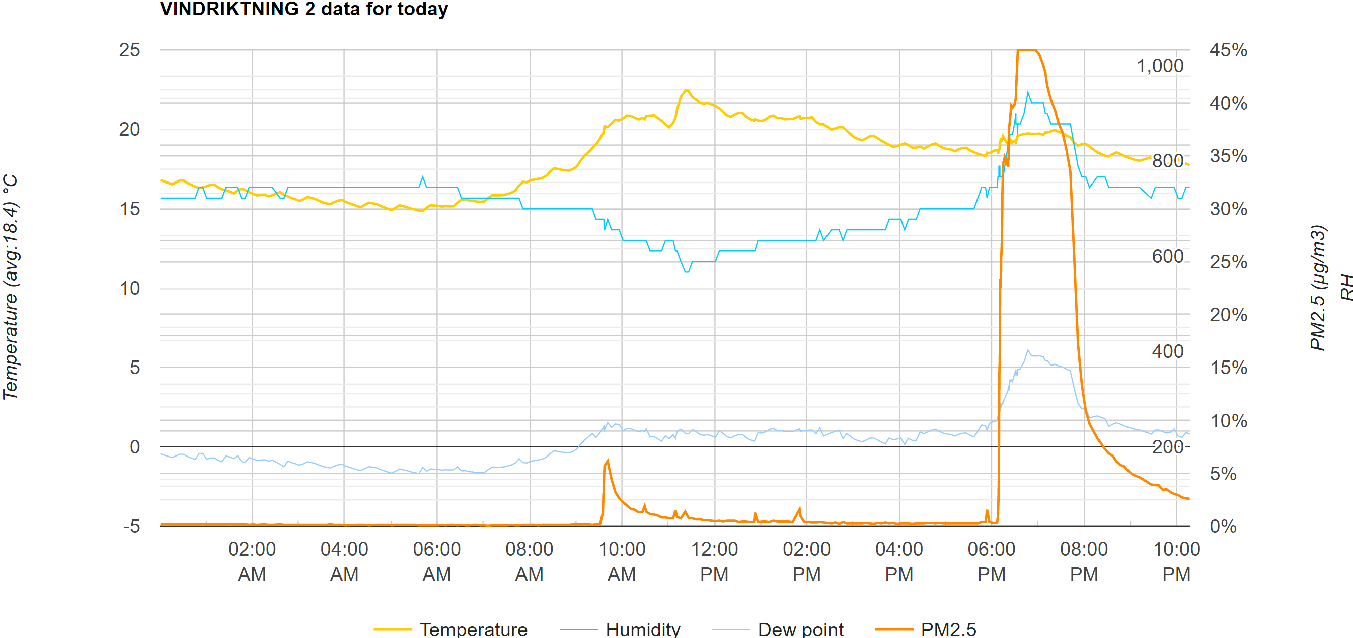

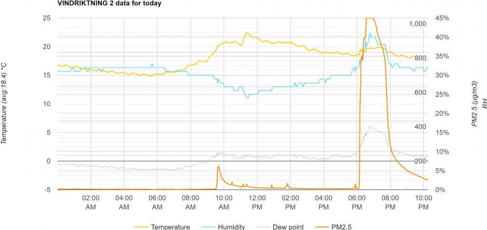

So today we lightly browned some toast mid-morning and accidentally burnt flatbreads while making supper:
1912128964_Screenshot2022-02-0322_22_21.thumb.png.b37247cfb3b2d43ec2267bea25a137b1.png
This base station is currently in the garden room, off the kitchen, next to a sliding patio door so the temperature swings quite a bit. However, In this position it picks up a thermometer about 20m away in the back garden, one inside the fridge and another in the kitchen. Those show up in different plots. Here is the barometric pressure and light level:

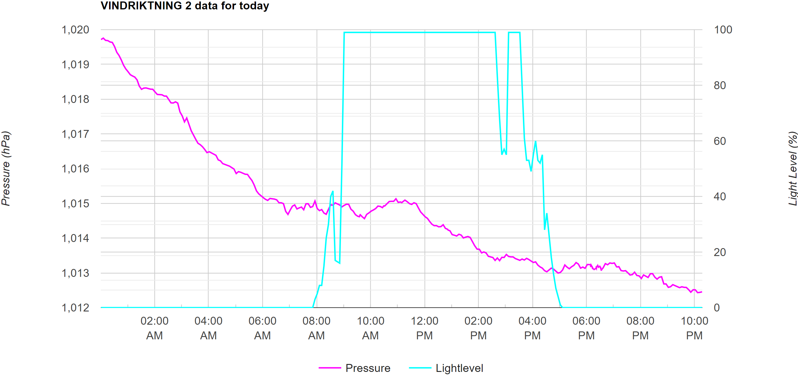

654442517_Screenshot2022-02-0322_22_48.thumb.png.6adf149e6d46b75eaa8b3938c18f087f.png
I really need to get to grips with MQTT as I collect quite a bit of data.

BME280 temperature and humidity are handy but need calibrating. They're incidental to the corrections needed for the barometer so not fabulously accurate. I also got caught out by self heating. I thought the fact that VINDRIKTNING pulls air through with a small fan would improve the sampling but the ESP32 is drawing around 0.25W and this still bumps the temperature up a few degrees. Fortunately it's a pretty constant offset so easy to subtract.
