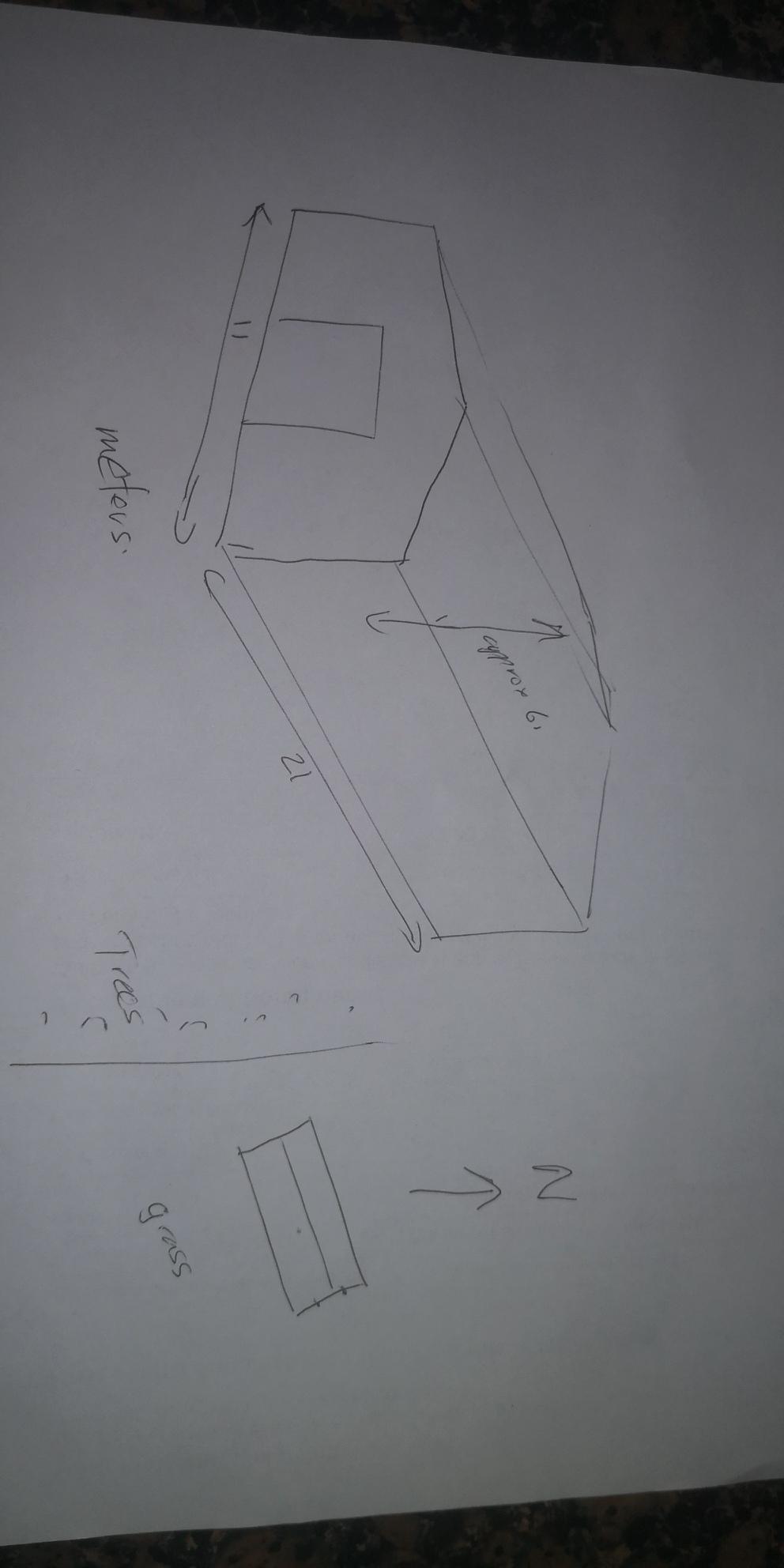

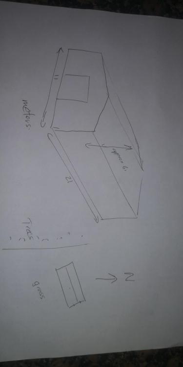

Roger440 Posted February 1, 2022 Author Share Posted February 1, 2022 16 minutes ago, SteamyTea said: Right, let us get serious about this. Rough sketch of the place, with dimensions and roof angles. Compass orientation as well. Any chance of a wind turbine? https://windempowerment.org/the-piggott-turbine/ Ok, here you go. Dont know roof angle exactly, but very shallow. Typical modernish ag building. I think the wind turbine would be pushing it. Way to visible. Someone will complain. Some will complain about anything. Ground based solar is potentiall possible. Maybe. Link to comment Share on other sites More sharing options...
Roger440 Posted February 1, 2022 Author Share Posted February 1, 2022 13 minutes ago, joe90 said: Just as an aside, how many months a year will you need this heating? When its cold. So October to April at most. No requirement outside of that. 1 Link to comment Share on other sites More sharing options...
SteamyTea Posted February 1, 2022 Share Posted February 1, 2022 (edited) So you got about 100m2 of almost south facing roof. When you get some time, find a sheet of something, insulation would be best. Get up in the eves and fit it 200mm below the inner roof. Seal all the edges, cut a hole at the top and the bottom for a small bathroom fan, wait till it is sunny, pump some air though and see what happens temperature wise. If you can capture 50W.m-2, that is 5 kW. Going to be up your way, again, again, come the weekend. Edited February 1, 2022 by SteamyTea Link to comment Share on other sites More sharing options...
Roger440 Posted February 1, 2022 Author Share Posted February 1, 2022 7 minutes ago, SteamyTea said: So you got about 100m2 of almost south facing roof. When you get some time, find a sheet of something, insulation would be best. Get up in the eves and fit it 200mm below the inner roof. Seal all the edges, cut a hole at the top and the bottom for a small bathroom fan, wait till it is sunny, pump some air though and see what happens temperature wise. Going to be up your way come the weekend. Yes, its quite large. But those trees are tall. So in winter the roof loses the sun quite early. Nice idea. Will need to try that. Wonder what that will produce?. Are you popping in for a cup of steamy tea? 2 Link to comment Share on other sites More sharing options...
SteamyTea Posted February 1, 2022 Share Posted February 1, 2022 (edited) 4 minutes ago, Roger440 said: Nice idea. Will need to try that. Wonder what that will produce It is close to what I did for my BSc, about time someone tried it out. I even had a cheap storage device. 4 minutes ago, Roger440 said: Are you popping in for a cup of steamy tea Can do, what is your nearest town? 4 minutes ago, Roger440 said: But those trees are tall Not may leaves in winter. Edited February 1, 2022 by SteamyTea Link to comment Share on other sites More sharing options...

SteamyTea Posted February 1, 2022 Share Posted February 1, 2022 What is the roof and walls made from? Link to comment Share on other sites More sharing options...
Onoff Posted February 1, 2022 Share Posted February 1, 2022 Just now, Roger440 said: It does. Ive been reading up. Looks like a doddle to do too. Minimal cost effort. Screen collectors are possibly easier than cans. Why not build one as a test bed? Link to comment Share on other sites More sharing options...
Roger440 Posted February 1, 2022 Author Share Posted February 1, 2022 1 minute ago, SteamyTea said: What is the roof and walls made from? Roof is CGI. Walls block, then cladding. Link to comment Share on other sites More sharing options...

SteamyTea Posted February 1, 2022 Share Posted February 1, 2022 1 minute ago, Roger440 said: Roof is CGI. Walls block, then cladding. Seems most of the work is already in place. Just a case of trapping some warmth and shifting it about. Link to comment Share on other sites More sharing options...
