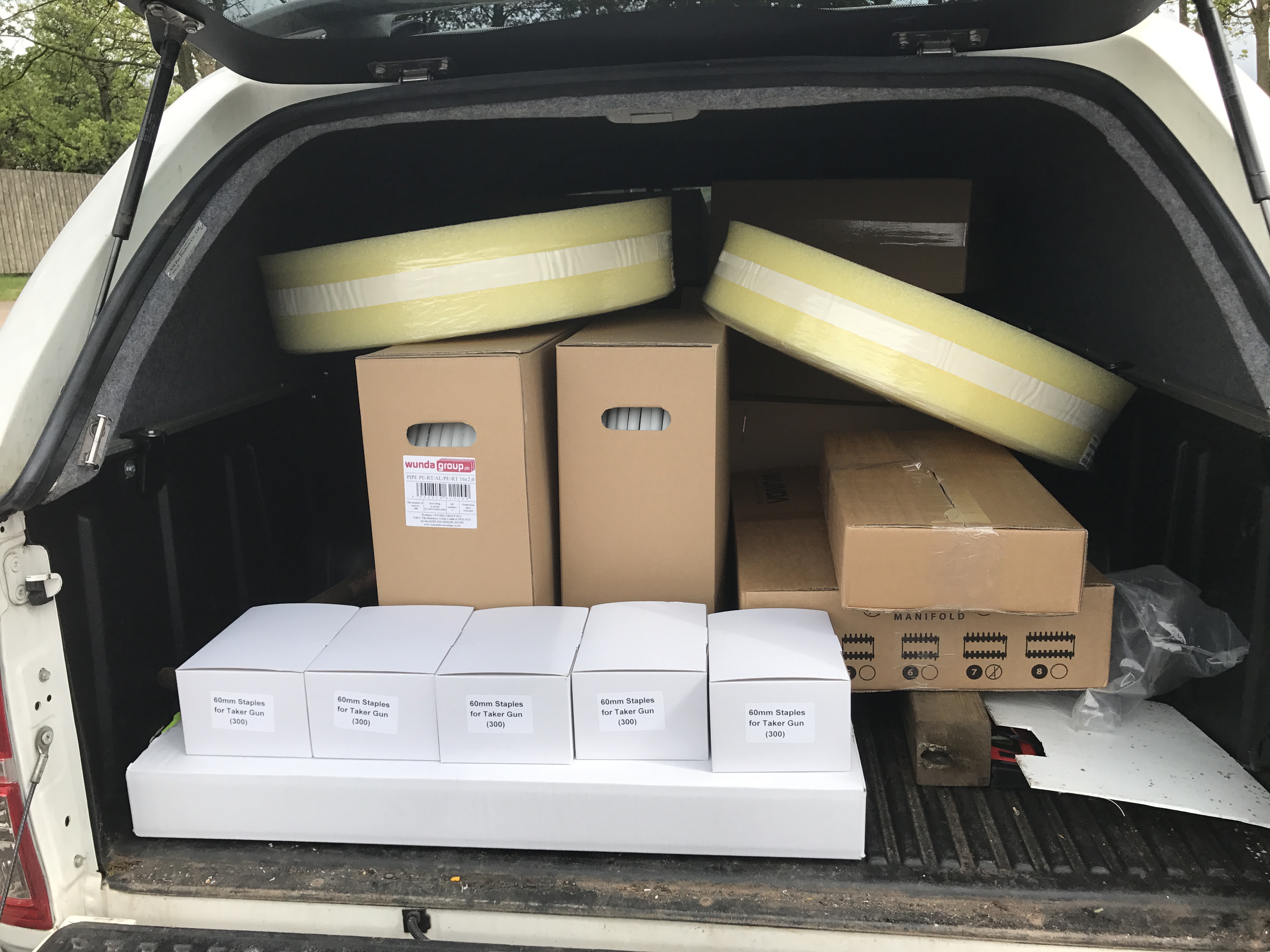

Jimbouk Posted April 24, 2017 Share Posted April 24, 2017 So I had a trip to Wunda Trade today and now have a hilux full of ufh pipework and associated gubbins... We are using the staples to attach to the celotex or rather the membrane over the top and into the celotex. Just wondering if all the celotex slabs should be taped as well, or is that just over kill? Going to be using a dry screed. Link to comment Share on other sites More sharing options...
CC45 Posted April 24, 2017 Share Posted April 24, 2017 We taped all ours. Easy and not especially costly to do now. I assume you've got some plastic to cover them before laying the ufh pipes. Cc Link to comment Share on other sites More sharing options...
Jimbouk Posted April 24, 2017 Author Share Posted April 24, 2017 Thanks, think we might as well tape it, what gauge plastic did you put over the top? Link to comment Share on other sites More sharing options...
