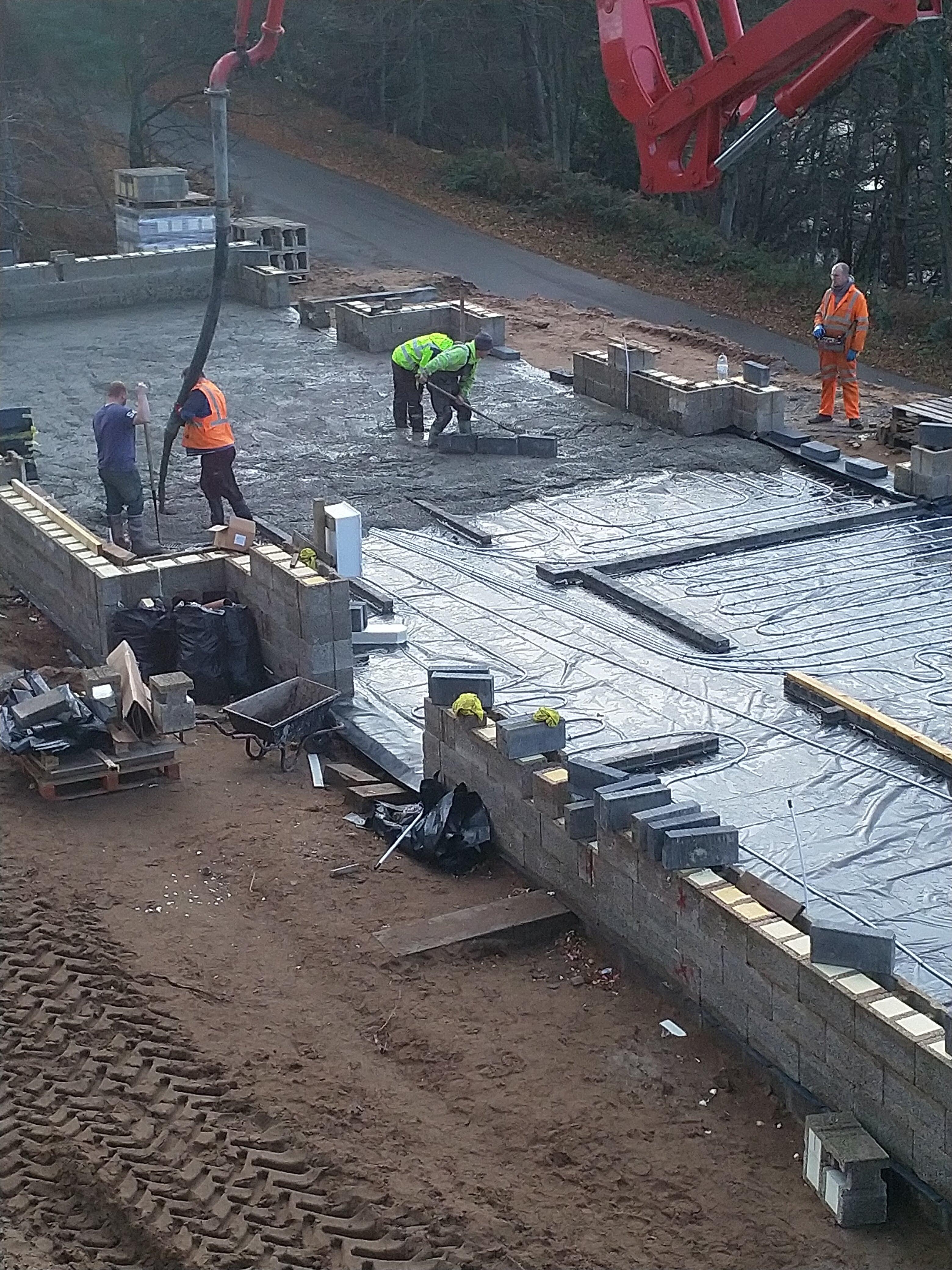

JohnMo Posted January 12, 2022 Share Posted January 12, 2022 The PIR upstand will be your expansion strip, you don't need a further expansion strip. You put polythene / DPM over the PIR only to stop a chemical reaction between the aluminium foil and the cement in the screed. I cut it flush with top of screed after the pour. The order my floor was build. Finished floor went in prior to the walls, on our build. DPM Structural steel re-enforced concrete slab. 200mm, in two layers of PIR, with 70mm upstand Thin black polythene. Staple UFH piping to PIR through poly sheet. Instead of screed, I have C34 fibre re-enforced concrete above the insulation/UFH pipes, 100mm thick. Link to comment Share on other sites More sharing options...

JohnMo Posted January 12, 2022 Share Posted January 12, 2022 We don't seem to have any issues. My thought process was. You pour the concrete, it fills the space fully, as it drys the concrete shrinks, you heat the house, the concrete expands to fill the gap. Plus that what the architect and structural engineer had on the drawing. Our longest run of floor is about 13m. Link to comment Share on other sites More sharing options...
