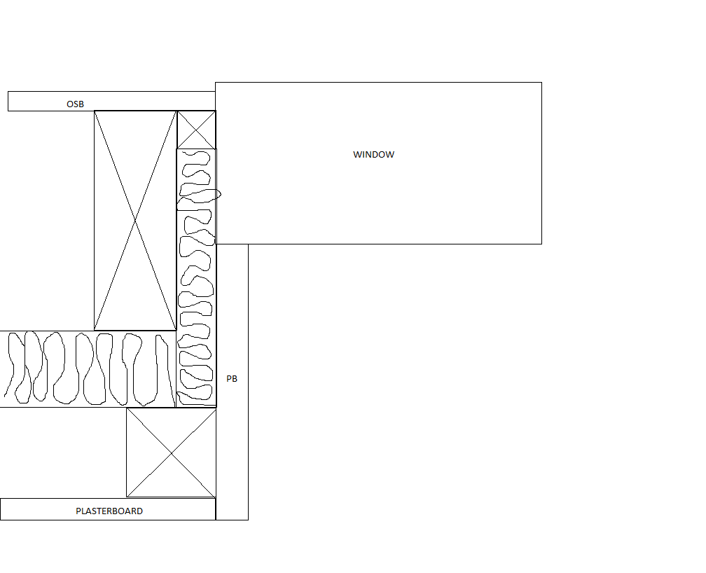

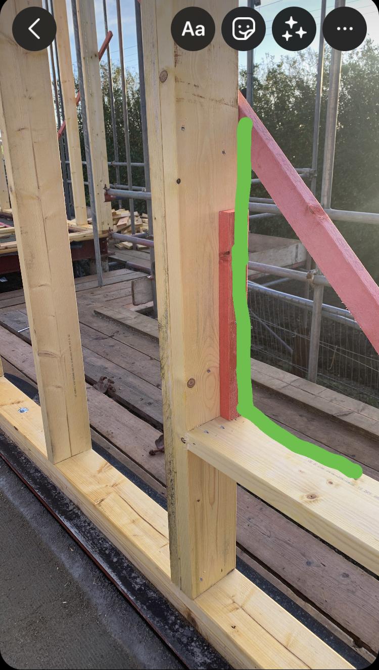

DragsterDriver Posted January 7, 2022 Share Posted January 7, 2022 Good morning I’m pondering window reveal insulation and whether I should form a ’checked’ type reveal so the insulation can return up to the window if that makes sense? walls will be 140mm frametherm, 50mm pir, airtight layer then battens. thanks! (Green squiggle is window) Link to comment Share on other sites More sharing options...
Hobbiniho Posted January 7, 2022 Share Posted January 7, 2022 (edited) What is typical up here is for a 25x25mm batten to be fitted to the inside of the kit (at the outside) the window then sits on this and you can put 25mm PIR on the reveals and tape them to the internal PIR/ window to complete your airtight barrier, this relies on the window openings being made big enough though, your frame is already up so i think you will struggle to fit insulation in the reveals as there will not be enough room around the window Edited January 7, 2022 by Hobbiniho add pic 1 Link to comment Share on other sites More sharing options...
DragsterDriver Posted January 7, 2022 Author Share Posted January 7, 2022 8 minutes ago, Hobbiniho said: What is typical up here is for a 25x25mm batten to be fitted to the inside of the kit (at the outside) the window then sits on this and you can put 25mm PIR on the reveals and tape them to the internal PIR/ window to complete your airtight barrier, this relies on the window openings being made big enough though, your frame is already up so i think you will struggle to fit insulation in the reveals as there will not be enough room around the window thanks! that’s what I had in mind- I’ve framed out but not sheathed the walls or ordered the windows yet Link to comment Share on other sites More sharing options...
Russell griffiths Posted January 7, 2022 Share Posted January 7, 2022 As the other bloke said, why not make rough openings 70mm larger than windows 25mm insulation both sides and 10mm wiggle room and foam. 1 Link to comment Share on other sites More sharing options...
DragsterDriver Posted January 8, 2022 Author Share Posted January 8, 2022 19 hours ago, Russell griffiths said: As the other bloke said, why not make rough openings 70mm larger than windows 25mm insulation both sides and 10mm wiggle room and foam. so my tile batten idea wasn’t crazy Link to comment Share on other sites More sharing options...
