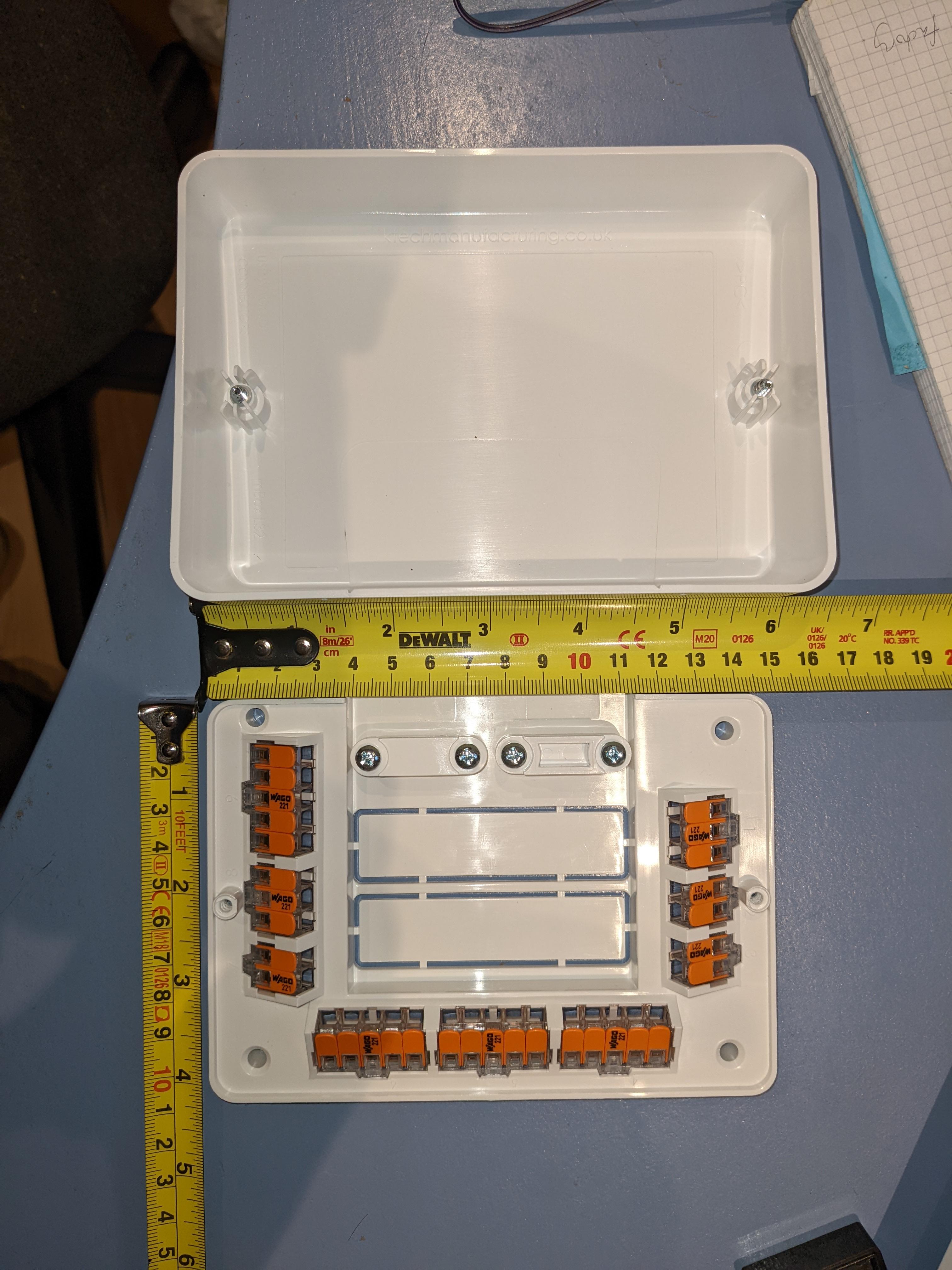

Looking for internal dimensions of Wago wiring center (L32 L60)
Anyone got any of these and could post a picture of it with a tape measure up against?
https://www.tlc-direct.co.uk/Products/WAL32.html
https://www.tlc-direct.co.uk/Products/WAL60.html
Context is I'm looking for a small enclosure for ESP32 microcontroller, with captive terminal block (for easy wiring peripherals in, like 1-wire sensors). Ideally I'd like space to put a ESP-PoE in it, about 100mm long with the ethernet jack (a bit less if I can cut a hole in the case to have the jack externally accessible). I can use smaller wifi only devices too, if necessary.
There's plenty of wiring centers with chock-block mounted inside, but not so much with sprung terminal connectors. Interested if there's other options available? For larger installations I have DIN rail cabinets, but DIN mounted terminals work out very space inefficient for remote sensor device where I just need a small microcontroller board and 3x 5 way Wago (for example).

According to an Amazon Q&A the external dims of the L32  are..
159mm long x 114mm wide x 35mm deep.
Scale up a photo to that size in with a cad program or even MS Word then read off the internal dims.
I was passing TLC so I just bought one (L32)
