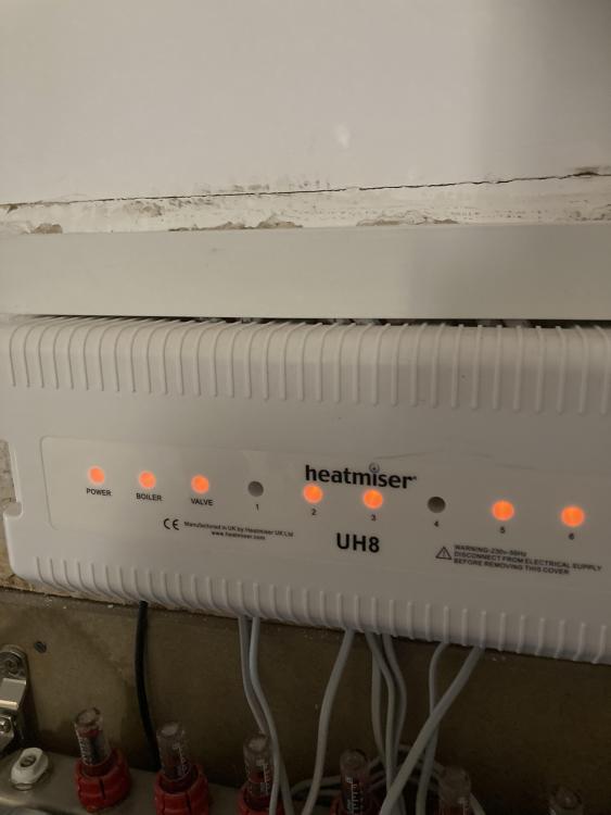

Over Christmas the controller for the UFH was switched off We didn’t notice Till we stopped using the wood burner
Most zones had dropped to 16
I switched the controller back on and the floors slowly started to heat up

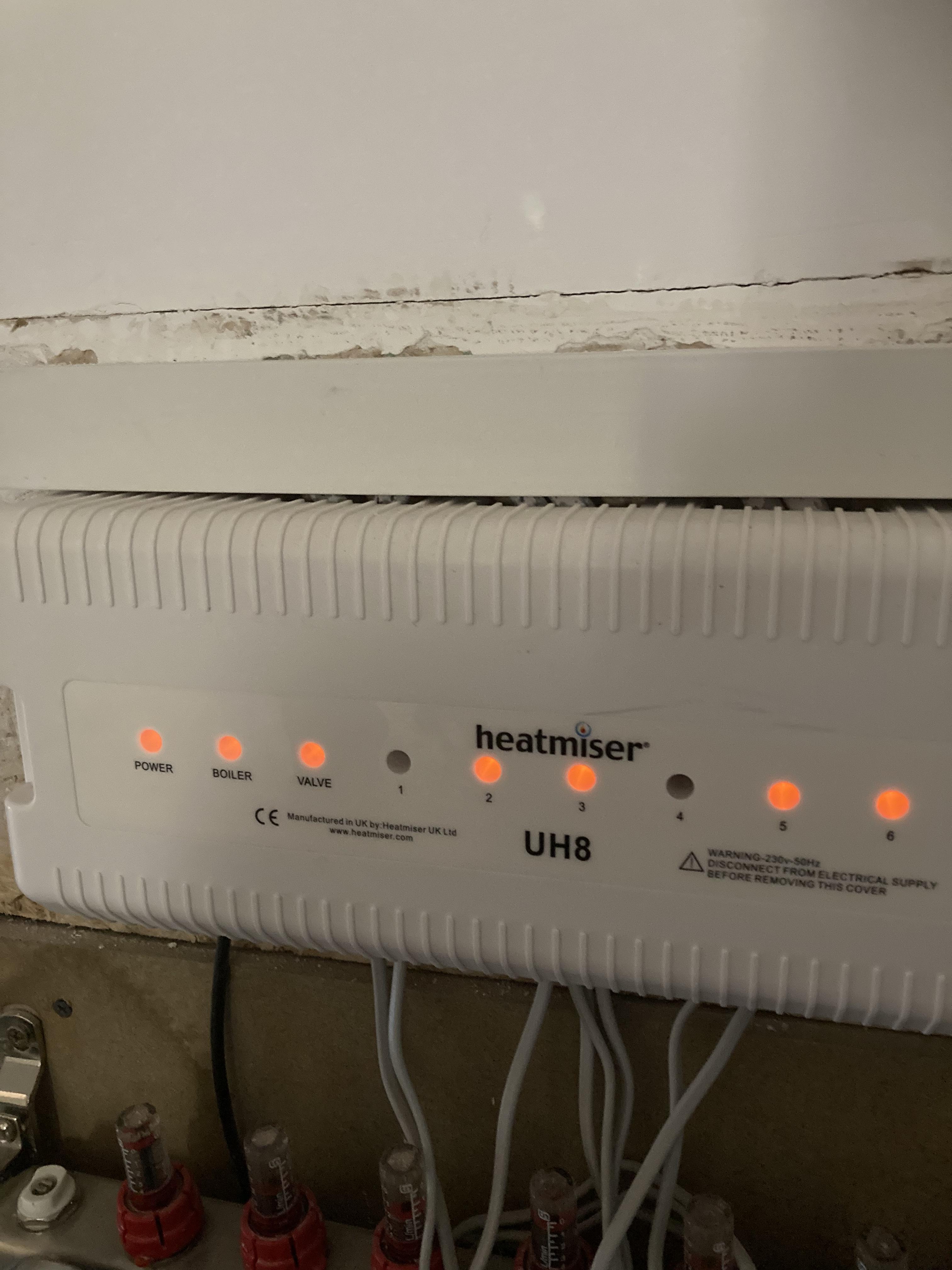

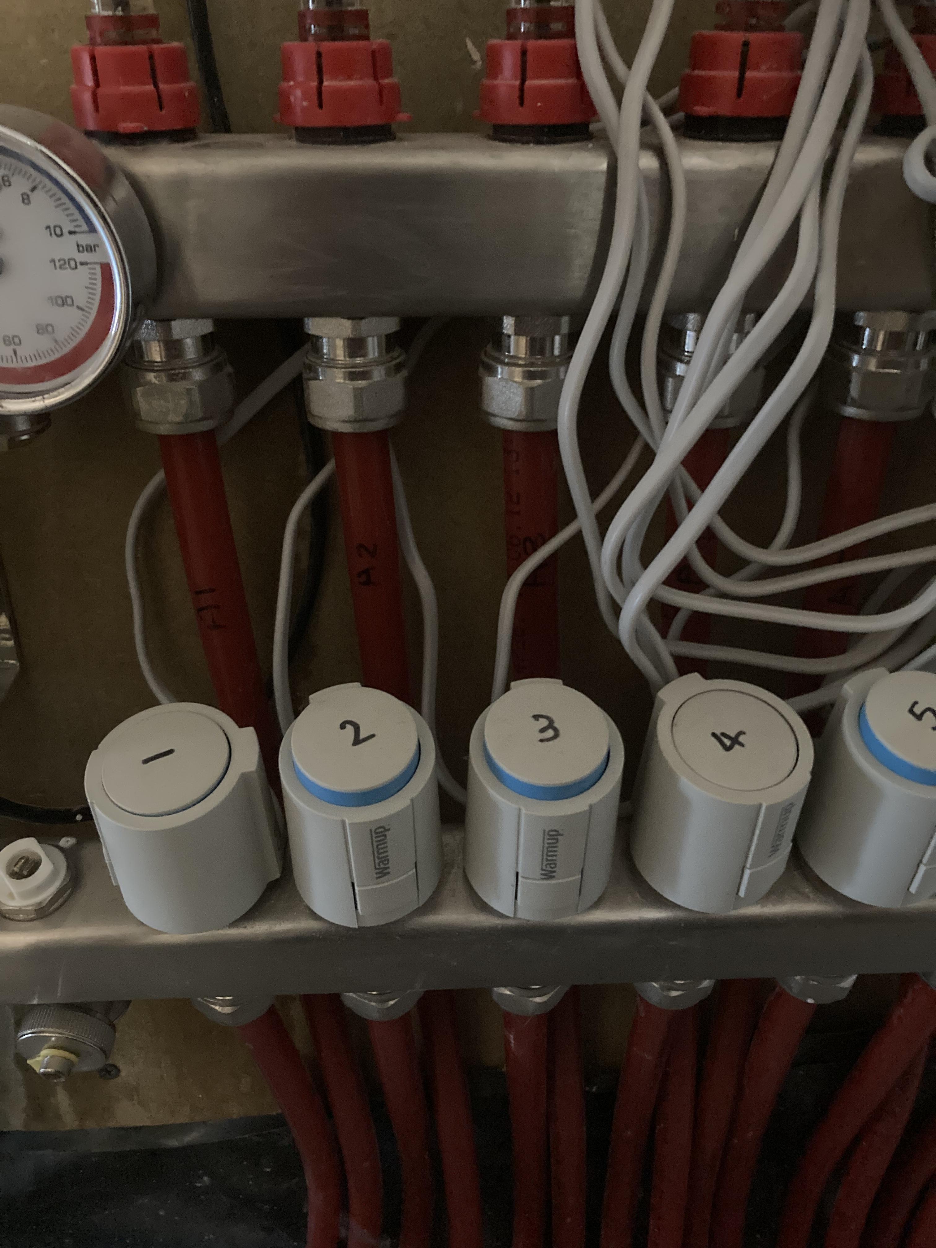

I’ve noticed today that while 1 & 4 are showing a flame on the stat
The actuators arnt lit ?
Any pointers would be appreciated

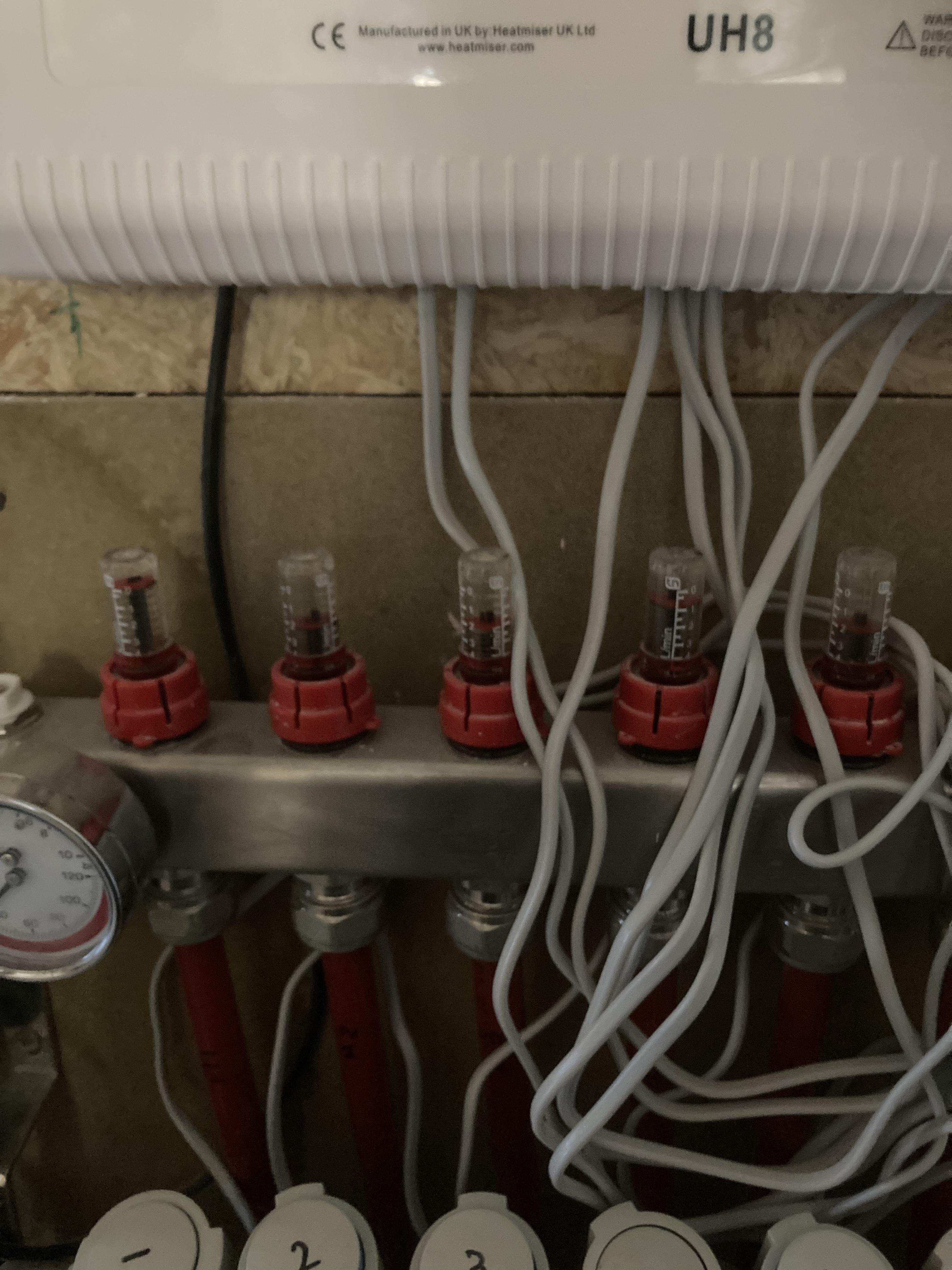

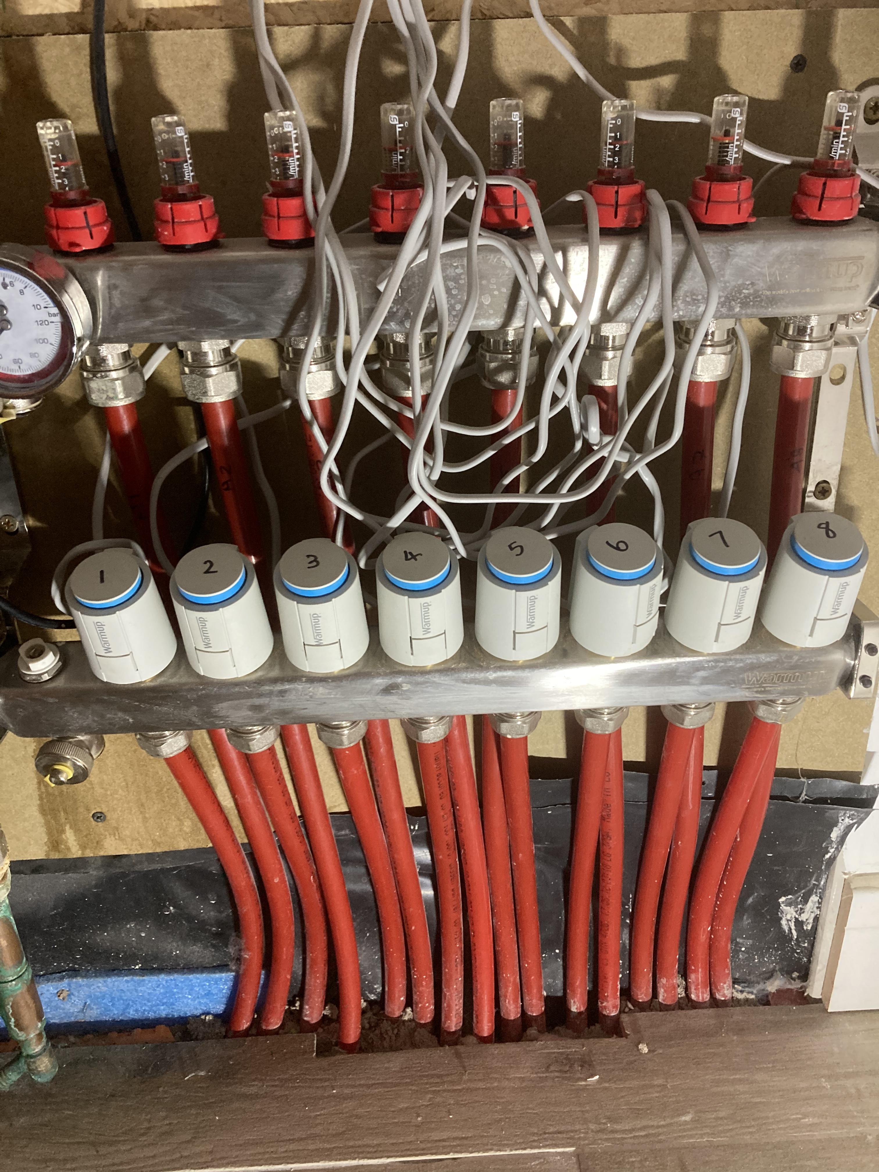

Just tried swapping two actuators
But no joy

Very difficult when someone posts a picture and asks What wrong with this
As you thought not a Plumbing issue
Swapped the stats and actuators
Nothing
Left the actuators off the two effected zones Slowly stated to get some heat in the pipes
Electrical then Put a tester on all the actuators The two effected had no power going out I took backplate off the two effected stats and found a live feed had snapped
