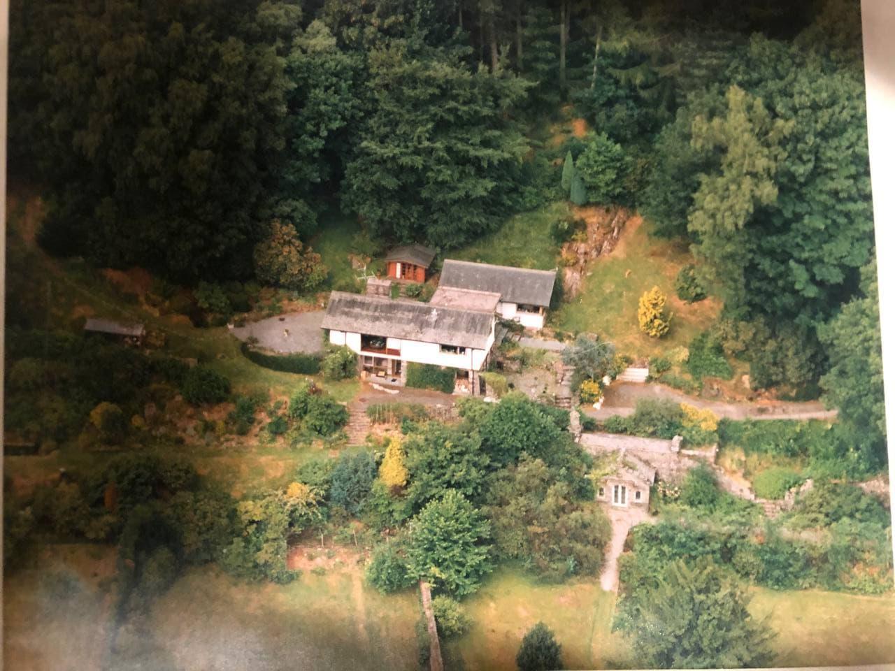

The house circa 1980, had a slate new roof since then. Note the little chapel, belonging to the house below indicates the height the driveway climbs at steeply.

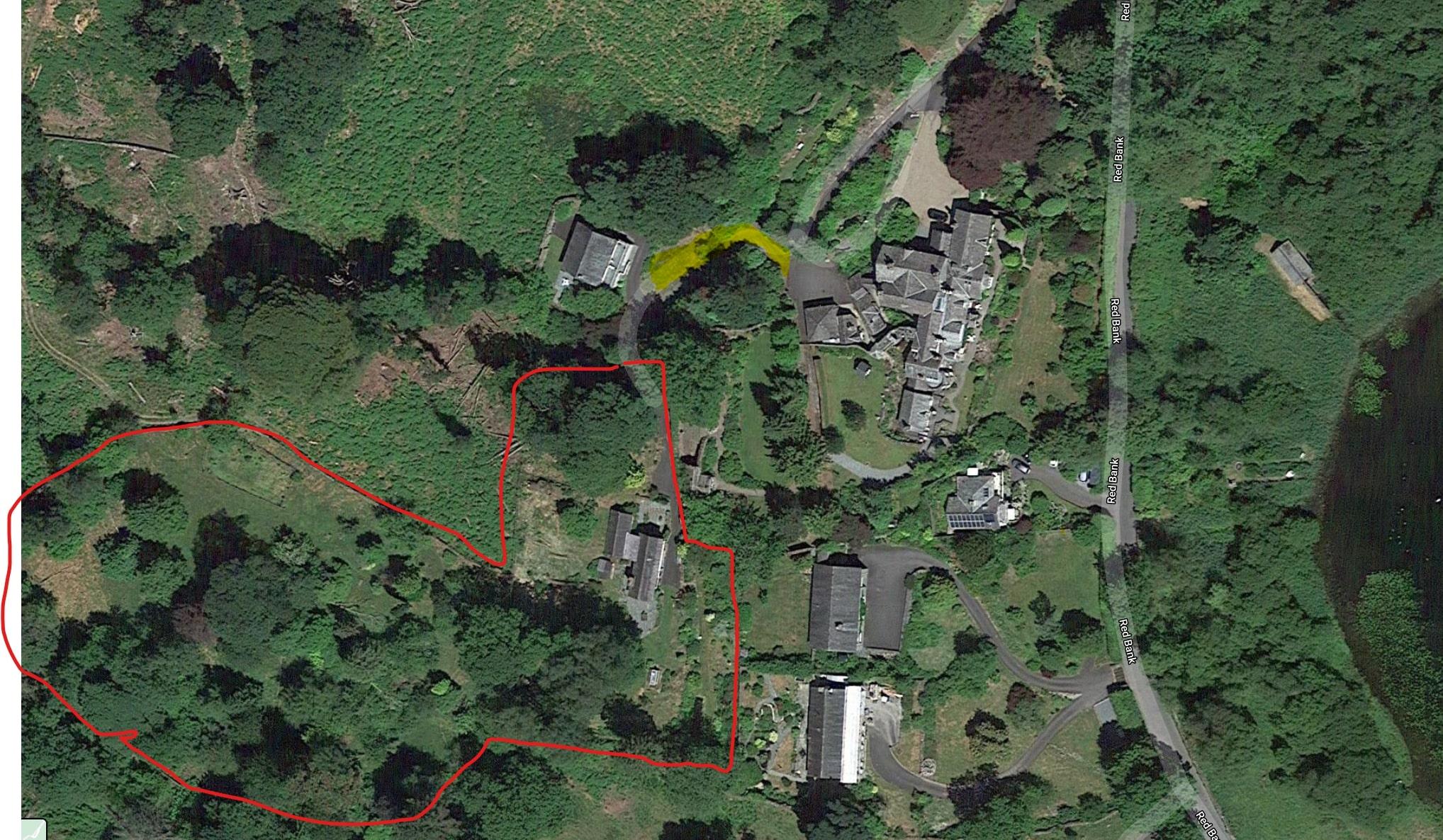

Aerial View of the Plot. Border in red and the difficult drive section highlighted in yellow.

Re the access issues, I would buy a 4WD probably a twin cab pickup and a decent trailer.  Then have a word with the house slightly down the lane that appears to have a large parking area to see if you can negotiate permission for deliveries to be offloaded there and you then shift them up the last bit with your truck and trailer?  Offer ££ for the privilege if necessary.

For a renovation your budget sounds realistic-generous to me at approx £1150 per sqm. Though groundworks etc and site improvements are missing.
Is there anything you can do to sort out that drive?
