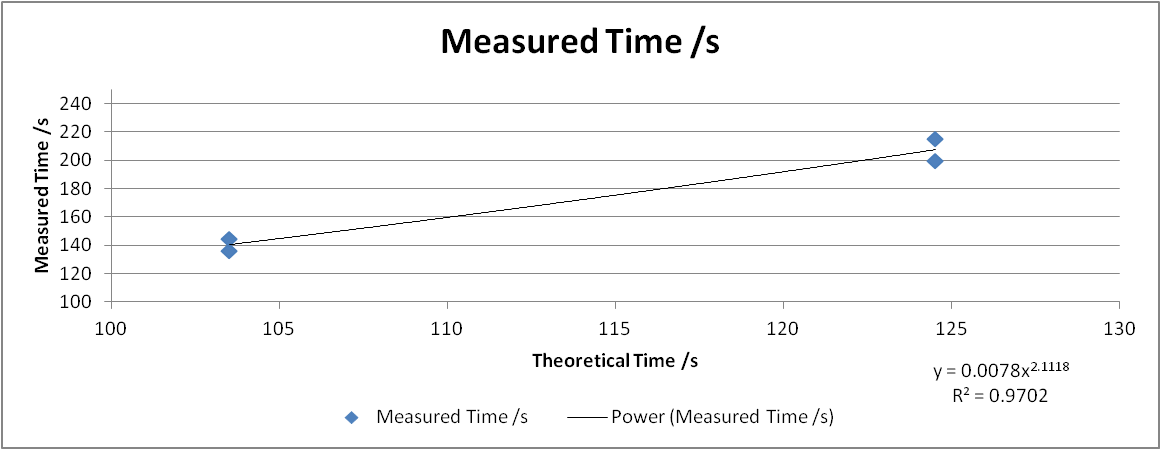

SteamyTea Posted January 3, 2022 Posted January 3, 2022 (edited) 38 minutes ago, Marvin said: I think there are too many variables for this to qualify as an answer to the question. Not so fast. Second set of results. I have reset my energy monitor as it was miss reporting for some reason, and now I have noticed that there is a 0.15 kW fan on when the hob is running. I also timed how long it would take to heat 500 g of water. Full Power: Small pan, small ring, 1.63kW, 3m 20s (200s) Full Power: Small pan, large ring, 1.93kW, 2m 16s (136s) Full Power: Large Pan, small ring, 1.63kW, 3m 35s (215s) Full Power, Large Pan, Large Ring, 1.93kW, 2m 25s (145s) To just boil 500 g of water should take 0.0511896 kWh (assuming incoming is at 12°C), this is 184,282 Ws. Multiplying the time taken by the power of the ring, in watts, but minus the 150 W for the cooling fan gives: Small Pan, Small Ring, 296,000 Ws, 60% more energy needed Small Pan, Large Ring, 242080 Ws, 30% more energy needed Large Pan, Small Ring, 382700 Ws, 73% more energy needed Large Pan, Large Ring, 258100 Ws, 40% more energy needed Some of that extra energy is needed to heat the pan and lid, and when the large pan was on the smaller ring, it only boils vigorously in the middle of the pan. So, to boil faster, and use less energy, match the pan to the ring, and the task. Don't boil peas in frying pan, try and use a smaller diameter pan if you can. There is not a huge difference between my rings, ~300W. Edited January 3, 2022 by SteamyTea

SteamyTea Posted January 3, 2022 Posted January 3, 2022 (edited) 1 hour ago, Marvin said: Watts It is Ws, for watt second, which is energy, not power. Why we should really use J, joule, for energy and not any other units. 1 hour ago, Marvin said: When the induction ring is fully energised, is the energy all used up producing and electromagnetic field, and therefore no more, or less, energy is used when heating the pan Assuming all things being equal in the pan materials, and allowing for different masses due to size, I will take a guess that there will be an optimum size of pan base for a particular induction coil. If the pan base is smaller than the coil, then some back electromotive force (BMF) may happen in the 'uncovered' portion of the coil, reducing efficiency. There may also be a reduction in power, but overall the efficiency will be less. To test this would mean going out and buying more pans, but others may like to give it a go with what they have, and then we can see what comes out of the data. A quick plot of this very limited data shows a power ratio (exponent has the same R2 value as well). So: Measured Value = 0.0078x2.1118 Where x is the theoretical value. Now what was the question. (We used to call these Silly Sunday Experiments) Edited January 3, 2022 by SteamyTea
