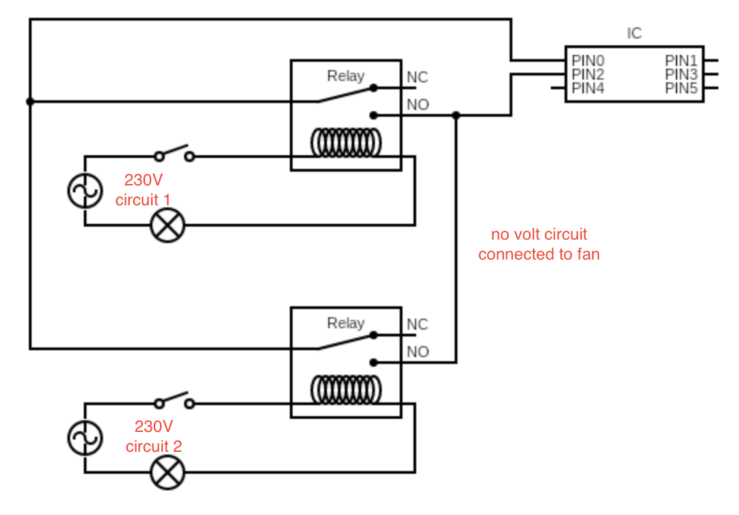

Bobbyboo Posted December 23, 2021 Share Posted December 23, 2021 My ventilation unit requires a no-voltage switch to trigger the boost function which should be triggered when two light switches are switched on. Unfortunately using a double pole (DTST) switch is not an option (would require changing a large number of switches), so I am trying to find another way of achieving the same thing. My idea would be using a relay: - 2x 230V light circuits each with a relay - relay switches the no-voltage circuit which is connected to the control unit of the fan Ie, when either light is switched on, a connection in the no-voltage circuit should be established, but no current should be transferred onto the no-voltage circuit. I plan on using 2 of these relays: https://docs.rs-online.com/5c2a/0900766b816d4f15.pdf (26.01 version) - would this work? Link to comment Share on other sites More sharing options...
Nickfromwales Posted December 23, 2021 Share Posted December 23, 2021 Hi. Yes, as long as the coils are 230VAC rated then you’re propel is sound. Just be sure to have good segregation of the cables at the relays, so you cannot ever get 230VAC going down the zero volt side. Link to comment Share on other sites More sharing options...
Radian Posted December 23, 2021 Share Posted December 23, 2021 Why have you shown the relay coils in series with the lights? Link to comment Share on other sites More sharing options...
Temp Posted December 23, 2021 Share Posted December 23, 2021 +1 Should be in parallel with the lights. Link to comment Share on other sites More sharing options...

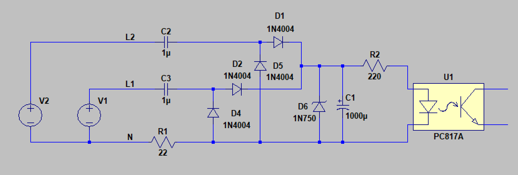

Radian Posted December 23, 2021 Share Posted December 23, 2021 (edited) If you wanted a much lower cost solid-state solution using an optocoupler you could knock up a circuit like this: C1 can be any low voltage electrolytic e.g. 6V, C2 & C3 need to be 400VAC types. R1 ought to be 1W, R2 1/4W and just about any sensitive opto should do if PC817A hard to find. D6 is a 4.7V 1/2W Zener. You would need to be confident in constructing a mains powered circuit - I only suggest this if you have the appropriate skills! ...And I'm assuming the volt-free input is low voltage control!!! Edited December 23, 2021 by Radian Link to comment Share on other sites More sharing options...
Bobbyboo Posted December 24, 2021 Author Share Posted December 24, 2021 9 hours ago, Radian said: If you wanted a much lower cost solid-state solution using an optocoupler you could knock up a circuit like this: Thanks! In my case, using relays will be fairly easy and hassle free. The cables are all already in place as they previously were connected to DGST switches, so it's a 10 minute job and all I need to do is add 2 relays, 20cm of cable and a junction box for under £20. 12 hours ago, Radian said: Why have you shown the relay coils in series with the lights? My mistake. They should be in parallel! Link to comment Share on other sites More sharing options...
Radian Posted December 24, 2021 Share Posted December 24, 2021 1 hour ago, Bobbyboo said: Thanks! In my case, using relays will be fairly easy and hassle free. The cables are all already in place as they previously were connected to DGST switches, so it's a 10 minute job and all I need to do is add 2 relays, 20cm of cable and a junction box for under £20. No worries. Because you were buying from RS I guessed you might be up for doing a bit of electronics ? Link to comment Share on other sites More sharing options...
